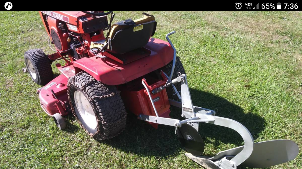

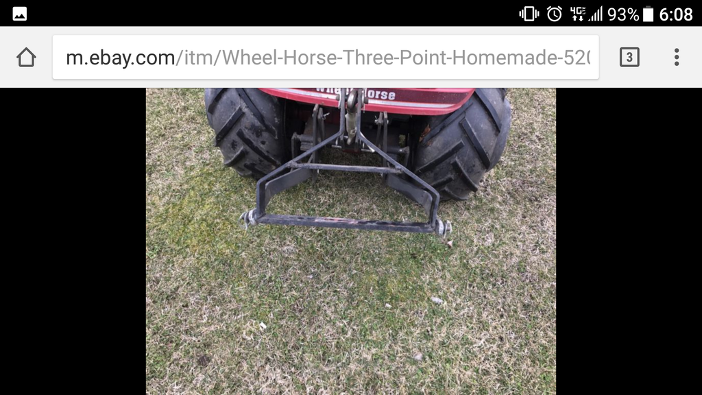

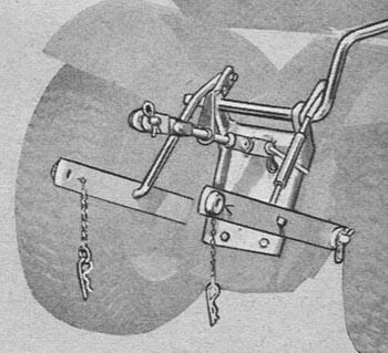

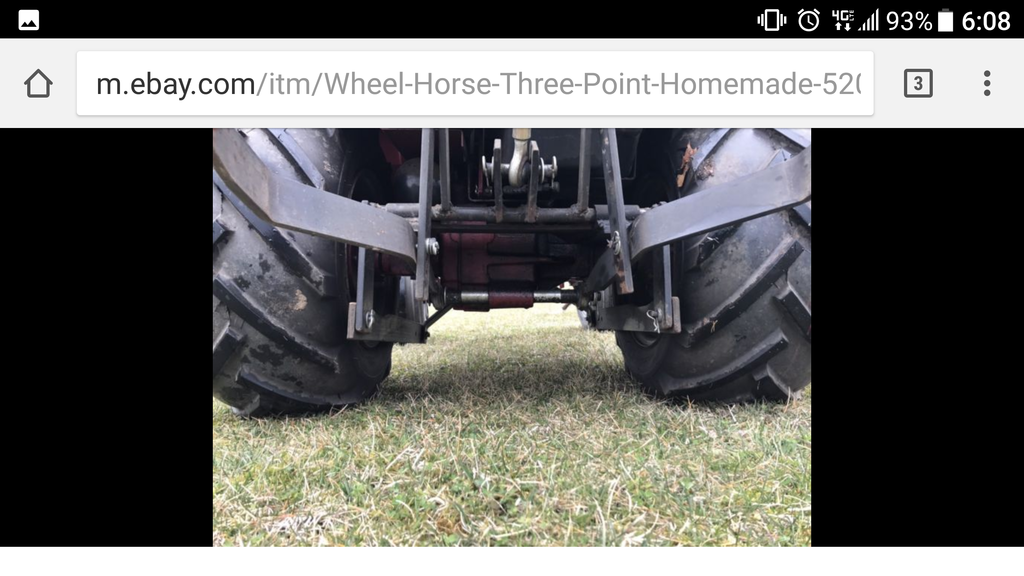

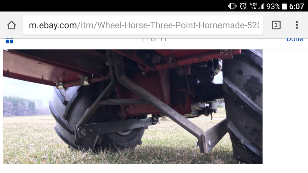

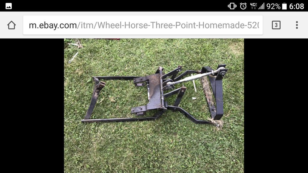

WVHillbilly520H 10,378 #6 Posted December 21, 2017 Here's a few pics I've gleaned from the 'net (eBay and CL)...be inspired, @jellyghost first 2 a Sears 3pt on a @Rozlo the rest a home brew 3pt on a 520, Jeff. 2 2 Share this post Link to post Share on other sites
