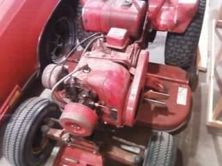

bunson70 51 #1 Posted December 19, 2017 I would like to replace the muffler on my 1968 Kohler 8 hp engine. It is about 3/4" water pipe. Then, the muffler itself is about a five inch diameter. I am guessing that it is the original muffler. Any suggestions on a replacement? I would like to have it as quiet as possible. The old one is really rusty. I going to have to get some penetrating oil and a couple of pipe wrenches to get it off. Thank you. P.S. I really like the Christmas lights at the top of the page!! 🌲 🎅 1 1 Share this post Link to post Share on other sites
