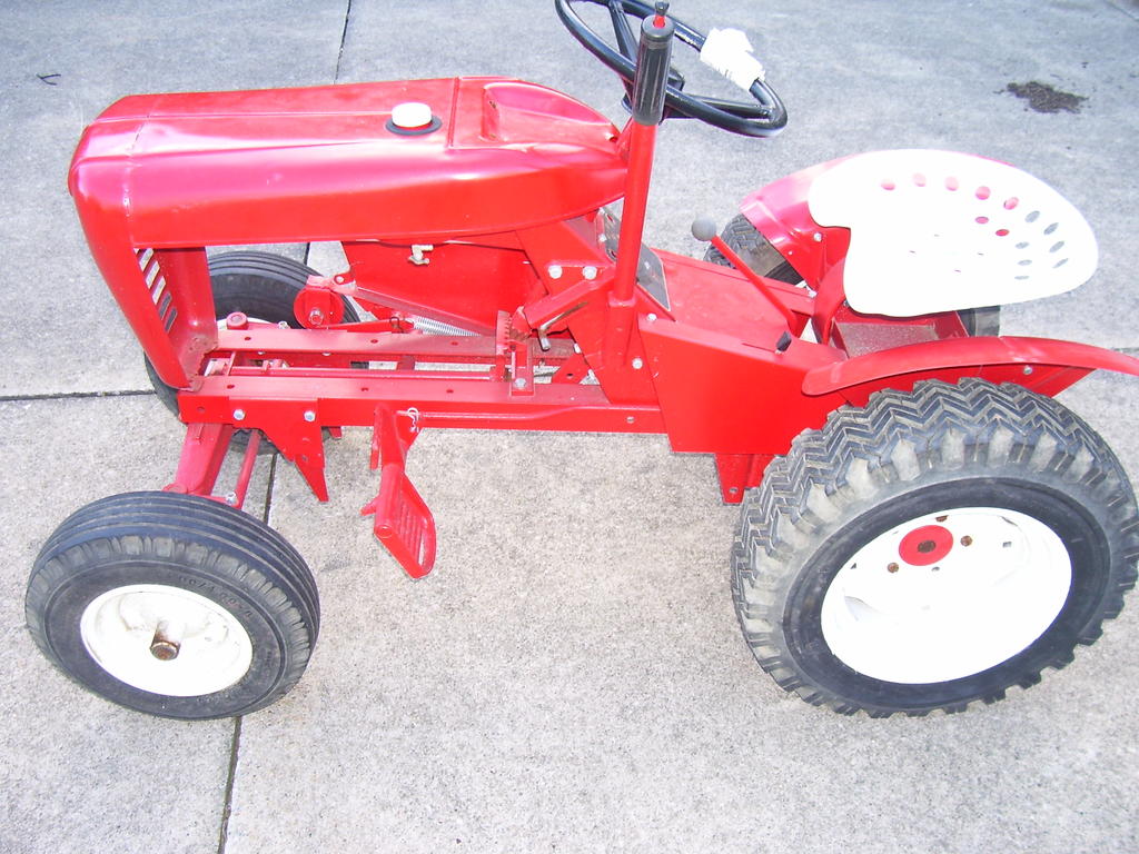

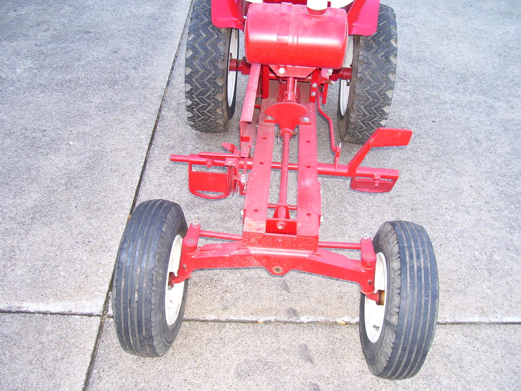

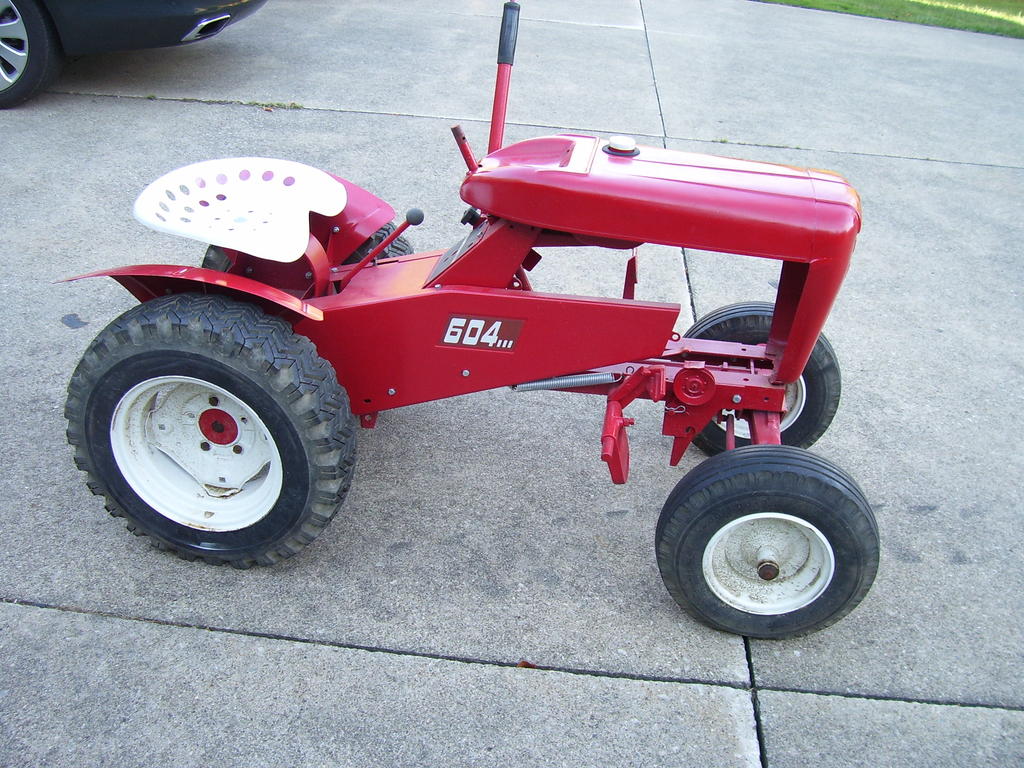

Tgtack 779 #8 Posted December 19, 2017 22 hours ago, 953 nut said: 854 had a Kohler, take a look at the manual and compare it to yours. May be able to swap out the hood and tank or relocate the tank. I have a 754, it and the 854 used the longer hood and the aluminum gas tank. The 604/654 used a shorter all metal hood with the gas tank under the hood with the fill neck protruding through the hood. I don't want to physically modify the look of it, would just like a little more HP for mowing. I have a 7HP Tecumseh that would likely fit (intended for the 754), also have a Kohler 161T manual start that I was going to put on it till I noticed it has the hole for the ignition switch on the original hood stand plate. Bought it thinking it was a 604 but in reality is a 654. Someone started a restore on it mid 90's, never finished and put 604 decals on the belt guard. Here are some pictures of it, the steering wheel is a new part that had been purchased back in mid 90's, still has Toro parts tag on it. Is pretty clean, color is a little off and hood needs some attention from bugger welding underneath. 1 Share this post Link to post Share on other sites
