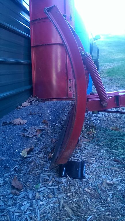

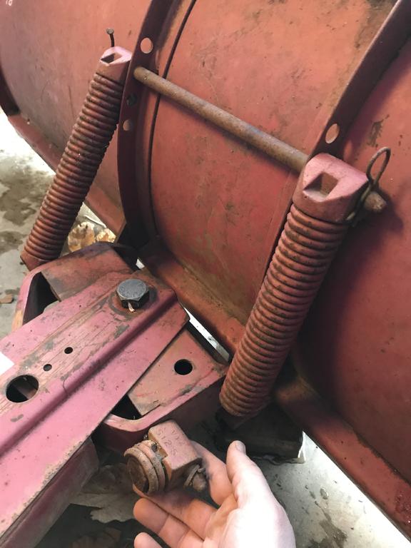

WHnoob 21 #1 Posted December 15, 2017 This fall I picked up a 48" dozer/snow blade (looks like model #79350) from a seller on CL. Unfortunately at time of purchase I didn't notice one of the tip springs is broken, and it is missing the angle adjustment linkage rod and lift rod (already ordered a solid long lift rod from WheelHorseMan). I got it installed on my C-160 yesterday and it did fine in 1" of snow with just the one spring, but I'm worried it will tip too easily when the snow gets deeper (or that one will break too!). Replacement springs on eBay seem to run $70+, or almost half the price of a complete blade setup. Is there a cheaper replacement spring available that can be installed on the existing end brackets? Also I plan to fabricate the missing angle adjustment linkage. Is it better to use 3/8" or 1/2" steel rod? Share this post Link to post Share on other sites

WVHillbilly520H 10,376 #4 Posted December 15, 2017 Those springs screw into the rod ends, if it only broke off at the bottom of the rod ends like one I had last year for an xi series, I just used an angle grinder and cut them down till they were even and screwed them back onto the rod ends, you may have to drop down a hole or 2 where the top rod runs through the blade moldboard but it will still "trip" as it should, also a set of skid shoes will help keep the cutting edge from wearing out, Jeff. 4 Share this post Link to post Share on other sites
WHnoob 21 #5 Posted December 18, 2017 Thanks! It did break right at the bottom bracket, so it did cross my mind to just screw the (now shorter) spring back onto the bracket. I'd rather not cut the good spring to match though. Looks like I have a "hairpin" or two to replace as well! Share this post Link to post Share on other sites
WVHillbilly520H 10,376 #6 Posted December 19, 2017 2 coils probably won't matter much but the one I had broke 4+ on side so I made them even, if you have a bench vise pinch the rod bracket soak the "thread" and spring with your favorite penatrant and use a pair of channel lock pliers to remove the remanant spring, you may have to grind the new bottom of the long portion to get it screw back together, good luck, Jeff. Share this post Link to post Share on other sites

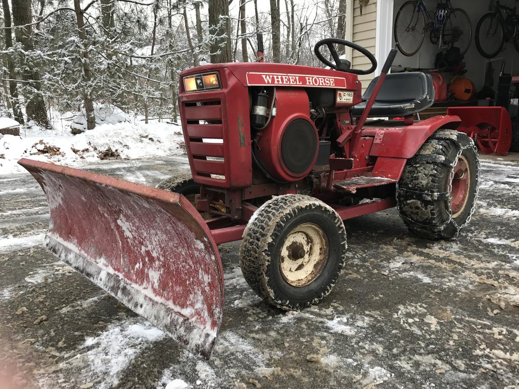

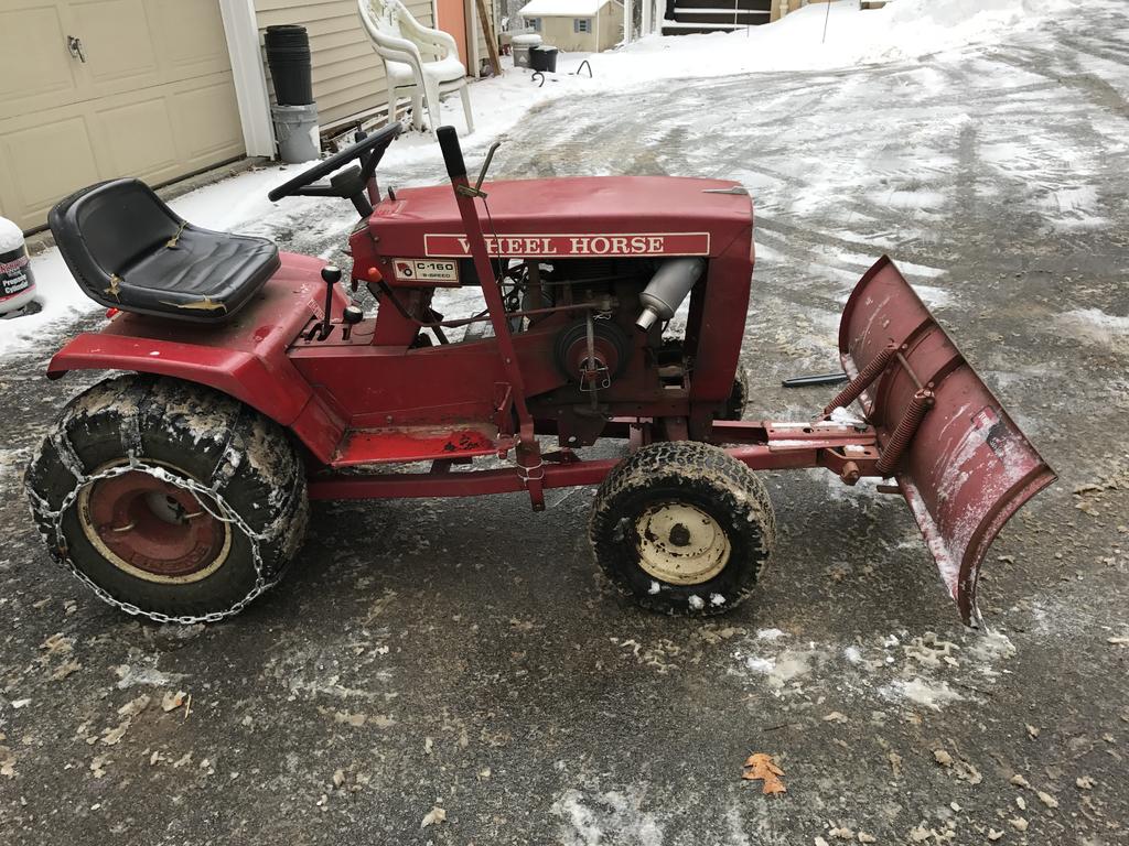

WHnoob 21 #9 Posted January 5, 2018 I received a replacement spring via my want ad, though I haven't installed it yet. Figured you'd like some pictures since I got the proper solid lift installed - what a difference! With the lift chain connected to the plow it wouldn't lift high enough to latch it up, so I had to constantly hold it when backing up. Also zip-tied the angle lever to keep it from flopping into the PTP and brake pedal until I can fab up the angle linkage rod. Of course we've only gotten a couple 1-2" storms since then. Most of yesterday's was further east. 1 Share this post Link to post Share on other sites
