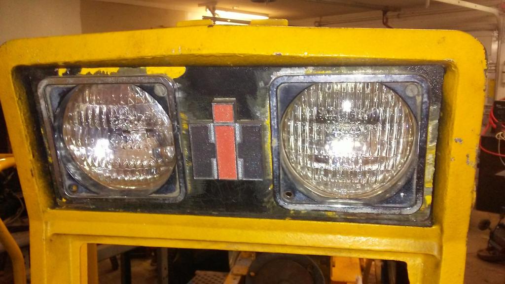

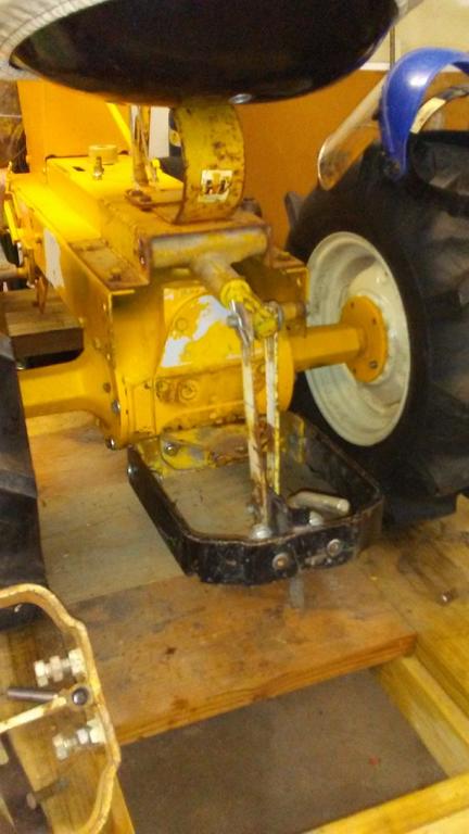

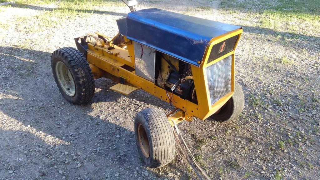

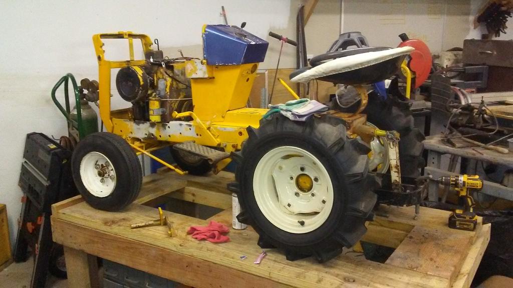

RandyLittrell 3,944 #1 Posted December 13, 2017 Started working in a 73 Cub I picked up this summer. Of course it is supposed to run, they always do, right? LOL! Well, I have a good motor out my stock puller that will make a good runner. I only give $75 buck for this tractor and want to spend as little as possible, sooooo, I will use what I have to put it together and make a good plowing tractor out of it. Here are some pics. Someone was going to make a puller out of it. Ok, here are some current pics. I have it in the shop, up on my workbench. I have the hood at my work straightening it out a bit and will put some paint on it. I will probably rattle can rest of it for now. I need a worker and don't want to spend any money. I am putting some headlights out of 149 in it that I had laying around. Also dug into the parts bin and put a lift on it and brinley hitch. 3 6 Share this post Link to post Share on other sites
