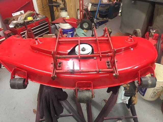

Searcher60 209 #1 Posted December 12, 2017 I have an old 42” side discharge deck with the keyway spindle shafts, and the one piece rounded belt cover. ID tag is long gone. Anybody know how to ID this deck, or at least the spindle assembly part numbers? Thanks in advance, Share this post Link to post Share on other sites
953 nut 66,384 #2 Posted December 12, 2017 This isn't the exact same deck (it is for a vertical shaft 200 series) but spindles are probably the same. Check out this one too. Share this post Link to post Share on other sites
gwest_ca-(File Mod) 12,259 #3 Posted December 12, 2017 Don't know much about decks but it appears that one-piece cover was first used on the 5-1010 deck. Here is a list of the decks in the order they were produced 5-1001 replaces RL-426, 5-1421, 5-1422, 5-1423, 5-1000 5-1001 replaced by 5-1010, 5-1011, 5-1012, 65-42MS01, 65-42MS02, 75-42MS01 (Blades up to this point had a 5/8" x 3/4" double-D center hole) (The following decks used blades with a 3/4" center hole) 75-42MS02, 85-42MS01, 95-42MS00, 95-42MS01, 05-42MS01, 05-42MS02, 05-42MS03, 05-42MS04, 05-42MS05, 15-42SC01, 15-42SC02, 15-42SC03/78345 & 85551 front hitch Click on the fuzzy picture below and download the file from there. When the page opens you can see screen shots of the spindle assemblies. Click on one to enlarge. Garry Adding The one-piece cover 6770 was replaced by 106081 and shows as being used up to and including 1979 but complete coverage is not always complete in the on-line info. Share this post Link to post Share on other sites
Searcher60 209 #4 Posted December 12, 2017 9 hours ago, 953 nut said: This isn't the exact same deck (it is for a vertical shaft 200 series) but spindles are probably the same. Check out this one too. It’s appears to be the O5-42MS02. Thanks a bunch! 1 Share this post Link to post Share on other sites
