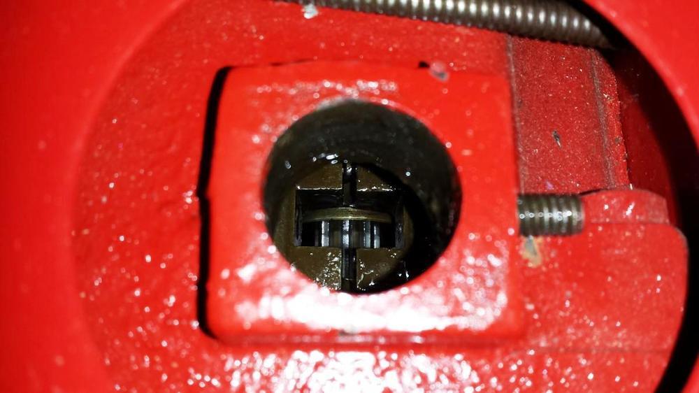

953 nut 68,778 #2 Posted December 10, 2017 Sounds like the shift forks have it in two gears at once. Do the following steps and it should be fixed. If your shift lever comes out of the transmission or is stuck in one gear first back out the “Dog-point” screw that retained the shifter. Take a look in the hole the shifter came out of to be sure it is in neutral as shown above. Inspect the dog-point to be sure it is in good condition and back off on the locking nut a couple of turns. Insert the shifter and run the dog-point into the dimple in the shift lever collar snugging it up with an allen wrench, don’t tighten it. Be sure the shifter works smoothly then tighten the lock nut while holding the dog-point steady with the allen wrench. 5 Share this post Link to post Share on other sites
NJhorses 12 #3 Posted December 10, 2017 Thank you kind of thought that might be it. have to wait a couple days till i get back from a trip Tuesday . Didnt know about the Dog Point sxrew. 1 Share this post Link to post Share on other sites
