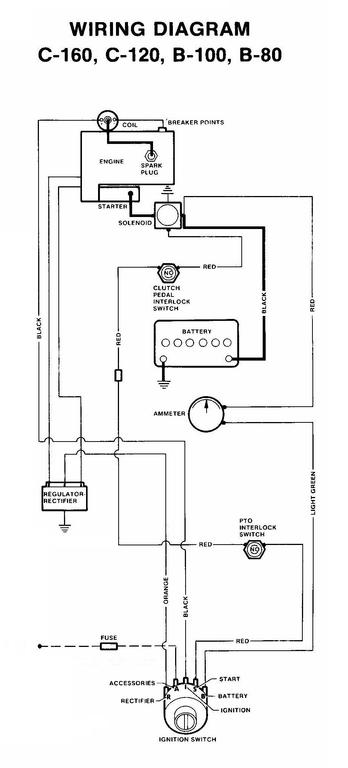

rmaynard 16,843 #3 Posted December 4, 2017 (edited) I have two 1977 B-100's, and had a 1976 B-100. All three had exactly the same wiring. The wiring diagram below was shared by all three. However, in 1976, there were 4 variations in the B-100; 61-10K801, 802, 803, and 804. Wiring could have been slightly different in one or the other. Let us know which model you have. Edited December 5, 2017 by rmaynard 3 Share this post Link to post Share on other sites
953 nut 63,986 #4 Posted December 4, 2017 Some owners seem to have no respect for proper wiring, Probably best to start from scratch, attached is a basic wiring diagram you can use as a guide. The safety switches are not in this drawing but are very important and should be included. 4 Share this post Link to post Share on other sites

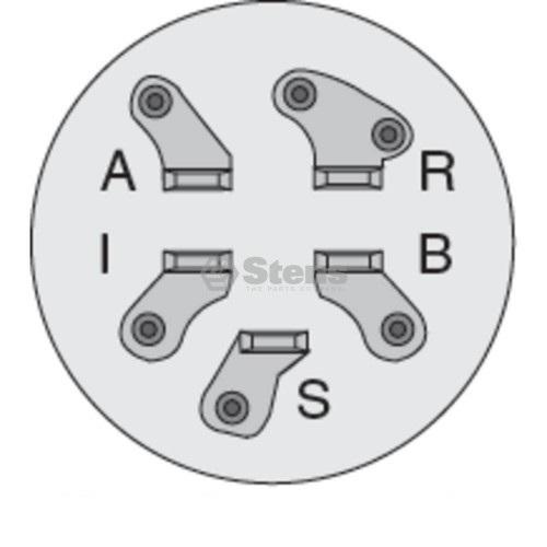

rmaynard 16,843 #8 Posted December 5, 2017 That diagram should help you, but I think that you have the wrong ignition switch. Should be a 103990. You should have power to the solenoid coil in the start position only. You should have power to the ignition coil in the start and run positions. Back of switch should look like this: 5 1 Share this post Link to post Share on other sites
ebinmaine 77,101 #9 Posted December 5, 2017 6 hours ago, rmaynard said: That diagram should help you, but I think that you have the wrong ignition switch. Should be a 103990. You should have power to the solenoid coil in the start position only. You should have power to the ignition coil in the start and run positions. Back of switch should look like this: Check to see if yours has an M at a terminal. .... Mine did. Some folks put in later switches, not taking the time to find the correct one. 2 Share this post Link to post Share on other sites

953 nut 63,986 #19 Posted July 4, 2022 Here is another color coded drawing done by @BOB ELLISON that may be helpful. As Eric said, bypass the amp meter until everything else is working properly. A 30 Amp fuse on the GREEN wire would be a good safety feature. 1 2 Share this post Link to post Share on other sites
ebinmaine 77,101 #20 Posted July 4, 2022 @953 nut Excellent Richard. Thank you for posting that. @davem1111 This is the schematic diagram I use for wiring my tractors. 3 Share this post Link to post Share on other sites
