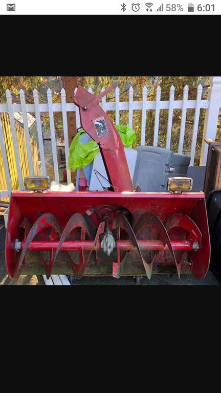

bc.gold 3,406 #26 Posted January 8, 2019 (edited) Look like your brass crown gear on that snow blower is an economical replacement compared to the Kubota blower that I had at $1600.00 for a replacment, your gear is keyed to the shaft while the one I had was formed onto the hub as an integral part. Powdered metallurgy makes it impossible to just replace the gear when it becomes part of the shaft. Double meaning. What brand is your snow blower, thanks. Edited January 8, 2019 by bcgold Share this post Link to post Share on other sites

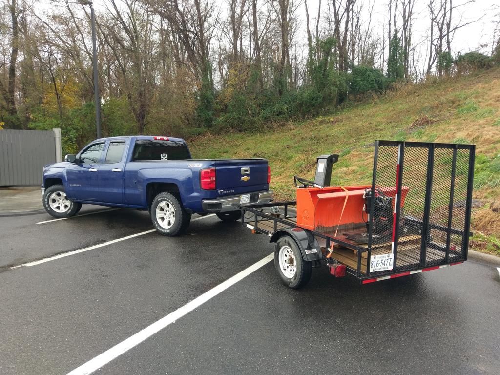

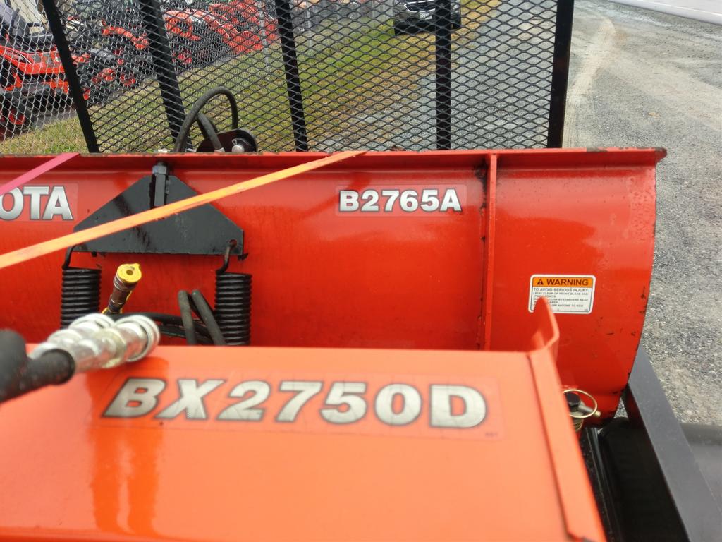

WVHillbilly520H 10,379 #27 Posted January 8, 2019 1 hour ago, bcgold said: Powdered metallurgy makes it impossible to just replace the gear when it becomes part of the shaft. Double meaning. What brand is your snow blower, thanks. These 2stage blowers are TORO brand, they use the same Peerless gearboxes used on smaller self propelled units, the parts kit is still more than most of us have paid for the blower itself though not $1600 OUCH,...which Kubota unit did that come out of as I just purchased a like new low hour 50" unit (BX2750D as well as 60" plow) to retrofit to my Mahindra eMax, Jeff. Share this post Link to post Share on other sites
WVHillbilly520H 10,379 #28 Posted January 8, 2019 (edited) 8 hours ago, Kurt-NEPA said: I didn't use the end bolts. Jim, I used cap screws just to keep everything aligned while I drilled the new holes for the 3 bolt flanges, then with a bit if RVT I threaded some "set screws" in the end of the auger shaft just to keep the threads viable if by chance I went back to bone stock original. Edited January 8, 2019 by WVHillbilly520H 2 Share this post Link to post Share on other sites

bc.gold 3,406 #31 Posted January 8, 2019 6 hours ago, WVHillbilly520H said: These 2stage blowers are TORO brand, they use the same Peerless gearboxes used on smaller self propelled units, the parts kit is still more than most of us have paid for the blower itself though not $1600 OUCH,...which Kubota unit did that come out of as I just purchased a like new low hour 50" unit (BX2750D as well as 60" plow) to retrofit to my Mahindra eMax, Jeff. Dont remeber the model, it was a front mount that came off a 4x4 Kubota tractor that the owner sold. I converted it to a three point hitch for my Grey Market Kubota. From the parts diagram it looks like someone in engineering got a wake up call. https://www.google.com/url?sa=t&rct=j&q=&esrc=s&source=web&cd=1&ved=2ahUKEwiUhqy-x97fAhUn7IMKHbLaAFQQFjAAegQIChAC&url=http%3A%2F%2Fwww.kubotabooks.com%2FAutoIndex%2Findex.php%3Fdir%3DSnowblowers%2F%26file%3DBX2750D%20OWNERS%20MANUAL.pdf&usg=AOvVaw0ljxJAuE6dFWb6WYD4Ya0V 1 Share this post Link to post Share on other sites

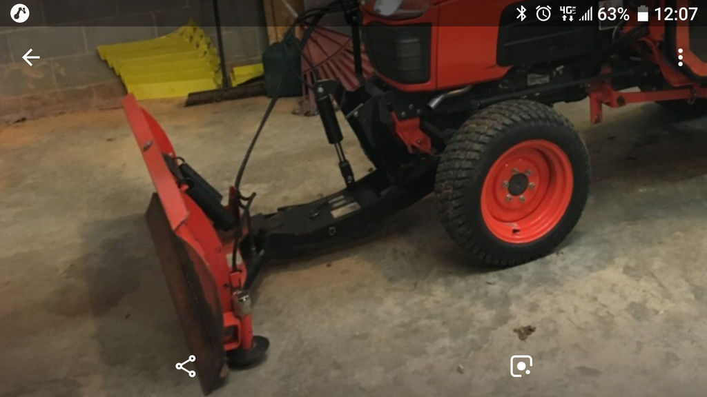

WVHillbilly520H 10,379 #32 Posted January 8, 2019 42 minutes ago, bcgold said: Dont remeber the model, it was a front mount that came off a 4x4 Kubota tractor that the owner sold. I converted it to a three point hitch for my Grey Market Kubota. From the parts diagram it looks like someone in engineering got a wake up call. https://www.google.com/url?sa=t&rct=j&q=&esrc=s&source=web&cd=1&ved=2ahUKEwiUhqy-x97fAhUn7IMKHbLaAFQQFjAAegQIChAC&url=http%3A%2F%2Fwww.kubotabooks.com%2FAutoIndex%2Findex.php%3Fdir%3DSnowblowers%2F%26file%3DBX2750D%20OWNERS%20MANUAL.pdf&usg=AOvVaw0ljxJAuE6dFWb6WYD4Ya0V Thanks for the files, and I intend for this to be a front mount on the same quick hitch/subframe as the snow/dozer blade just like the B3200 it came off of... Share this post Link to post Share on other sites
