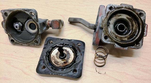

Rustyred 63 #1 Posted December 3, 2017 Hi folks, our work continues rebuilding our 1979 C-81. We are currently reassembling our 8 HP Kohler engine. We just popped apart the aluminium fuel pump and found it to be in bad shape. We could clean it up but the diaphragm looks very worn out. So my question: Should I fix up this original fuel pump? (Is it even possible to find parts?) Or do I replace it with a plastic one? We are trying to restore whatever we can to keep it as original as possible but we need it to work well! Thanks for the advice! Rustyred Share this post Link to post Share on other sites

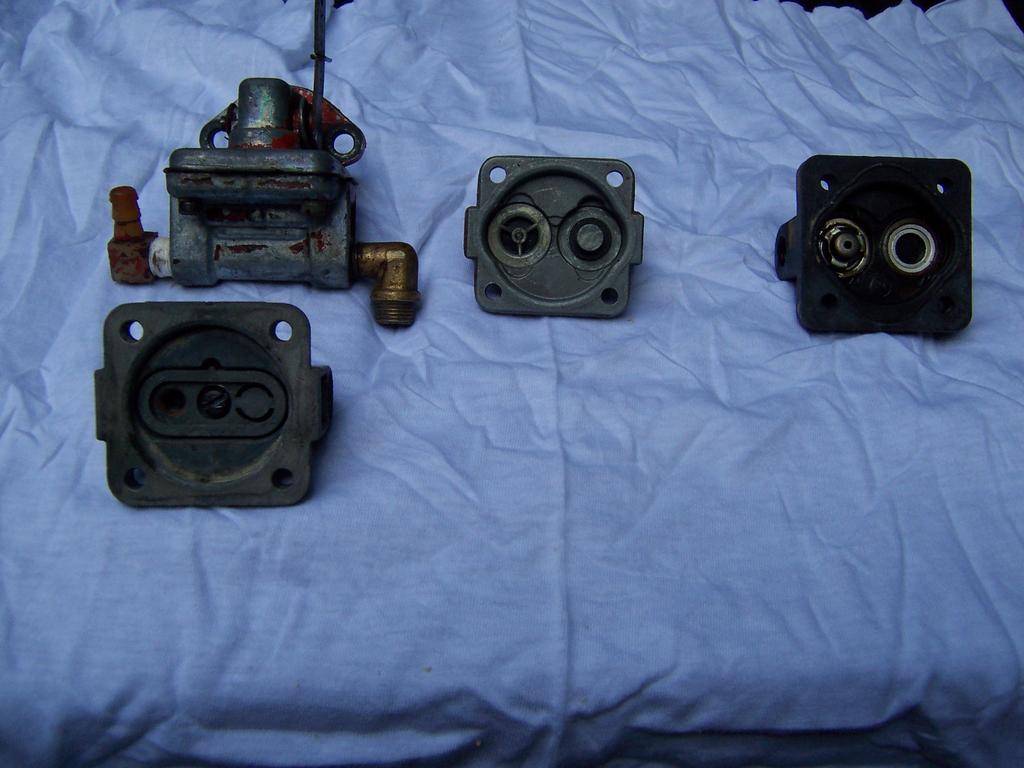

953 nut 65,199 #7 Posted December 3, 2017 3 hours ago, wallfish said: If the pump is the type that DOESN'T use those little pod type check valves and it just has the small discs and springs, you can just clean everything and flip the discs over. The most difficult thing is not loosing the little springs. The one John is talking about was prior to '66 if I am not mistaken. It would be like the one on the left with the priming lever. Yours is likely to be like the one in the center. The one on the right is a plastic one. Share this post Link to post Share on other sites
Rustyred 63 #8 Posted December 6, 2017 Thanks for the input folks. I'll check out the suggested website and try to choose the right kit to rebuild the original. I am including a picture of the pump itself in case it would change anyone's advice but I think it adds up. Thanks again, Rustyred Share this post Link to post Share on other sites
953 nut 65,199 #9 Posted December 7, 2017 Looks like it will clean up nicely. 1 Share this post Link to post Share on other sites
