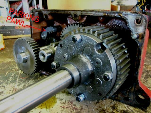

daveoman1966 3,882 #5 Posted December 2, 2017 here is the 'parking brake' (parking pawl') and it is inside the trans case. When you pull UP on the engagement lever, this pawl engages a gear that STOPS all motion in the gears...preventing the tractor from moving at all. Howver, DO NOT EVER pull up the engagement lever when the tractor is in motion. You will destroy internal gears and...whats worse... chip off fragments that get into the hyro pump that runis brass internal parts....whjich leads to loss of power. 1 Share this post Link to post Share on other sites

Logan 6 #7 Posted December 2, 2017 Thanks for all the help. Mine does roll when the lever is pulled up. So i belive it is worn out or broken off. I havent run it more than about four hours. It is in pieces and the engine was machined, i havent put it back together yet. I may look into the transmission housing and see what’s up. Once again, thanks for all the help from everyone. 1 Share this post Link to post Share on other sites

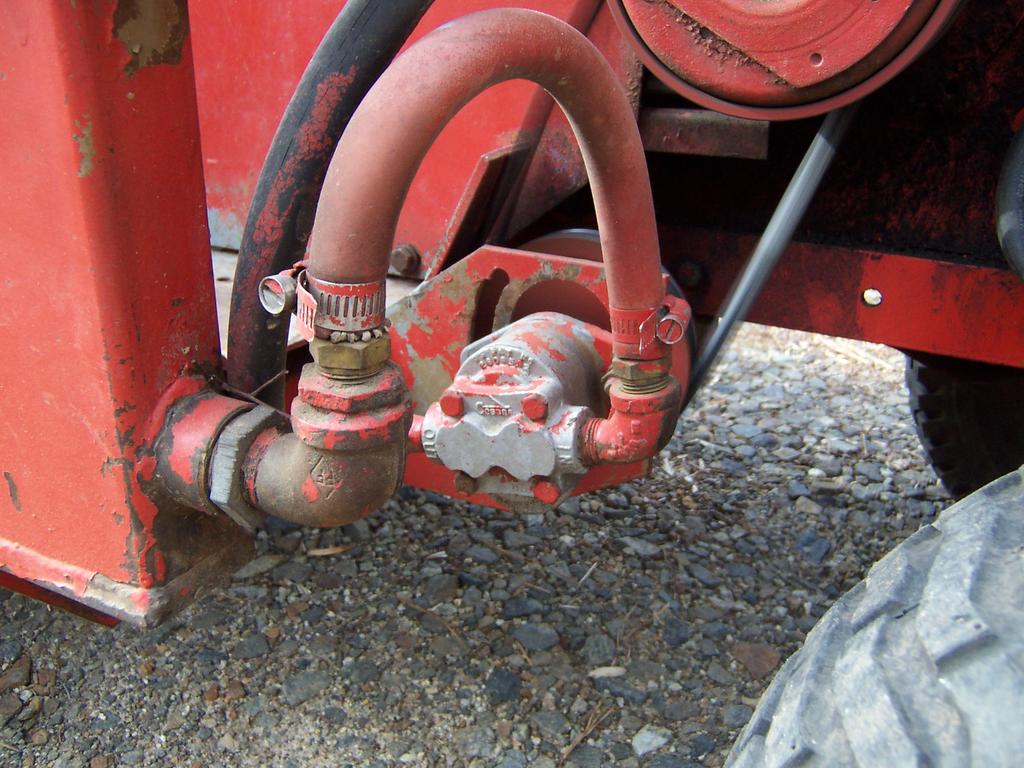

953 nut 64,155 #12 Posted December 6, 2017 I have an electric clutch driving the hydraulic pump on my loader. Flip the switch and id locks up, draws about 10 amps. Share this post Link to post Share on other sites
