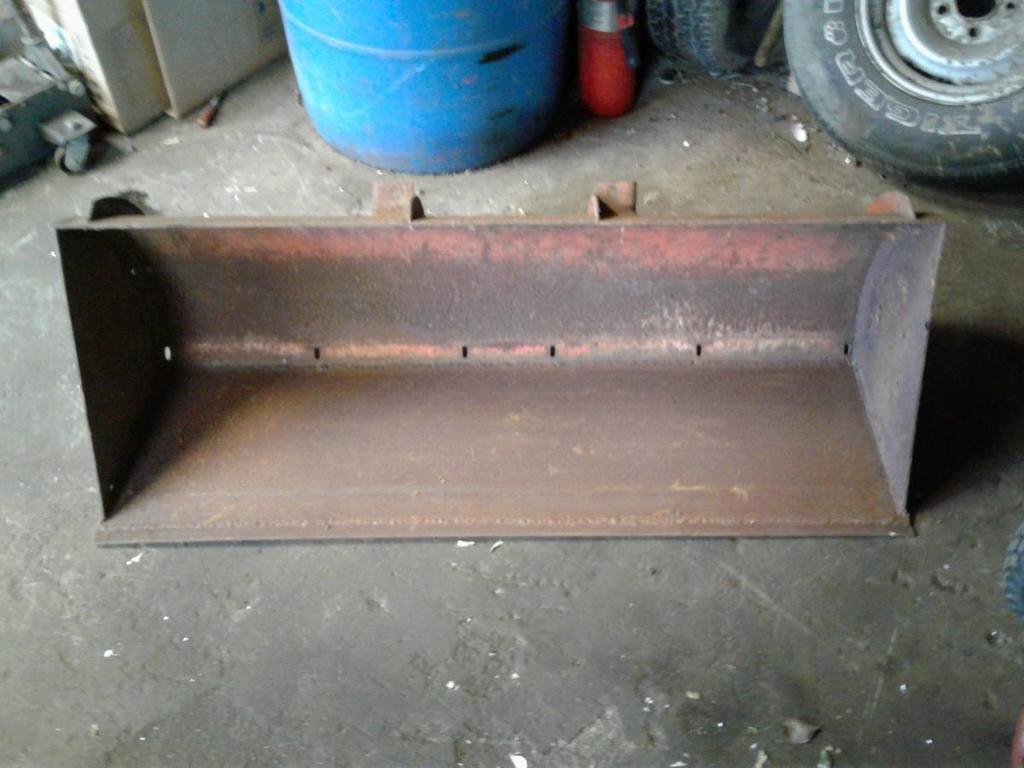

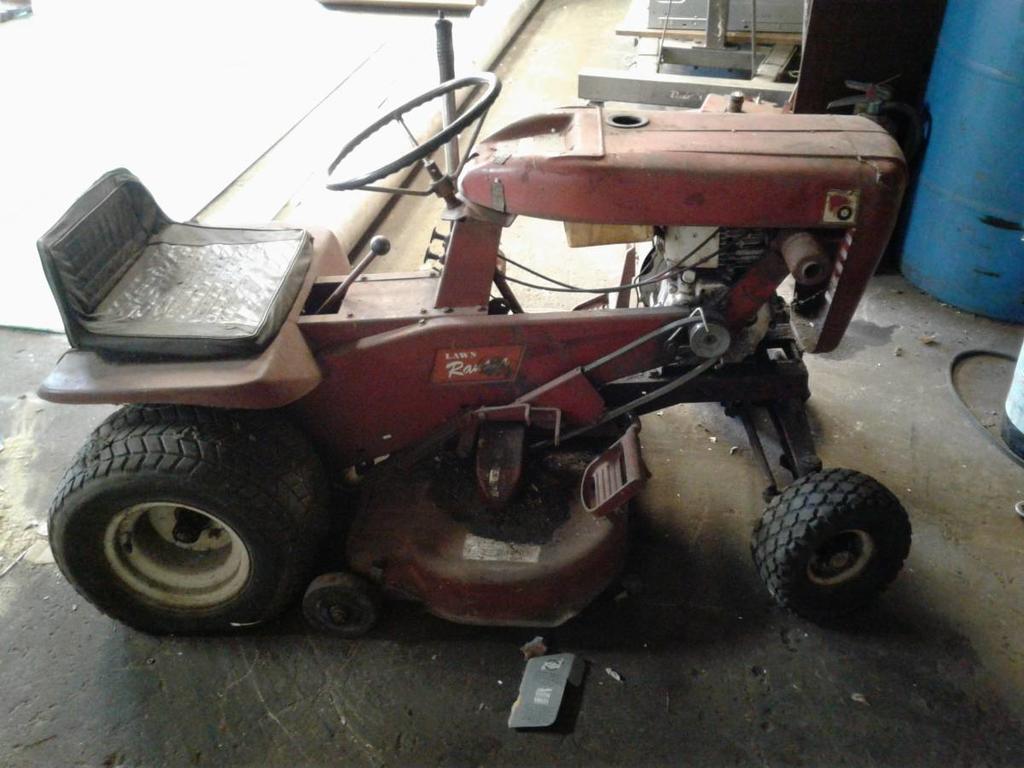

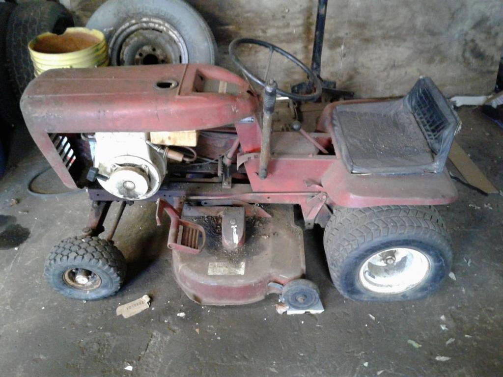

mpoore 26 #6 Posted December 1, 2017 Thanks for the input everyone. For the sake of those reading this in the future, I made a deal at $125. It was complete, but pretty rusty. The snow plow is in good shape, but I question if all of the mounting hardware is there. It also came with a homemade loader bucket. Someone took a bulldozer blade and welded a bottom and sides to it. Smart idea. It looks well done for homemade. I might turn that loader bucket into a project for my C-195 because I do not see how it could possibly work on that little Lawn Ranger. See the picture below. The hood on those old machines has some great curves. The deck bearings seem good. The aftermarket engine has compression. The original engine has something going on internally. It will rotate, but you can feel it hit something halfway around. The crank can be turned 360 degrees by hand, but it gets harder after it hits something. No compression. My guess would be a valve, but I know very little about Techumseh/Lauson. I suppose engine parts are difficult and expensive to come by. If anyone has a recommendation for a supplier, please pass it along. 1 1 Share this post Link to post Share on other sites

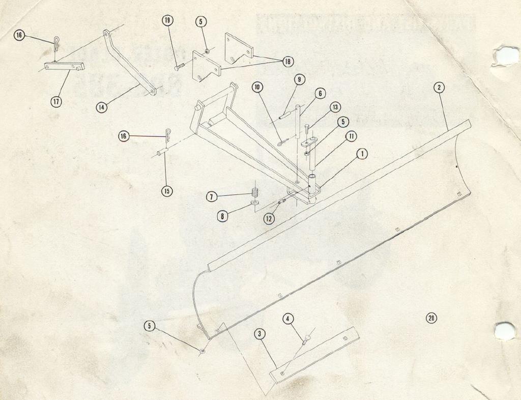

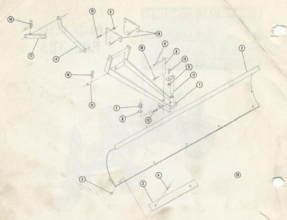

pfrederi 20,662 #7 Posted December 1, 2017 (edited) I would guess one thing you are missing for the plow is the pair of mounting plates (#5) that go on the frame and hold the plow cross rod. It is the gray thing in the picture. i had to make mine, not hard to do. Manual is here. Edited December 1, 2017 by pfrederi Share this post Link to post Share on other sites
mpoore 26 #8 Posted December 2, 2017 Thanks for the file. Original documents are always helpful. Unfortunately, the plow looks nothing like yours. Since the guy I bought it from had no idea what he had, there is a good chance I have stuff for other tractors. I think I'll start a new thread, once I take some pictures, called "Name that Part." Should be fun. I got a chance to check out the engines. Pulled the head on the original. A piece of the top land on the piston broke off. The head looks okay, but the bore has grooves. What worries me is how this would have happened. I'll post pictures once I get them. The good news is that the second engine fired with starting fluid. I think it will run with a rebuilt carb and new fuel line. 1 Share this post Link to post Share on other sites
