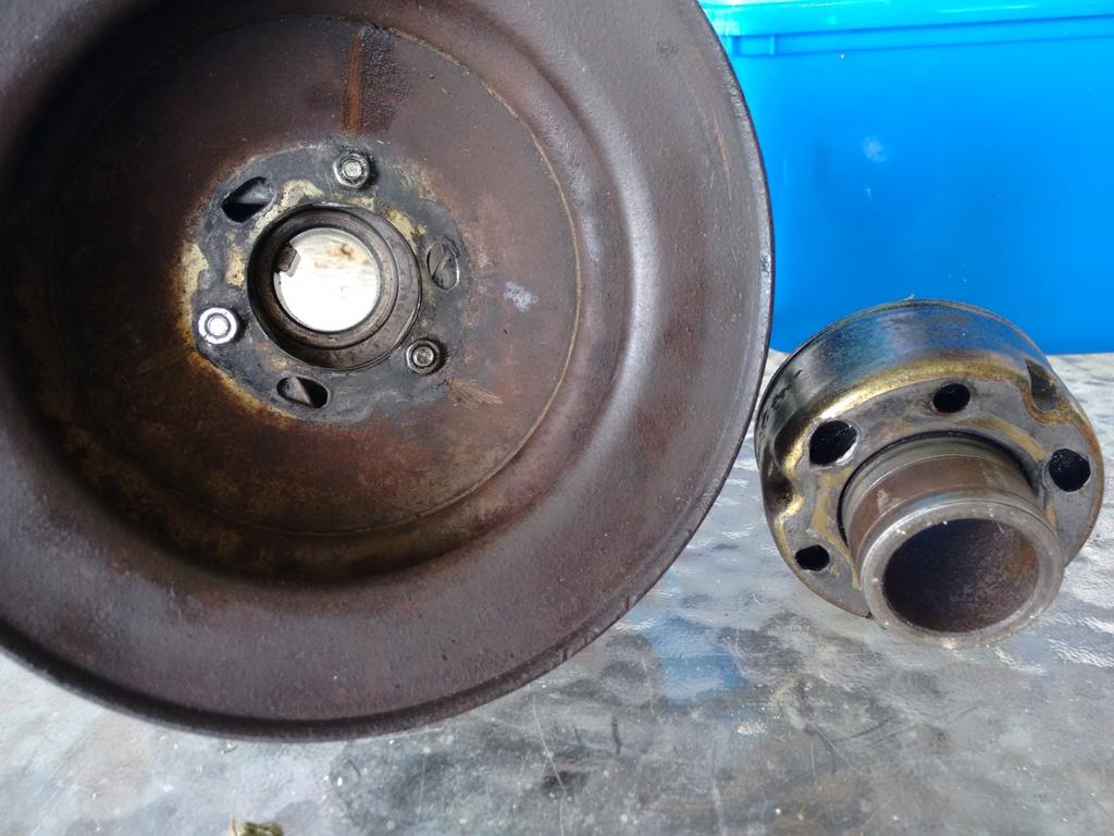

I took a picture of the clutch. I am guessing that the bolts are in place of rivets that were there originally? Does any one know why the bolts would extend into the lower bearing housing of the clutch?

More than likely a PO had chopped it apart to replace a bearing which some are not meant to come apart. They are spot welded together on these late model clutches. From the pics it looks like it's not even close to being cobbled back together properly.  . The drive pulley is just an internally keyed sleeve that slides up on the crank end and then the clutch and a fine thread bolt should  thread up into the crank holding the drive and clutch on. That bolt must be properly set and torqued. Everything must be true with the crank end or it will vibrate like mad. Check here for a replacement clutch https://xtremeope.com/  you will need one.
