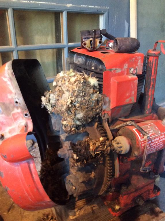

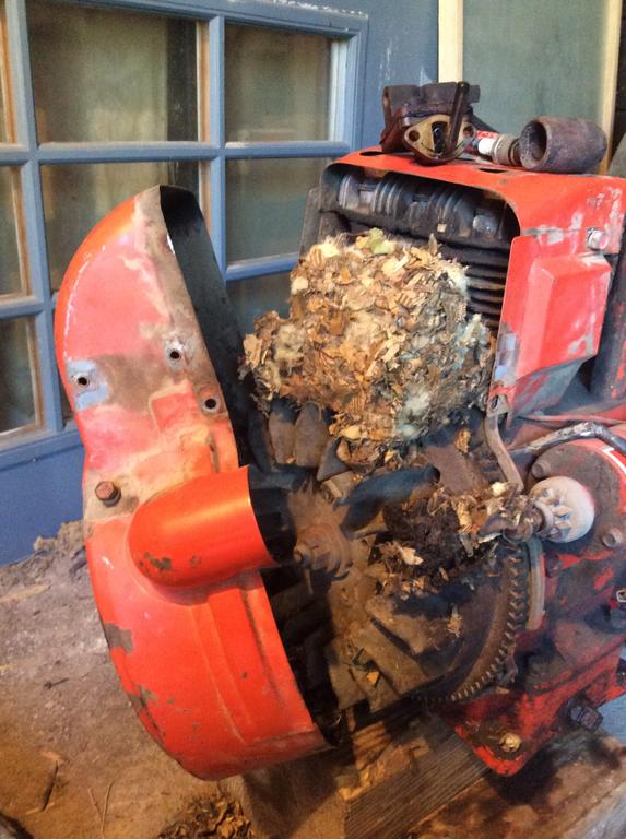

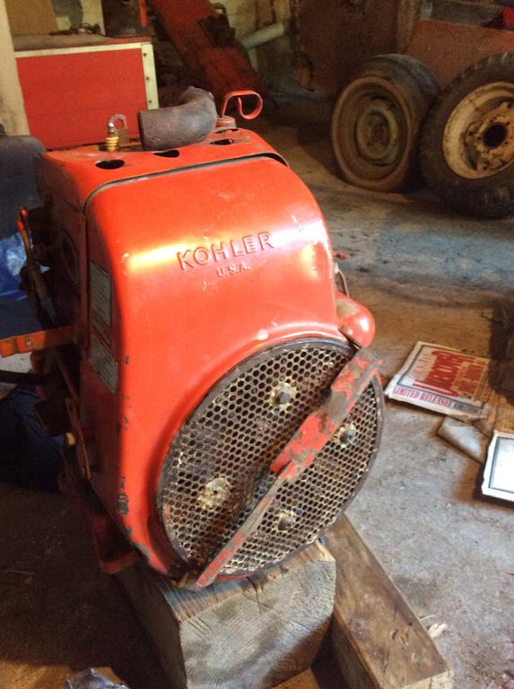

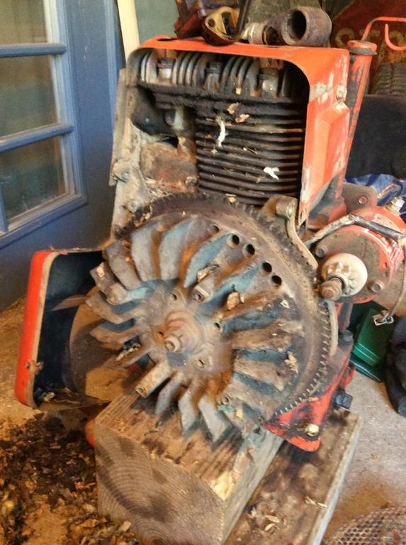

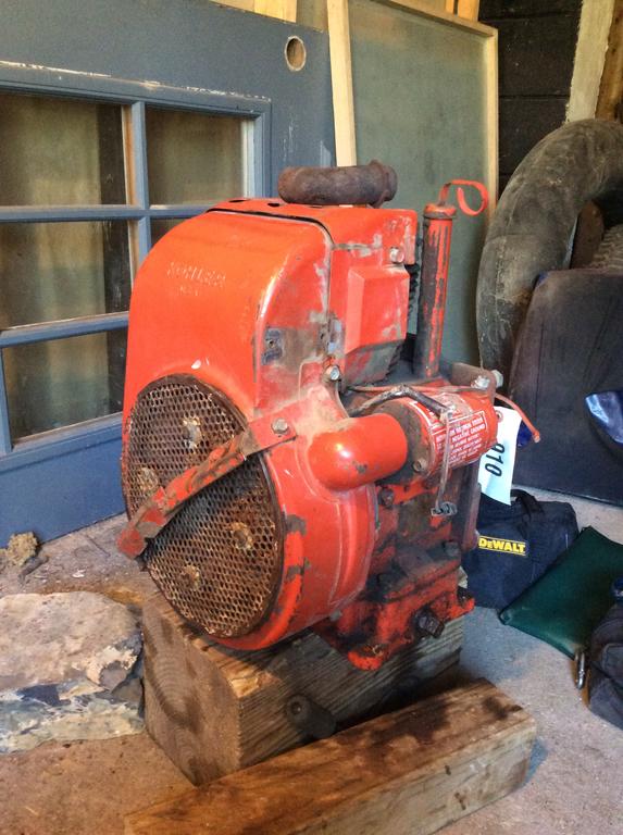

Went to an auction on Friday and picked up a kohler k241s. I thought it would go expensive but I ended up getting it for only $3 which I was very excited about. It is missing the carb, coil, condenser and air cleaner and housing. Luckily I have all of the things it is missing. The flywheel wasn’t turning the best so I took the shroud of and found a surprise, looks like not just humans like kohler. Hoping to get it running eventually and maybe pop it into my c-81. I took the fuel pump off and it seems to work okay, luckily.609F3E7F-CDFD-470B-BAC6-8277E3C64786.jpeg.165fe16bd5477909f60097d782da542a.jpeg

Good buy, I would say "Cool Pictures" but then I saw the last one.     :ychain:
I learned a lesson this summer. Bought a parts tractor and put it in the shop, next day I spotted a mouse, then a few more. From now on I will put some moth balls in them for a day or two prior to bringing them in.

Every tractor I get I take the tins off just for that reason. I had mice nests in 2 of 6 tractors. My c160 sat out in a field and had a nest around the fly wheel.

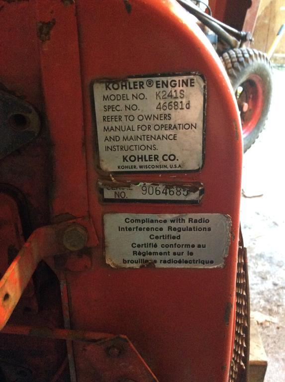

Kohler made spec # 46681 for Gravely and the 9064685 serial is from 1978.
Many of the Gravely engines used a real short pto shaft on the crankshaft.
Does this one meet your needs for the Wheel Horse pto?
http://www.partstree.com/parts/kohler-engines/engines-horizontal/k241-46681-kohler-k241-engine-k-series-gravely-10hp-7-5kw-specs-4600-46858/

IT has a mount for a gravely but the mount is removable so it should work on the horse
