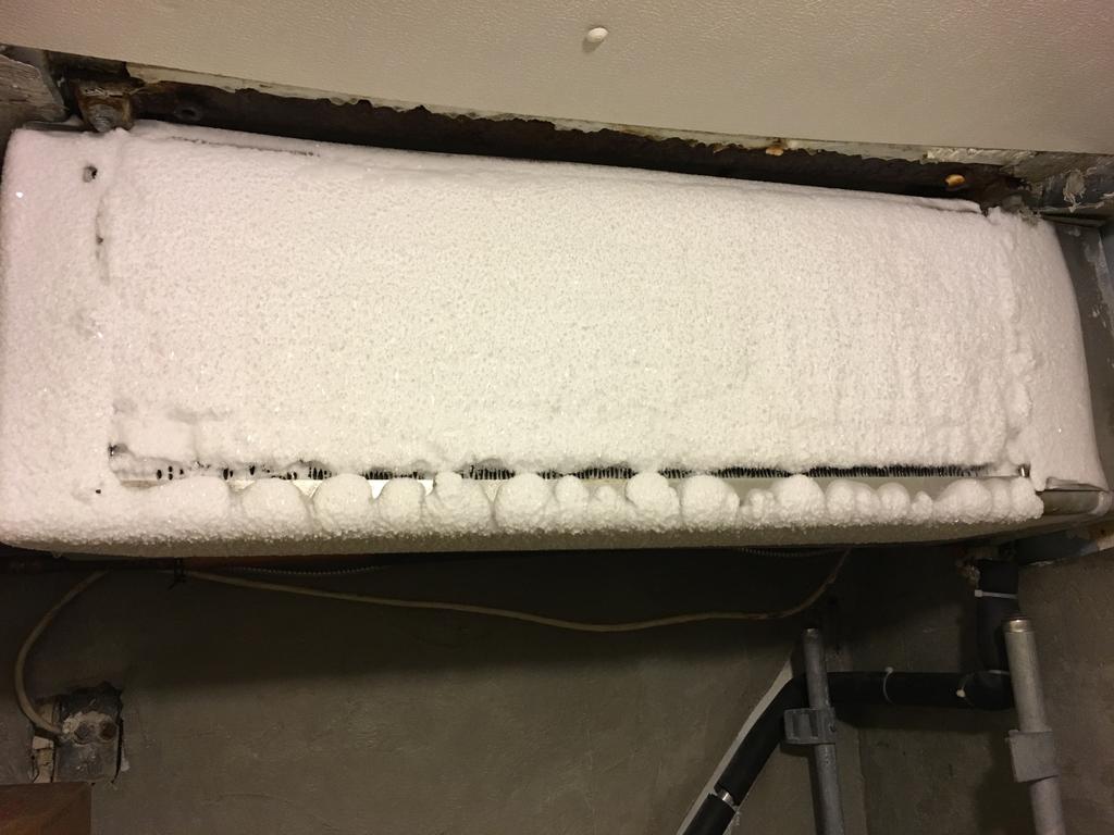

squonk 45,542 #1 Posted November 27, 2017 Don't know if I should use the 1267 with a blade, the 520 and blower or break out Elvis! Opinions gentlemen! Made ya look! 3 5 Share this post Link to post Share on other sites

KC9KAS 4,746 #3 Posted November 27, 2017 What exactly is the thing I am looking at? I know what the snow is............... 1 Share this post Link to post Share on other sites
squonk 45,542 #4 Posted November 27, 2017 44 minutes ago, KC9KAS said: What exactly is the thing I am looking at? I know what the snow is............... A frozen over freezer evaporator. School called after finding this after being closed for 5 days. Low on refrigerant and a 120 volt defrost timer with 208 volts running thru the clock motor. 3 2 Share this post Link to post Share on other sites
oldredrider 2,553 #5 Posted November 28, 2017 Is that bad? Clock must be running fast... Share this post Link to post Share on other sites
squonk 45,542 #6 Posted November 28, 2017 Clock motor not running at all so no defrost periods. Snow blocks the air flow . Evaporator temp drops due to no heat exchange so already low refrig. temp and pressure drops enough the pressure switch shuts off the compressor. Compressor cycles enough to keep the snow around but product isn't frozen. Kind of like a Nov. or March snowstorm. 1 Share this post Link to post Share on other sites
