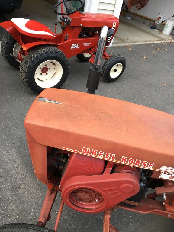

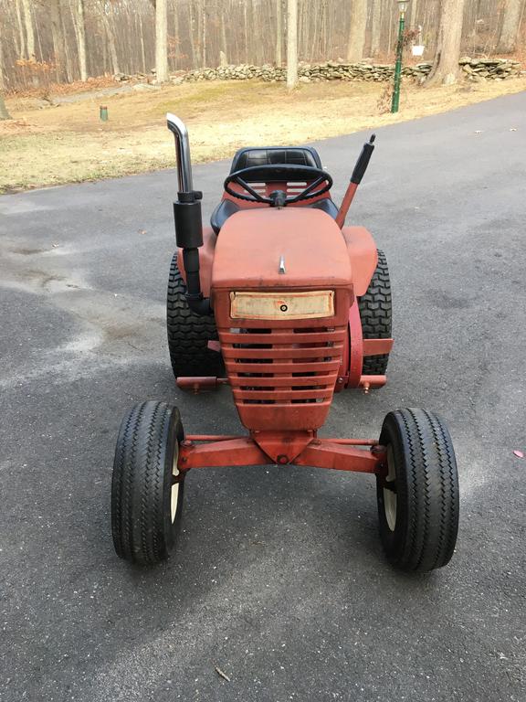

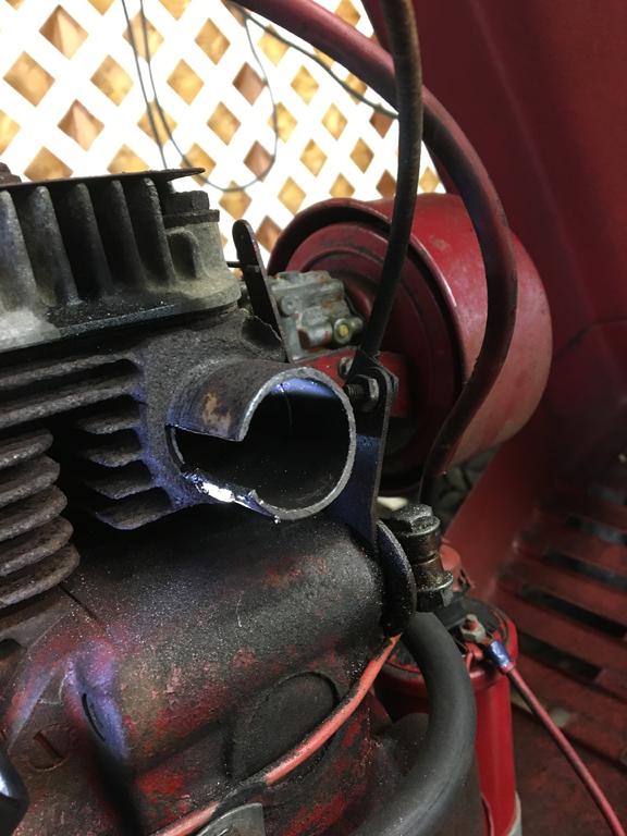

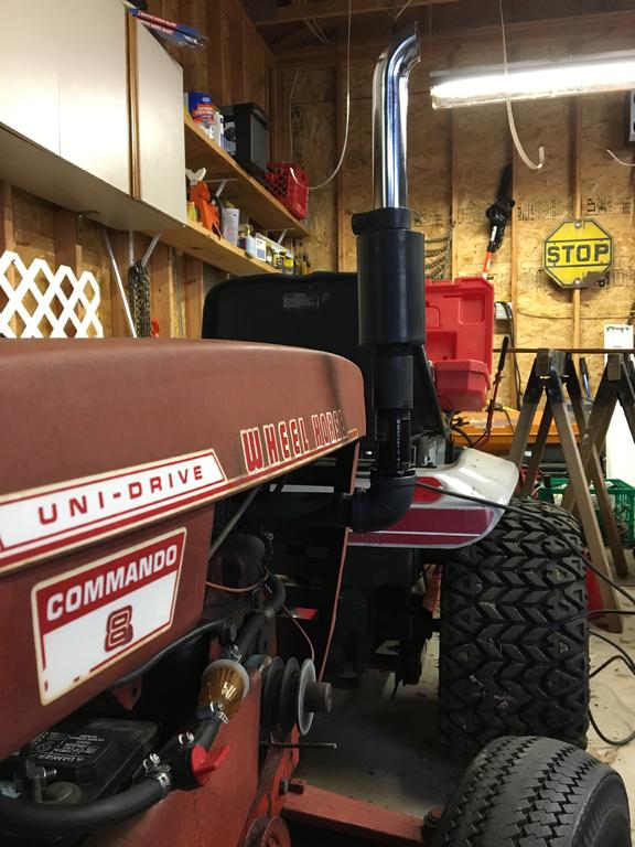

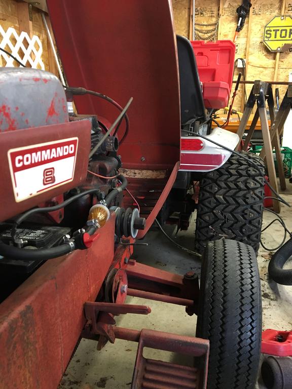

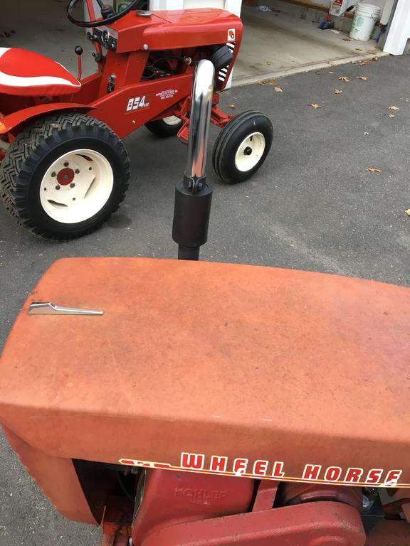

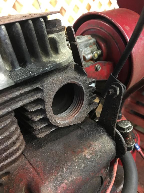

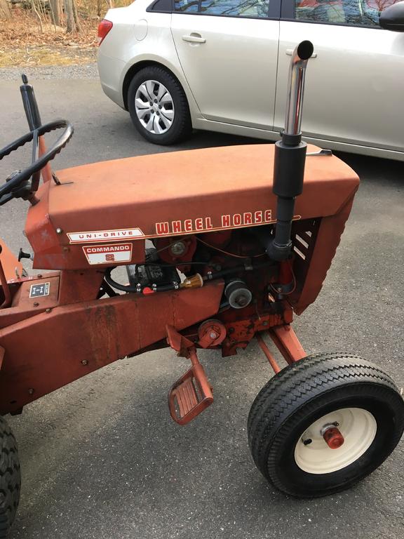

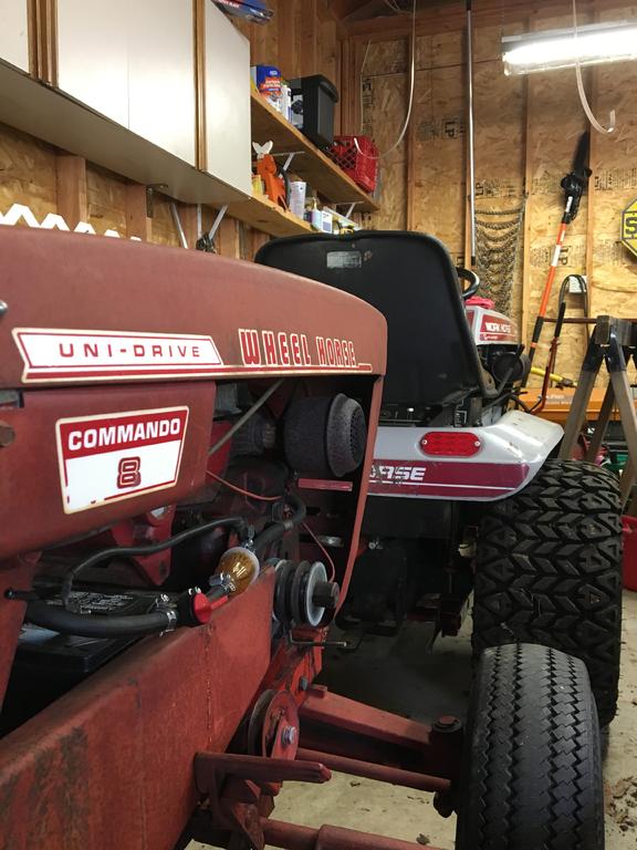

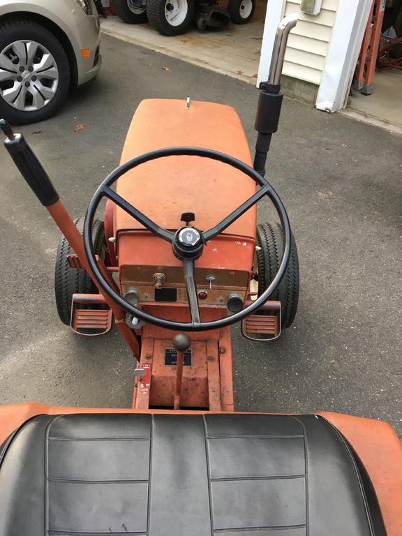

Sparky-(Admin) 24,718 #1 Posted November 25, 2017 Finally got around to installing one of the stacks I bought off @Aldon (thanks again!) at Stevebo's meet/greet. These are the smaller sized ones built by Bud Andews...perfect for a short frame tractor like my Commando 8. The old muffler looked ok but actually had rotted out on the bottom. The old exhaust pipe has been in the K181 since new so unthreading it was out of the question. I cut it off with a sawsall and then gingerly made two cuts on the inside till I could gently whack it with a chisel, collapse it and it then spun right out! Used a 6" nipple coming out of the block and a 3" for the vertical piece. Shot it all with hi-heat black and tightened it all up. Sounds great! Quieter than the old muffler, perfect for putting around shows. 12 8 Share this post Link to post Share on other sites

elcamino/wheelhorse 9,363 #3 Posted November 26, 2017 I have a couple of Bud's stacks that I have not mounted yet and have been wondering it I need to add a support to them . Any body have any thoughts on the subject. Share this post Link to post Share on other sites
Sparky-(Admin) 24,718 #4 Posted November 26, 2017 16 minutes ago, elcamino/wheelhorse said: I have a couple of Bud's stacks that I have not mounted yet and have been wondering it I need to add a support to them . Any body have any thoughts on the subject. The two I have are very light and I saw no reason to add support. The chrome piece is plumbing drain tubing and is a very light material. Did he make differant sizes? Maybe the ones you have are larger? Share this post Link to post Share on other sites
elcamino/wheelhorse 9,363 #5 Posted November 26, 2017 My stacks look about the same size and they don't weigh much. Maybe I will get around to installing them one of these days. Share this post Link to post Share on other sites
Retired Wrencher 6,512 #6 Posted November 26, 2017 Mike nice job on the stack. Is it quiet? Nice looking C/8 there. Does yours charge the battery? Share this post Link to post Share on other sites
Sparky-(Admin) 24,718 #7 Posted November 26, 2017 3 minutes ago, Retierd Wrencher said: Mike nice job on the stack. Is it quiet? Nice looking C/8 there. Does yours charge the battery? Thanks Gary! It's quieter than the original muffler. The starter/gen on this one works perfectly, charges up just fine. Share this post Link to post Share on other sites
