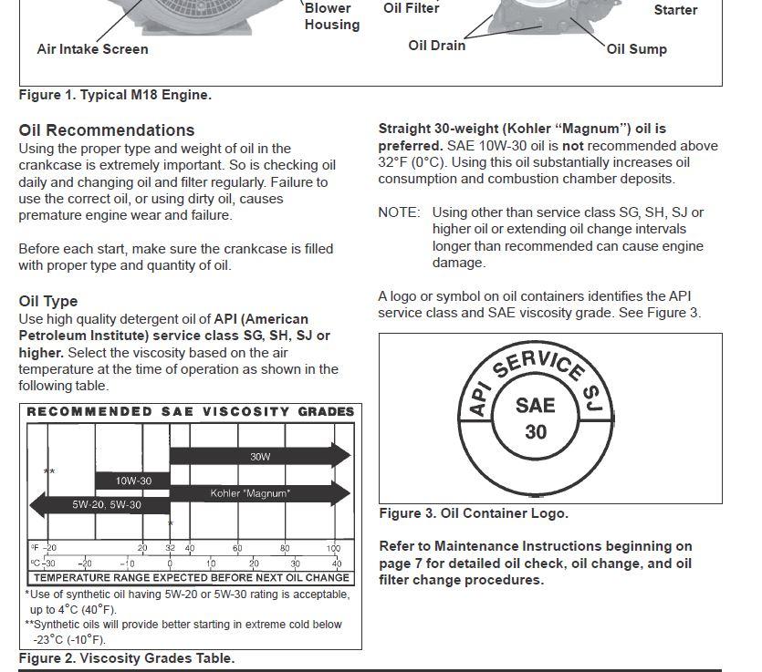

cod 129 #1 Posted November 24, 2017 Any info/warnings about running a 418 with a Kohler 18hp engine on 5-30 oil over the winter. Most of the time where I live in MD the winter temps when I'd have to clear the driveway are between 15 and 35 degrees and I've got gobs of 5-30 for the family fleet so if I can use it for the WH that would be great. Thanks - Cod Share this post Link to post Share on other sites
JoeM 10,035 #2 Posted November 24, 2017 I used 5-30 in my 418HC, never an issue. Still running good with over 1200 hours. Share this post Link to post Share on other sites
pfrederi 20,671 #3 Posted November 24, 2017 Kohler recommends it. I used in my 418 before she was removed from winter duties. (Takes forever for the hydro lift to start working) Share this post Link to post Share on other sites

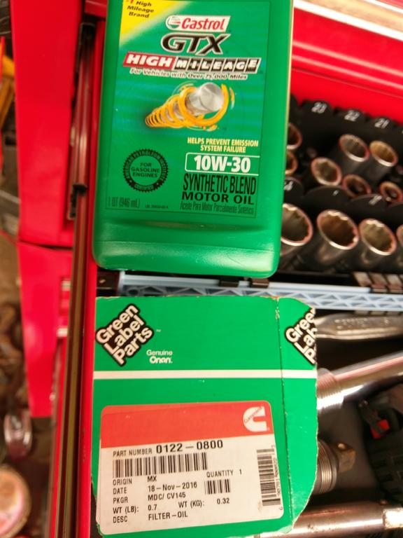

WVHillbilly520H 10,378 #5 Posted November 24, 2017 I've run 10w30 (Castrol GTX) engine and transmission in my 520H since I bought it new in '98, no engine or hydro issues to date, only thing I've changed is using high mileage synthetic blend instead of straight dino juice, Jeff. 2 Share this post Link to post Share on other sites
