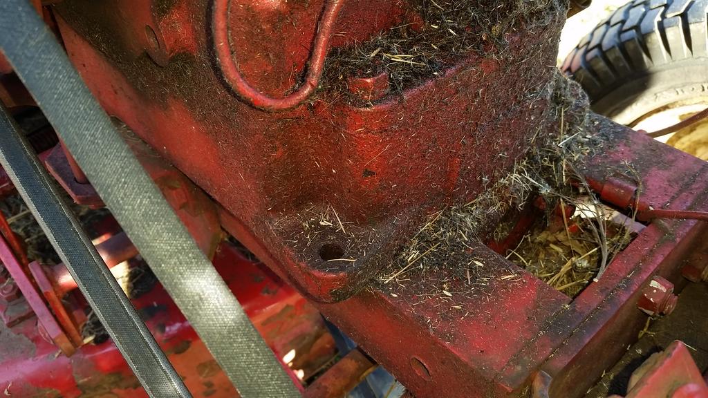

Only one side is bolted down and the other side hangs over the frame
Special :wh: oil pan has two bolts coming up into the pan.

Okay, thanks a lot. I did feel under the frame and could feel one of the bolts but didn't know if it was a modification or made that way.
