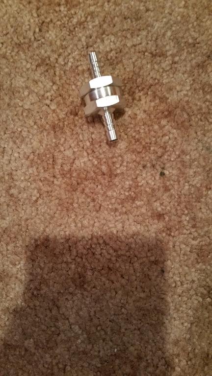

Marv 996 #1 Posted November 20, 2017 I ordered check valves off E bay to stop back feed when tractors sit for long periods. The item pictured is the Check valve I ordered. I got a pack of three. Unfortunately, they all leak. I tested them before installation to make sure they would work. Looks like I will have to find something different. Marv Share this post Link to post Share on other sites

Skipper 1,792 #4 Posted November 20, 2017 Here in denmark we have diesel specialist auto repair and parts stores. They carry that one way walve, and thay look the same and work just perfect. I use them on older diesel cars that has a problem with backflow from the pump. I can send some to you if you want. The ones I can get, are made to come apart, and you can seal the threads with a bit of teflon tape etc. 3 Share this post Link to post Share on other sites
Marv 996 #5 Posted November 21, 2017 Jerry, Ed, I have installed electrics on three of my tractors. Works great. Plan check valves on the others. They are rarely used but I like to start them once in a while. Skipper, Thanks for the offer. I opened one up and moved the poppet about. put it back together and it seems to work. I will do the others that way too. Maybe they were sticky from sitting on the shelf. Marv Share this post Link to post Share on other sites
