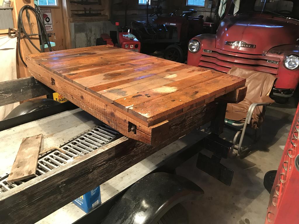

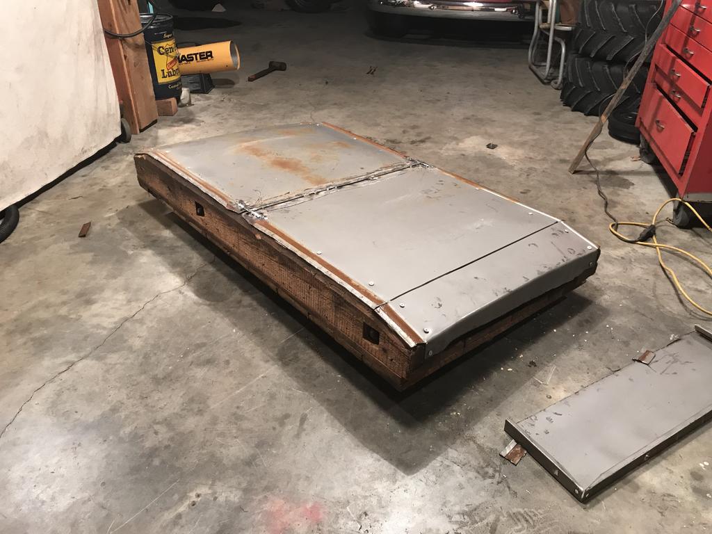

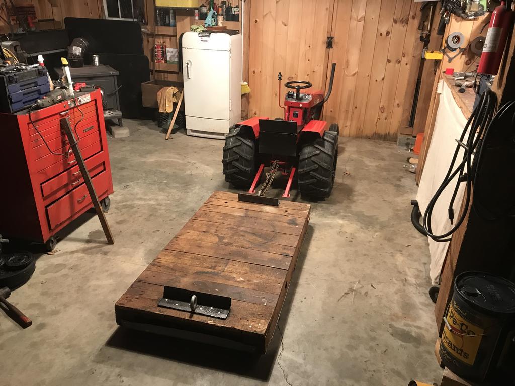

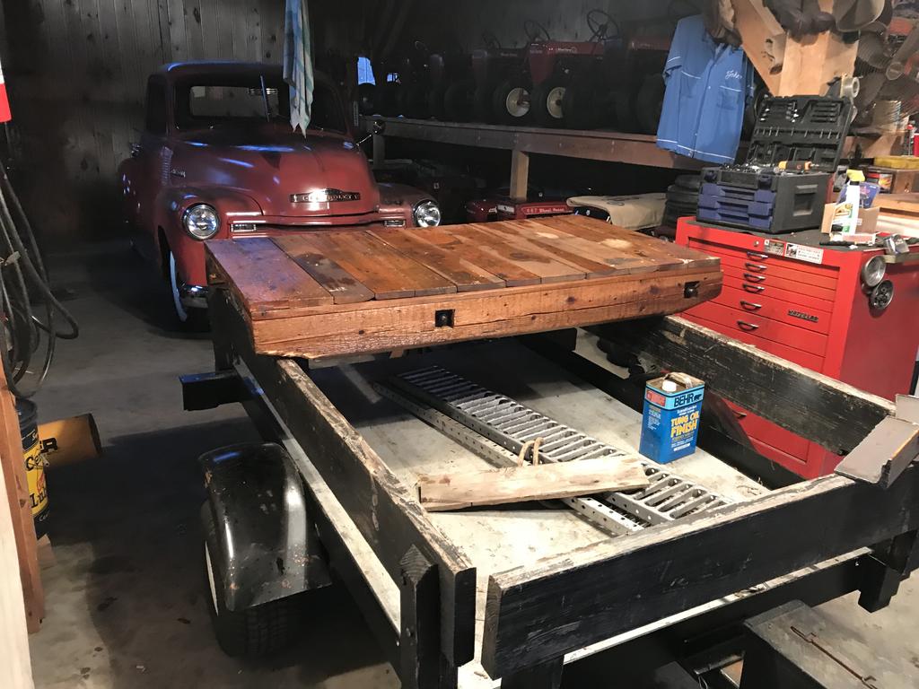

stevebo-(Moderator) 8,742 #1 Posted November 18, 2017 I figured since I am going to start to pull I needed a good stone boat. Found a real one locally on CL. I wanted to add metal plate on the bottom and found some free metal shelves. Worked out perfectly, 14 4 Share this post Link to post Share on other sites

stevebo-(Moderator) 8,742 #4 Posted November 18, 2017 15 hours ago, Daddy Don said: I want your truck. Great looking did you do all the work on it. This is a true old stone boat and bought it this way. I gave it a coat of tung oil and added the plate steel on the bottom. Share this post Link to post Share on other sites

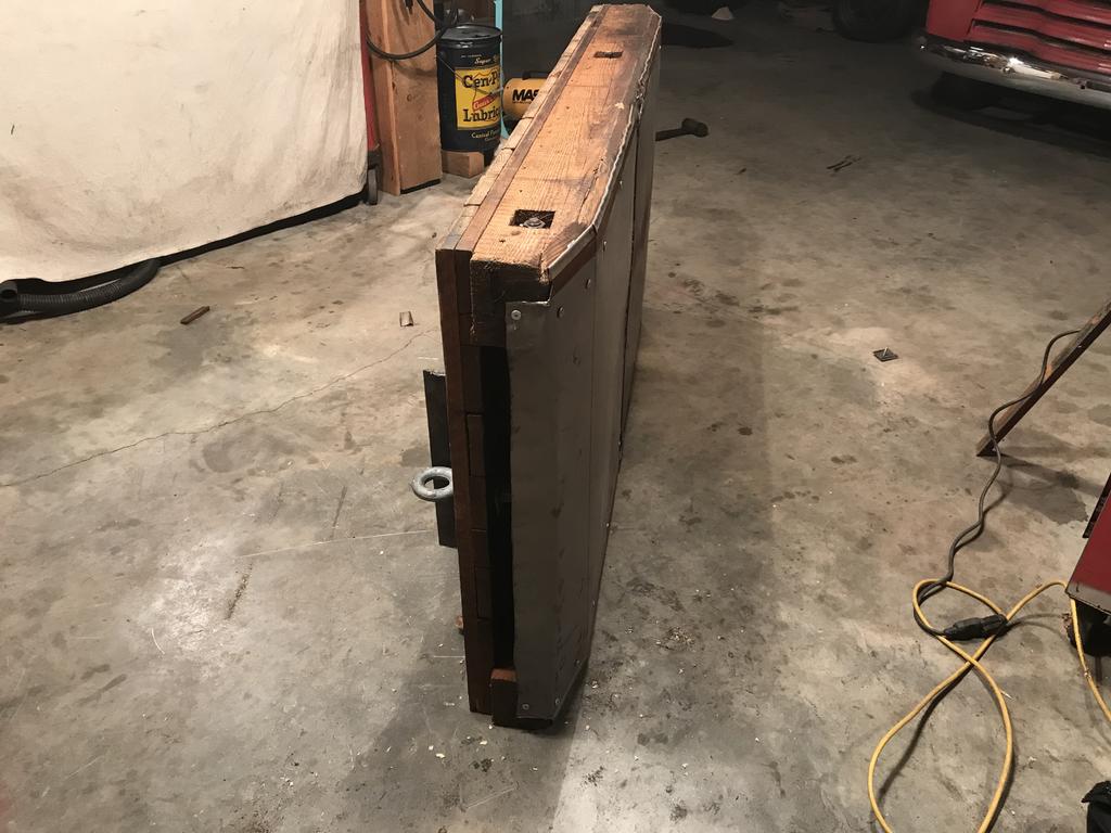

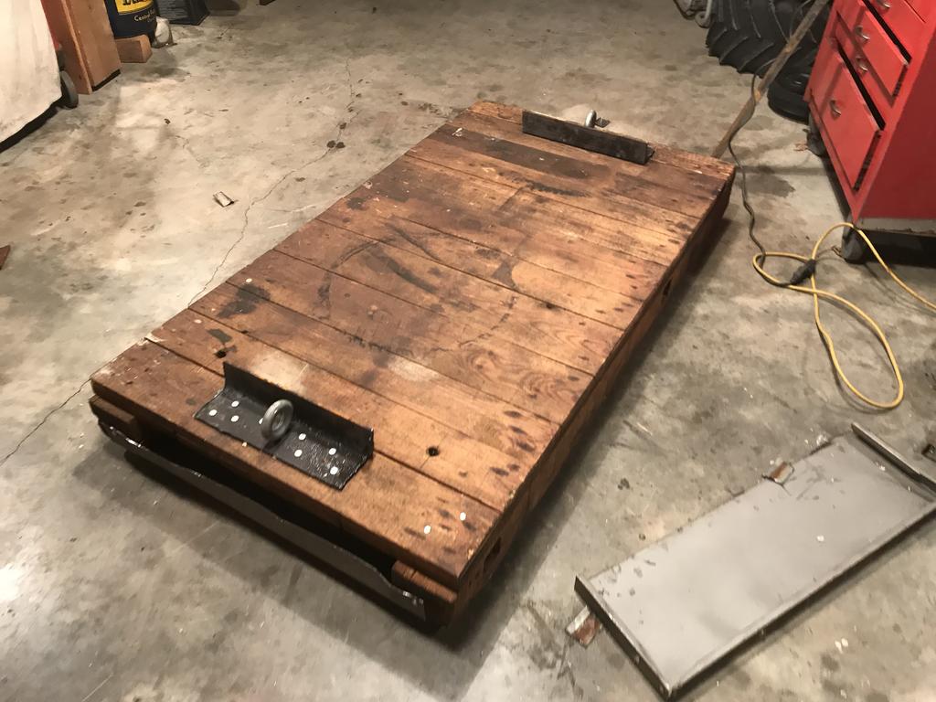

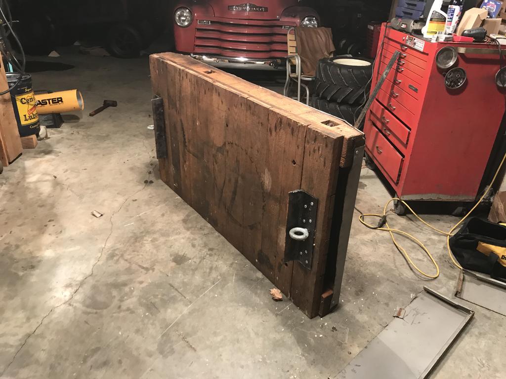

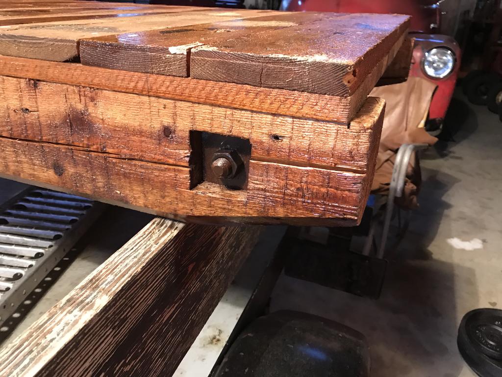

wallfish 20,705 #5 Posted November 19, 2017 (edited) Definitely a much better setup than that old tailgate. Could the location of the fasteners be a problem? Having them on the bottom of the rails instead of the sides will cause the heads to be worn off quickly. Edited November 24, 2017 by wallfish Share this post Link to post Share on other sites

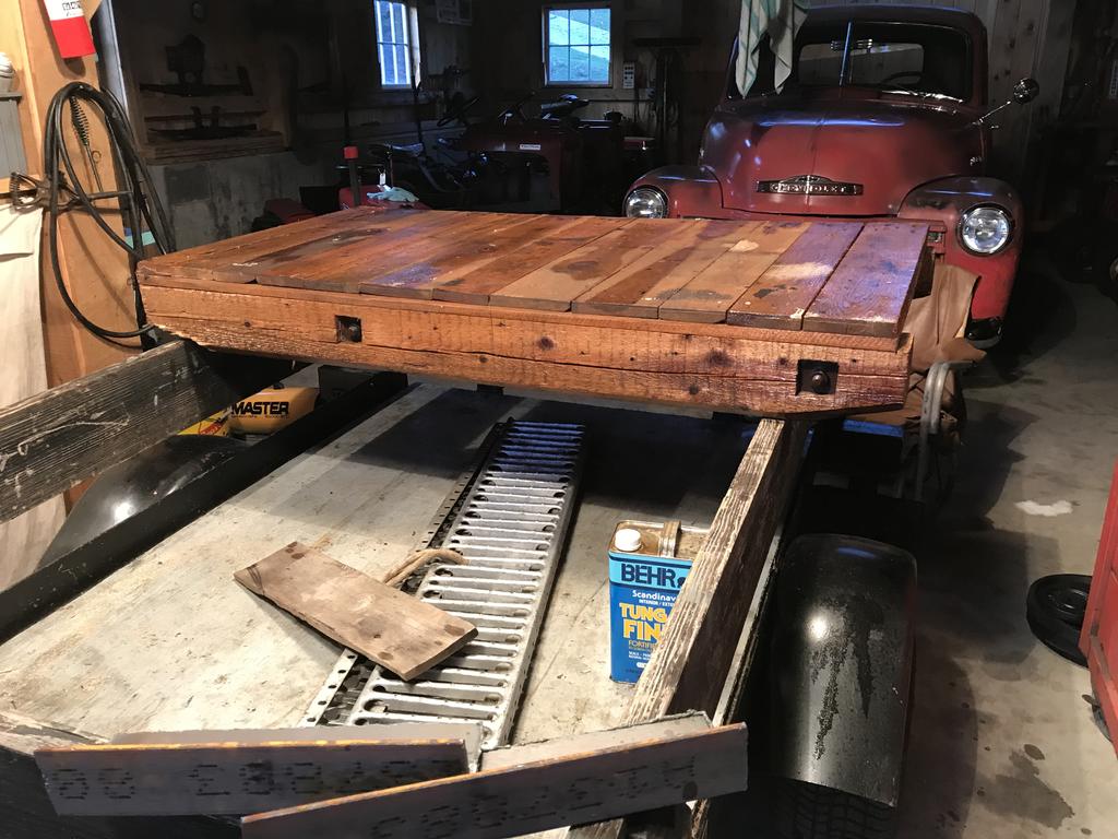

Spareparts 92 #6 Posted November 24, 2017 (edited) Just a suggestion on the eye boly, flip it over to put an upward angle on the chain to put more downforce on the tractor. More traction equals longer pulls That is a very nicely built stone boat. Now all you need is a neighborhood cook out and have all the neighbors stand in a line and step on as you go past, Edited November 24, 2017 by Spareparts 1 Share this post Link to post Share on other sites
stevebo-(Moderator) 8,742 #7 Posted November 24, 2017 6 hours ago, Spareparts said: Just a suggestion on the eye boly, flip it over to put an upward angle on the chain to put more downforce on the tractor. More traction equals longer pulls That is a very nicely built stone boat. Now all you need is a neighborhood cook out and have all the neighbors stand in a line and step on as you go past, Yes I agree. Plan is to turn them over so they are facing down. Share this post Link to post Share on other sites
