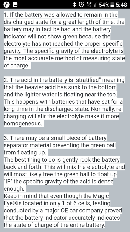

WVHillbilly520H 10,379 #4 Posted November 15, 2017 If you have had good luck with the Everstart then stay the course, especially with a battery tender you should be fine, I personally use the AutoZone Duralast Gold 425ca/340cca ($47.99 + $10 core) last one made it 8 years, using a tender/maintainer during the winter months on my 520H, they now have the state of charge eye built into them like ACDELCO car batteries (green charged yellow weak ,black dead) , Interstate used to be a decent battery too, Jeff. Share this post Link to post Share on other sites

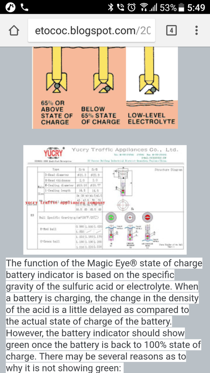

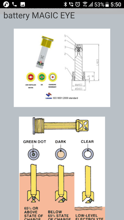

squonk 48,157 #8 Posted November 15, 2017 41 minutes ago, WVHillbilly520H said: If you have had good luck with the Everstart then stay the course, especially with a battery tender you should be fine, I personally use the AutoZone Duralast Gold 425ca/340cca ($47.99 + $10 core) last one made it 8 years, using a tender/maintainer during the winter months on my 520H, they now have the state of charge eye built into them like ACDELCO car batteries (green charged yellow weak ,black dead) , Interstate used to be a decent battery too, Jeff. Those charge eyes only show the state of charge of the cell it's over. So if it shows dead, well that cell is dead. If that cell is good but another is bad, it will still show good. I buy the TSC batteries usually with a 10% off coupon. I have 5 tractors and when the oldest battery in the fleet gets to 3 yrs. old I replace it. 1 Share this post Link to post Share on other sites

WVHillbilly520H 10,379 #10 Posted November 15, 2017 12 minutes ago, squonk said: Those charge eyes only show the state of charge of the cell it's over. So if it shows dead, well that cell is dead. If that cell is good but another is bad, it will still show good. In my personal experiences with the ACDELCO batteries it was pretty much accurate for the state of the whole battery, the new Duralast I just got this past winter/spring time will tell 1 Share this post Link to post Share on other sites
squonk 48,157 #11 Posted November 15, 2017 25 yrs. in a GM garage. I saw dozens of green eyes but dead batteries. Not disputing what you posted, just relaying my experience. 1 Share this post Link to post Share on other sites

WVHillbilly520H 10,379 #15 Posted November 16, 2017 I will have to say the original YUSA brand battery that came with the 520H in '97/'98 was a long lasting one too, till the voltage regulator let go and overcharged it 1 too many times, 1 hour ago, squonk said: 25 yrs. in a GM garage. I saw dozens of green eyes but dead batteries. Not disputing what you posted, just relaying my experience. Not arguing either, reckon I was one of the lucky ones that it worked like it was supposed to . Share this post Link to post Share on other sites
WHX?? 58,218 #16 Posted November 16, 2017 Good info ther on the green eye Jeffrey.. aways wondered how those things work. Truth be told and as cheap as I am and as many tractors I have got that have a battery Jeff Lary. I buy the cheapest thing I can lay my grubby hands on and run it. I do however have a handful of the Shumacher/Diehard battery maintainers and i usually get 5 years +- out of them. Some I get 7 or 8 out of but I suppose it has to do something with which boat they came over on! I also pull my batteries out of tractors that are in winter storage and bring them in a heated shop in winter. May not help or hurt but I can monitor them easiler that way. Correct me if I'm wrong fellas but doesn't the chemical reation slows down the colder a battery gets? Thus the old wive's tale of keeping your AA's or D cells in the freezer or a higher CCA for winter apps? No matter what batt you end up getting keep the terms clean and tight and a maintainer on it. Nothing like the way that motor whistles over even in the cold! Lots of other good threads here on whats the best battery... we've been kicking this around for years with good info. 1 Share this post Link to post Share on other sites
