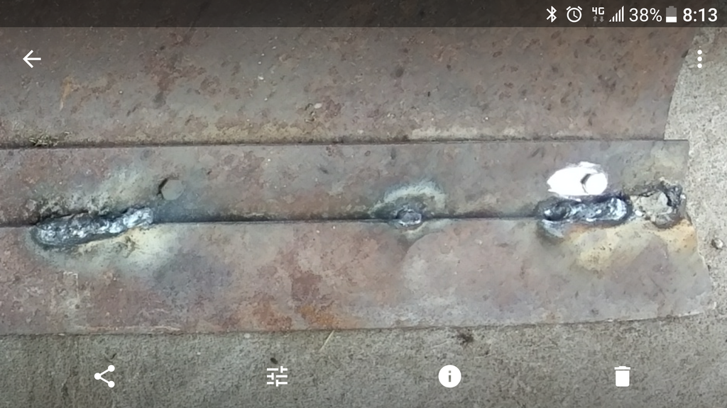

WVHillbilly520H 10,379 #2 Posted November 13, 2017 , or if you're up to it an old car/truck leaf spring will wear better than most anything you can buy that's what I have welded on mine, Jeff. Share this post Link to post Share on other sites

WVHillbilly520H 10,379 #5 Posted November 14, 2017 1 minute ago, Tankman said: I was thinking Lowes, flat bar. I like the spring idea but, wouldn't weld it on. 3" flat bar, wide, would last twice as long as the standard edge. I should have made myself a little more clear, welded to the existing worn edge not to the moldboard, please forgive my poor looking welds but they seems to be holding up just fine, Jeff. 1 1 Share this post Link to post Share on other sites
