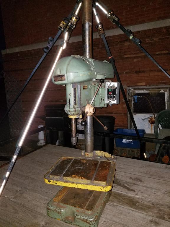

Sarge 3,473 #13 Posted November 12, 2017 While not a tractor - this is truly related as a tool used to repair them and make new parts - 1952 Atlas/Clausing model 1810 drill press . Currently in about 200 pieces in various spots of the shop taking up precious space , really need it back together and in service . What started as a simple bearing/spindle check snowballed into a full resto - So glad I found an IPL and book on this thing - they are quite rare and putting it back together correctly would be some serious head scratching . Biggest thing I have to work on for it is the table/head lift's gear box - found a used one and will have to rebuild it as they gears are severely worn . Will be welding those teeth up once I figure out what metal they are made from and re-profile the teeth to fit better . The truly unique thing about how they built this unit is that table/head lift is positioned in a way that it can lift either the table or head - makes it a much more versatile machine . It's taken a serious learning process , but setting it up to be used with a variable frequency drive for the Atlas 3/4hp 3ph motor running on 220vac 1ph power here . Head and base is painted already - need to finish painting the table and gear box , then start the assembly nightmare . Few other small parts have to be made that were missing - finding anything used for it is a joke . Sarge 4 Share this post Link to post Share on other sites

Sarge 3,473 #16 Posted November 12, 2017 I had passed on one smaller Walker Turner - the table on it was the small round one and I wanted a larger production table . The Clausing has a huge 22" wide table with t-slots included and of course a nice smile of shame from living in a high school shop in Chicago . Got all that damage welded/machined and just need to paint it plus work on that infernal gear box . Sarge 3 Share this post Link to post Share on other sites

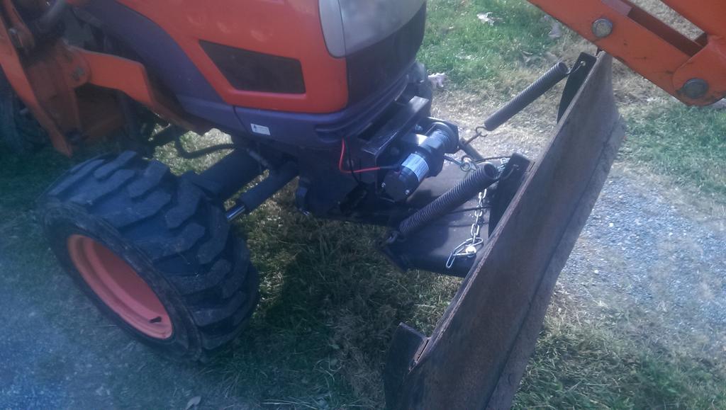

WVHillbilly520H 10,379 #19 Posted November 12, 2017 (edited) Converting a fully hydraulic (lift and angle) JD dozer/snowblade to fit and work my Kioti CK20 compact vs the manual angle winch lift version I did last year, so dad has a beastly snow pusher in WV. Edited November 12, 2017 by WVHillbilly520H 3 Share this post Link to post Share on other sites

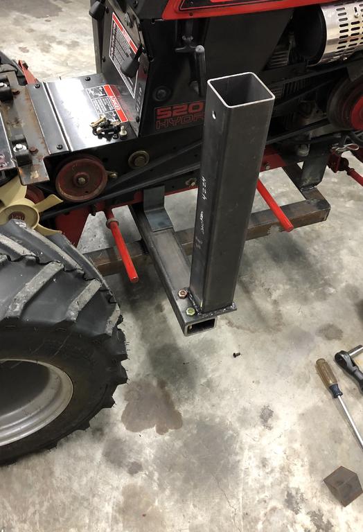

cschannuth 3,821 #21 Posted November 16, 2017 Working on loader for the 520. I’ve been looking for a long time and have been close on a couple of deals but financially it never worked out. Decided to gradually pull all the pieces together to build my own. My wife got me the P.F. Engineering plans for my birthday and my father-in-law has access to some free steel. I still need to buy some steel but not a lot. My dad had a forty year old Montgomery Ward stick welder that still works really well and I practiced for a few months on scrap and got to the point where my welds look Ok and have decent penetration. The other pieces I’m buying as money allows and I find things on sale. Here are a few early pics of the bucket and the partially complete subframe. 11 Share this post Link to post Share on other sites
