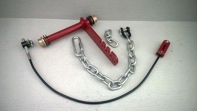

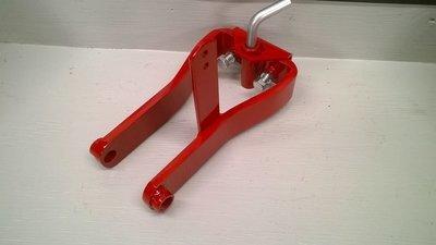

Shea Worden 40 #1 Posted November 11, 2017 Im gonna get these pieces to start a collection of attachments. Do you guys have any tips for installing the rockshaft? Share this post Link to post Share on other sites

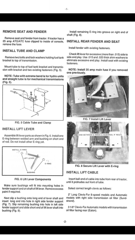

WVHillbilly520H 10,369 #2 Posted November 11, 2017 This should get you started, Jeff. 1 Share this post Link to post Share on other sites
Mal(Pa) 73 #3 Posted November 12, 2017 Hi, be sure not to force the box apart to put in the shaft.It has to be in it's original position to get the bolt holes to line up when putting the fender pan back on.Also put the short bolts in above the gas tank. Have fun. Mal 1 Share this post Link to post Share on other sites
