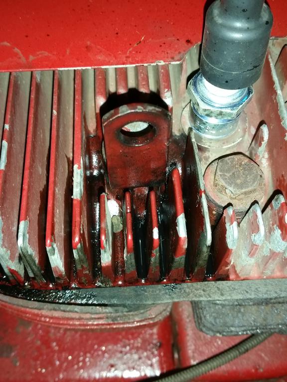

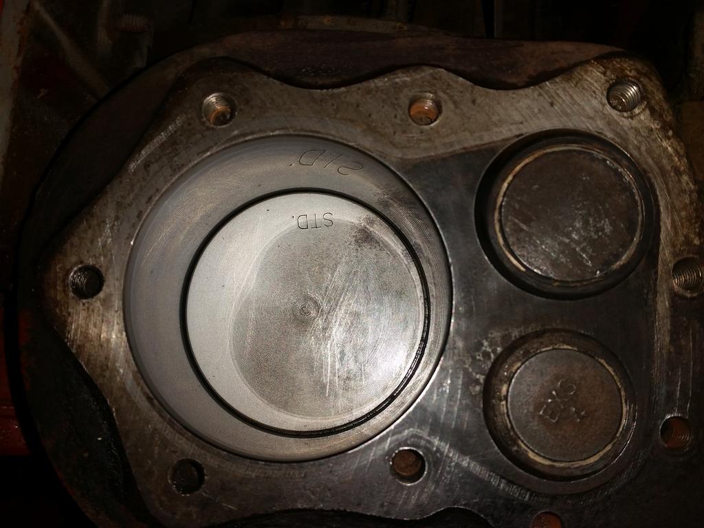

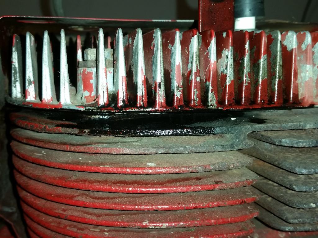

AlexR 2,224 #1 Posted November 7, 2017 (edited) Yes this is very strange and I can't figure it out. I have another thread in the wheelhorse tractors but.. figured I should post this here. So I had the engine apart and the intake valve spring was broken I replaced the spring and cleaned the top of the engine and installed a new headgasket mowed yesterday ran fine mowed today and I noticed the oil on the head. The oil level is fine and same as it was when I put new oil in. And it only smokes when I rev it up its not like the engine smokes a lot. :Edit: head pic is when I had it apart and cleaned it Edited November 7, 2017 by AlexC120 Share this post Link to post Share on other sites

AlexR 2,224 #3 Posted November 7, 2017 I checked the head bolts and they are not at the 25ft-lbs I had set them at so I probably should do that twice. Can oil come up the head bolt holes? Share this post Link to post Share on other sites
BOB ELLISON 2,981 #4 Posted November 8, 2017 The gasket should stop oil. You need to get the engine hot then torque them again in order. Did you make sure the head wasn't warped and was perfectly flat before you torque the head ?? 2 1 Share this post Link to post Share on other sites

AlexR 2,224 #6 Posted November 8, 2017 I double checked the breather to make sure but yeah I did assemble it correctly. Pretty sure its that I didn't tighten it after I ran it the first time so I will see if that fixes it. 1 Share this post Link to post Share on other sites

MalMac 1,333 #8 Posted November 8, 2017 Should not have that much oil, check for stuck or broke ring. Share this post Link to post Share on other sites
953 nut 62,119 #9 Posted November 8, 2017 Head gasket should be hot torqued after it has been operated at full temperature for the first time. 1 1 Share this post Link to post Share on other sites
WHX?? 52,895 #10 Posted November 8, 2017 All of the above Alex... I had a K241 blowing like that but after rechecking head bolts most took a full turn or better to reseat them. Oil cannot come up the head bolt holes unless something is not right but oil or antiseize or preference choice of metal to metal lube should be used to help properly torque them. Head bolt torqueing is an art form in itself and the only way I learned it was trial and error and experience. 1 Share this post Link to post Share on other sites
Fordiesel69 271 #11 Posted November 8, 2017 HOLY bore polishing going on there......... That cylinder is like a mirror that you can see the reflection of STD in it. The engine is using oil and being oil is not very compressible, it is blowing our the head gasket / bolt hole. Address the oil buring by using a dingle ball hone, and a set of rings. 1 Share this post Link to post Share on other sites
