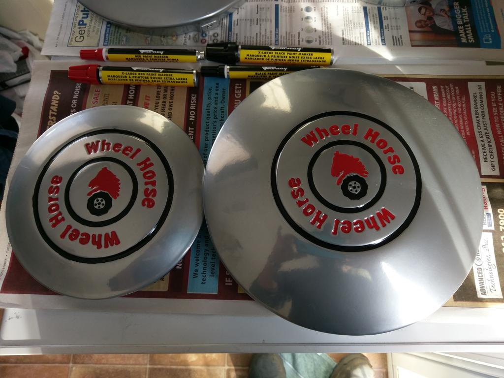

I had these done in an "aluminum" to chrome powder coating at $80, then did the embossing with paint markers, Jeff.
