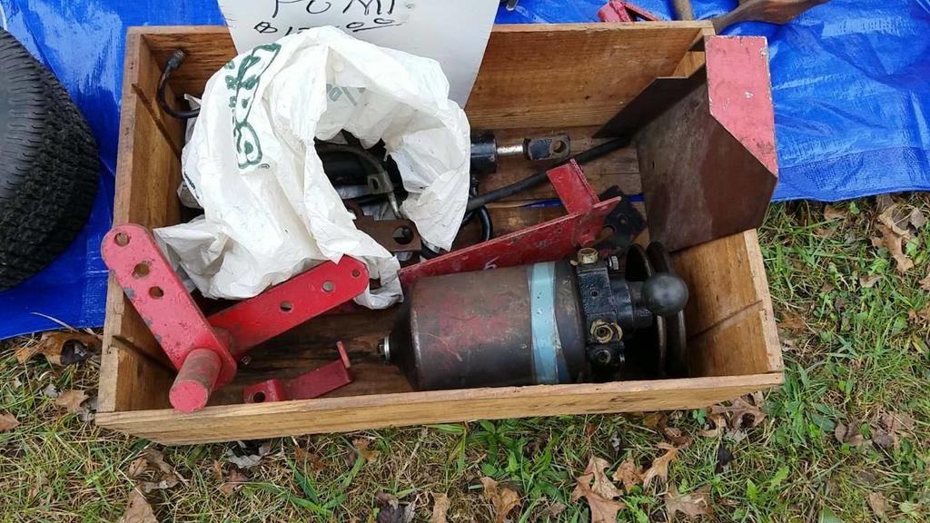

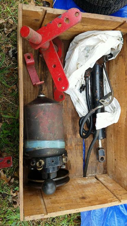

DBlackston 333 #1 Posted November 6, 2017 I'd love to see some pictures of a mounted HY-3 setup and a video of it in use. I recently purchased one and would like to see one in use. It won't fit my 704 so I'm going to be looking for a tractor to put it and mymid mount blade on. Share this post Link to post Share on other sites

littleredrider 409 #4 Posted November 6, 2017 Need to get the dash tower of what model the setup came from.... Share this post Link to post Share on other sites
