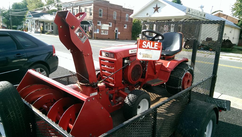

grinchsr 667 #1 Posted November 5, 2017 Picked up a WH 2 stage blower recently to put on a 520 but now thinking about sticking it on a 314. Will there be enough power? Share this post Link to post Share on other sites
c-series don 11,895 #2 Posted November 5, 2017 I really think that depends on how deep the snow is and how greedy you get. I have 44" on a 417-A and I love it! 1 Share this post Link to post Share on other sites
stevebo-(Moderator) 8,628 #3 Posted November 5, 2017 Ray- I think it should be fine on the 314. You may have to go a little slower in the deeper stuff. 2 Share this post Link to post Share on other sites
grinchsr 667 #4 Posted November 5, 2017 THANKS for the fast answers gentleman. I normally creep along with my single stage anyway so going slow will be no problem. Hell I am old so slow is a daily event!! 3 Share this post Link to post Share on other sites
squonk 46,463 #5 Posted November 5, 2017 I'd be more worried about lifting that beast with the manual lift as opposed to hyd. Share this post Link to post Share on other sites
MalMac 1,336 #6 Posted November 5, 2017 One thing to remember is that hydro on the 314 will take 2 or 3 hp’s away before you even add the 2 stage. That blower was mainly designed for the 520. Even though the 314 will run it, you will be tasking that motor the whole time your running it. It will put a lot of wear and tear on it. Also that 2 stage is designed and meant for big snows. It works best with big snows. Big snows translate to more hp’s. Yes you can put it on a 314, but I would not suggest it. 2 Share this post Link to post Share on other sites
squonk 46,463 #7 Posted November 5, 2017 What was wrong with the single tall shoot? I have one and it throws snow as far as I need it to. 1 Share this post Link to post Share on other sites
lynnmor 8,806 #8 Posted November 5, 2017 27 minutes ago, squonk said: What was wrong with the single tall shoot? I have one and it throws snow as far as I need it to. I have both the single and the two stage that I use on 520's. Both have minor advantages and disadvantages, but I can see no huge difference in performance. Wet, heavy snow will really tax a 14 HP, I have worked 20 HP to the limit with either blower. 3 Share this post Link to post Share on other sites
grinchsr 667 #9 Posted November 5, 2017 Nothing wrong with the single at all I love it. I picked up a 520 with a KT17 and the 2 stage attached. Was thinking about making it my plow machine. Share this post Link to post Share on other sites
ericj 1,580 #10 Posted November 5, 2017 i have a 2 stage on a 520-H, if you have a good running 520, put the blower on it. it will handle it much better then a 14 hp ever would. would you pull a 10000 lb enclosed trailer with a little pickup ? while it may do it it's better and safer to use a 3/4 ton truck to pull it. You state that you want the 520 to plow with, it would do a great job plowing but a plow don't require horse power the blower does. good luck eric j 1 Share this post Link to post Share on other sites
grinchsr 667 #11 Posted November 5, 2017 Point taken Eric. Looks like I have to buy another 520 LOL. I have a better idea. I am going to buy Stevebo's 520HC but don't tell him 3 Share this post Link to post Share on other sites
WVHillbilly520H 10,378 #12 Posted November 5, 2017 The guy I bought my 2stage from ran it on a 314-8 then a 315-8 and said he never had any problems blowing 18"+ snow falls with it, and with the helper spring wasn't that bad lifting it, but yes the twin cylinder Onan didn't seem to mind it in 2'+ a couple winters ago, and another one I missed before I got mine was on a C160 with manual lift, low range 1st or 2nd should keep chugging/chucking along, Jeff. 2 Share this post Link to post Share on other sites
grinchsr 667 #13 Posted November 5, 2017 Now that's a good looking C160. Thanks for the info 1 Share this post Link to post Share on other sites
ericj 1,580 #14 Posted November 6, 2017 7 hours ago, WVHillbilly520H said: The guy I bought my 2stage from ran it on a 314-8 then a 315-8 and said he never had any problems blowing 18"+ snow falls with it, and with the helper spring wasn't that bad lifting it, but yes the twin cylinder Onan didn't seem to mind it in 2'+ a couple winters ago, and another one I missed before I got mine was on a C160 with manual lift, low range 1st or 2nd should keep chugging/chucking along, Jeff. I don't doubt s 14 hp 8 speed would do the job, but your asking a lot of it, like stated above by someone a hydro requires at least 2 horse power to run. if you had no other tractor I would advise you to try and see how it does, BUT if you have a more suitable tractor to put it on why not save yourself a lot of aggravation and put it on the more suitable machine. I personally would not put mine on anything less then 16 hp. I feel fairly confident that an 16 hp onan would get it done and pretty sure that a K341 would also do it. I've only ever owned one K341 and never really worked it that hard, but from what everyone on here say it should do it. the KT17 should be able to do it also, and possibly a Briggs 18 hp or more eric j 1 Share this post Link to post Share on other sites
