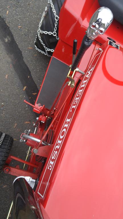

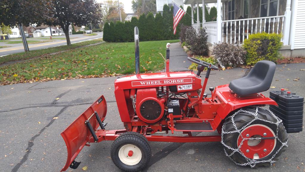

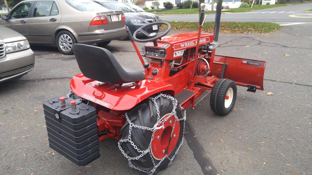

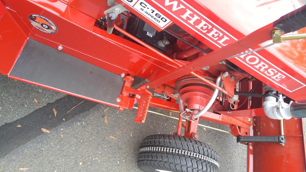

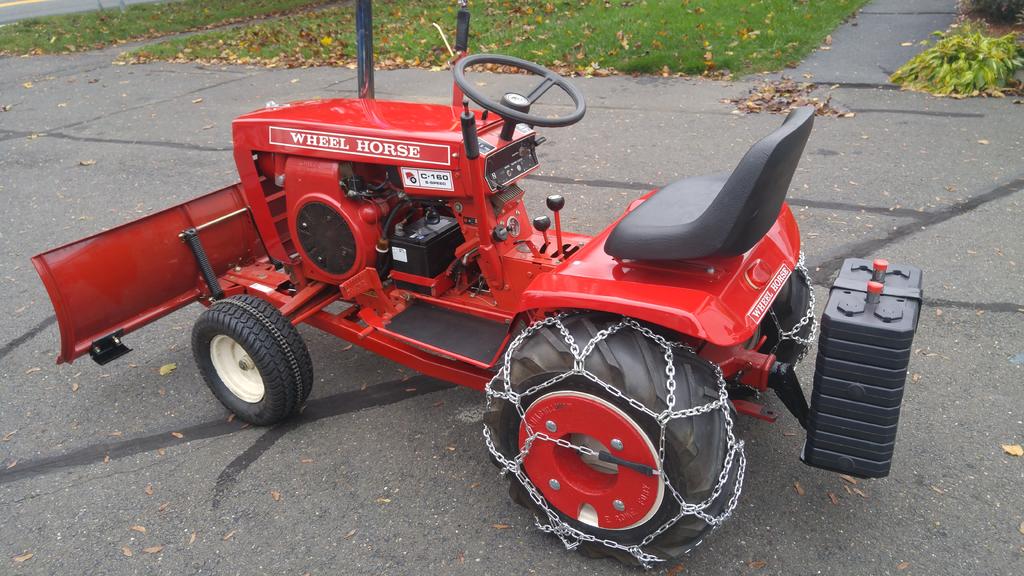

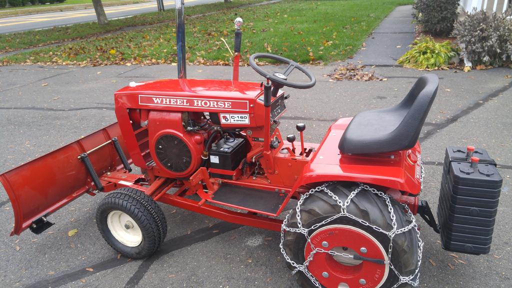

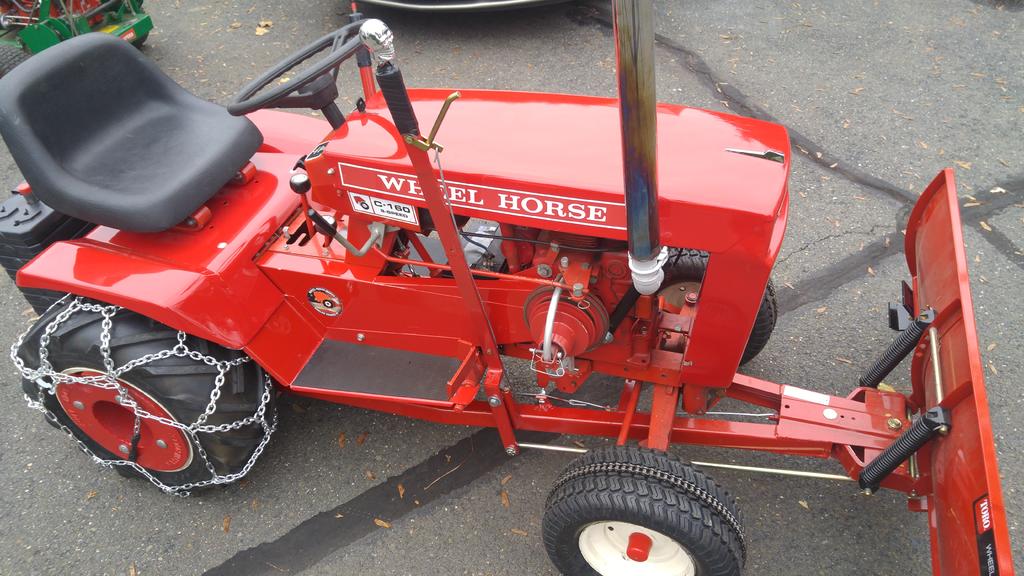

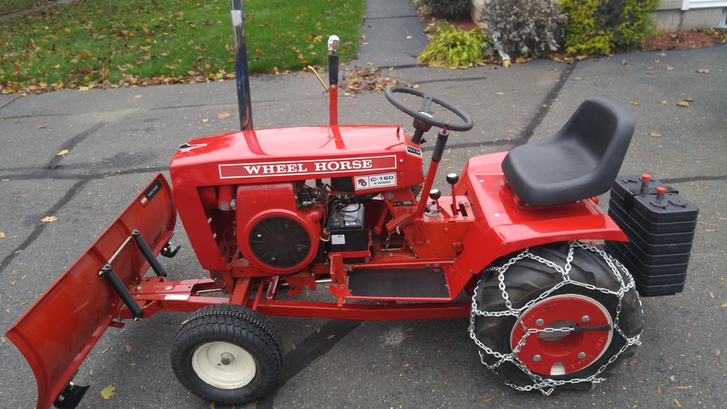

mrc 1,068 #1 Posted November 1, 2017 hi all, here is my son-in-laws C160. i put new front tires on with the roller chain idea. brand new plow converted from the cable angling system (which did not work very well) back to the tried and true wh coat hanger system. if i can fab this anyone can. my SIL wanted a chrome skull somewhere on the tractor so on the angle control handle it went. removed the battery box, sandblast,prime and paint. new black pipe manifold for the exhaust with custom harley stack. i fabbed a bracket to add support for the manifold. my buddy harry fabbed the counterweight support for the gym weights. it fits great in the "Hitch guys" receiver. (they are a vendor on this site and make a great product!) i added some metal wheel weights that i had powder coated. new diamond style chains for the rear. i replaced both axle seals, the tranny drive pulley shaft seal, the brake band shaft seal and fresh gear oil in the tranny. fresh oil in the engine and new air filter with prefilter installed. greased all zerks. i put on a new brake band from maynard and it stops on a dime! my bud mark painted the floorboards and belt cover. i added a couple decals from terry (another great vendor and product) and new floor board mats from another vendor (classic kitchens, great product!) special thanks to my bud phil for the pics. regards mike in mass. 6 6 Share this post Link to post Share on other sites

mrc 1,068 #8 Posted November 2, 2017 hi searcher60, several years ago when i first got this c160 my bud mark filled in some holes on the fender pan and i think the hood too. i'll ask him. i do know he uses automotive paint and clear coat. mike Share this post Link to post Share on other sites
