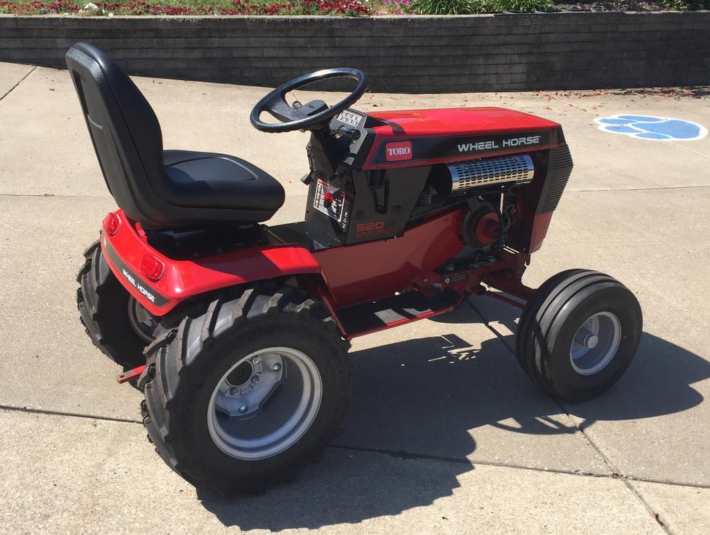

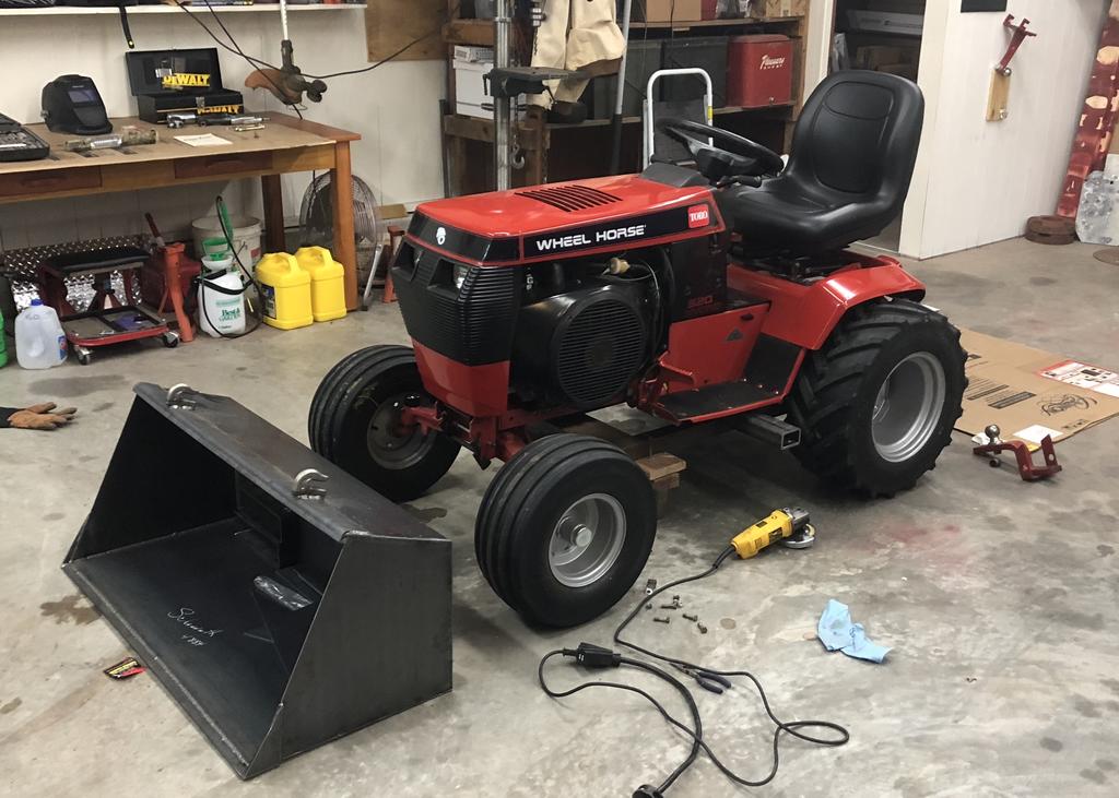

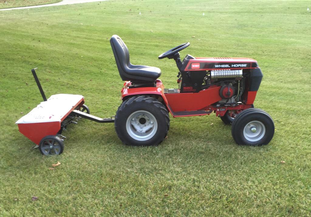

cschannuth 3,819 #7 Posted November 1, 2017 I have them on my 94 520. It’s going to get a loader so I’m not sure about a mower deck. I like them a lot. I have Carlyle Ags our back that are a little bigger than the turfs so it still sits pretty level. Here’s a side, 1/4 rear, and 1/4 front shot. 2 1 Share this post Link to post Share on other sites
Bttatro 94 #8 Posted November 1, 2017 @cschannuth, that is a sweet looking machine! I love those toes and wheels on there! 1 1 Share this post Link to post Share on other sites
Walhonding520 25 #9 Posted November 1, 2017 That is a good looking tractor. Restored or just well taken care of? Share this post Link to post Share on other sites
cschannuth 3,819 #10 Posted November 1, 2017 47 minutes ago, Walhonding520 said: That is a good looking tractor. Restored or just well taken care of? Thanks. I bought this from Horsefixer (Duke) and it was well maintained. It had some deep scratches on the hood and Duke had a set of new decals so I smoothed out a few things, rattle canned some tins, and installed the decals. I’d say it’s a 20 footer and looks pretty good in pictures. Share this post Link to post Share on other sites
