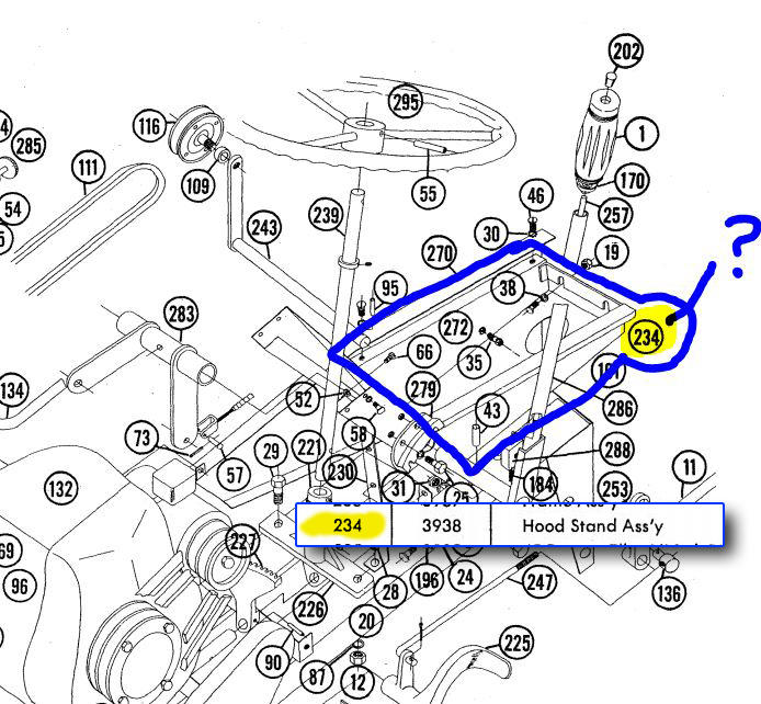

UncleJerm76 103 #1 Posted October 30, 2017 (edited) What is that boxed-in area called in the 701... the one that has the cut out for the shifter? Its almost like a second tool box - I call it the "Shifter Box" Mine has several rust holes and Id like to replace it but does it bolt to the frame from somewhere or is it actually part of the frame? In the parts diagram, as best I can tell it appears separate, although I cant figure out how it comes apart. It looks to me like its #234 on the part diagram and that part is listed as the "Hood Stand Assembly" ...weird name for a part so far away from the hood. I like "Shifter Box" much better ...any help on how to replace it, or repair it OR simply the best thing to call it when asking for the part in the classified would be greatly appreciated! Edited October 30, 2017 by UncleJerm76 Share this post Link to post Share on other sites

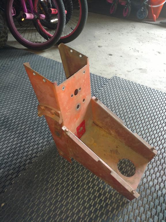

Chris G 3,401 #2 Posted October 30, 2017 This pic should explain the piece your talking about. 2 Share this post Link to post Share on other sites
UncleJerm76 103 #3 Posted October 30, 2017 (edited) Thank you sir that’s a huge help! My 701 looks slightly different from this model but after seeing your pic, the name “Hood stand assembly” makes so much more sense now ...and I can see where it comes apart ...and how much of a bear it’s going to be ...I still think “Shifter Box” has a better ring to it! Thanks for your reply! Question: Does it also need removed to replace the Shift Boot? Edited October 30, 2017 by UncleJerm76 Grammar Police Share this post Link to post Share on other sites
Chris G 3,401 #4 Posted October 30, 2017 Ya that one is off a 702 and I've replaced shifter boots with out removing it. Share this post Link to post Share on other sites
