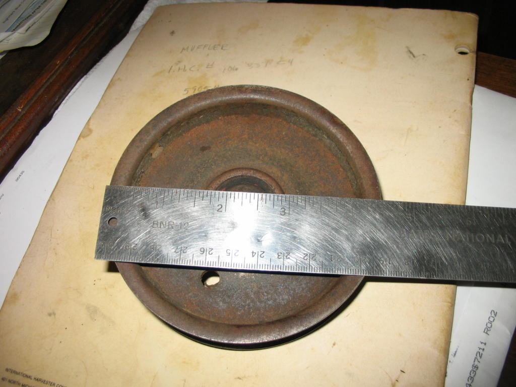

daveoman1966 3,610 #2 Posted October 29, 2017 How does $57 bux for BOTH of them sound.(25 EACH)..SHIPPED... used, of course, but not abused.... here is a pic of one of them. #112791 Share this post Link to post Share on other sites

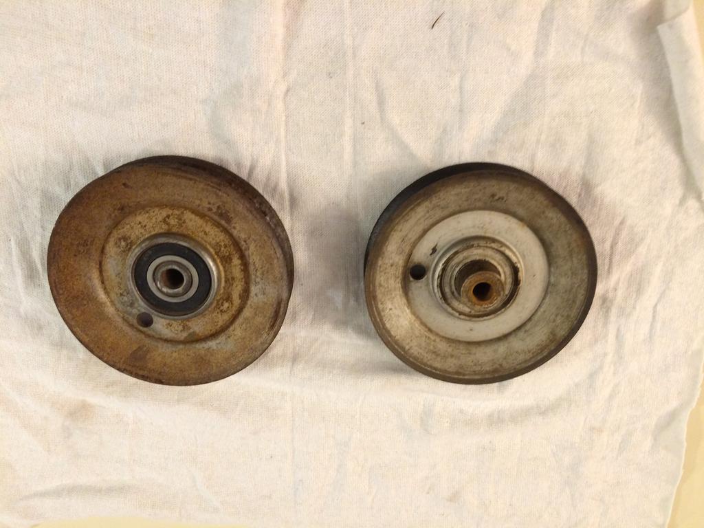

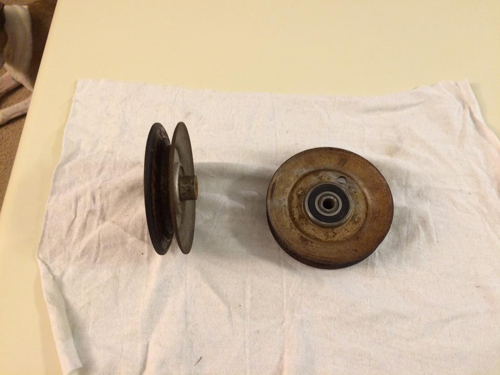

Lee1977 6,216 #3 Posted October 29, 2017 (edited) I don't know what model deck you have. It's my understanding that the 37" decks came with two different belts according to the models. Some had double "V" belts and some had standard "V" belts with a flat back. That could be the reason there are two idlers listed. As with all other Wheel Horse equipment model number might not tell what you have with idlers and belts being changed over the last 29 years. Edited October 29, 2017 by Lee1977 1 Share this post Link to post Share on other sites
gwest_ca-(File Mod) 10,491 #4 Posted October 29, 2017 The six-sided belt on the 05-37SC01 uses two of 104974 replaced by 92-7103 front V-idler mule pulleys - 4-1/4" OD. If there is one flat and one V-idler it has been changed to what the 05-37SC02 used. The 111170 is a V-idler on the deck and 2 used on the 05-37SC01 if it still uses the 6-sided belt. The 112791 is a left flat-idler on the 05-37SC02 deck using flat-idler 119130 on the right. Garry Adding I see what they have done. The online parts lists for both the 05-37SC01 and 05-37SC02 show all the pulleys for both decks. Makes it very confusing. Share this post Link to post Share on other sites
clueless 2,898 #5 Posted October 29, 2017 Ok, both are V belt pulleys. Share this post Link to post Share on other sites
clueless 2,898 #6 Posted October 29, 2017 3 hours ago, gwest_ca said: The six-sided belt on the 05-37SC01 uses two of 104974 replaced by 92-7103 front V-idler mule pulleys - 4-1/4" OD. If there is one flat and one V-idler it has been changed to what the 05-37SC02 used. The 111170 is a V-idler on the deck and 2 used on the 05-37SC01 if it still uses the 6-sided belt. The 112791 is a flat idler Garry Adding I see what they have done. The online parts lists for both the 05-37SC01 and 05-37SC02 show all the pulleys for both decks. Makes it very confusing. Garry, thanks, once again your spot on, I need two 111170 pulleys. Share this post Link to post Share on other sites
gwest_ca-(File Mod) 10,491 #7 Posted October 30, 2017 10 hours ago, clueless said: Garry, thanks, once again your spot on, I need two 111170 pulleys. Have in my notes this 111170 pulley has a 4-1/2" OD. Is that correct? Garry Share this post Link to post Share on other sites

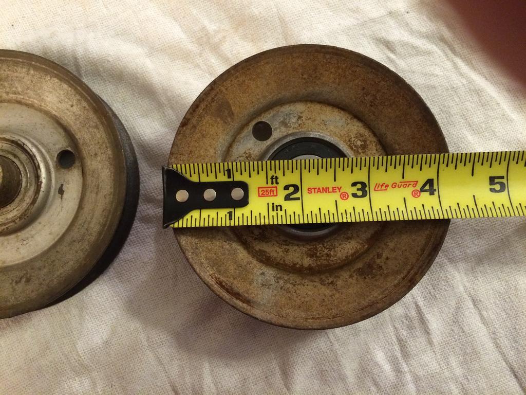

clueless 2,898 #8 Posted October 30, 2017 10 hours ago, gwest_ca said: Have in my notes this 111170 pulley has a 4-1/2" OD. Is that correct? Garry Gary, the pulleys are 4-1/4" OD with 3/8" ID bearing. The overall height 1-1/8" with the pulley sitting on the extended end of the bearing. Did a little research, looks like I'm going to have to buy the Toro part. Jack's got them for $60 plus shipping, Killian's $73 plus shipping. Looks like with the two pulleys, a new belt, and some welding I'll be into this things for over $200. Wasn't my plan, but I'm sure it will last another 30 years. The 111170 is the right pulley, there are two of them for this deck. They are both V-idlers. Share this post Link to post Share on other sites
