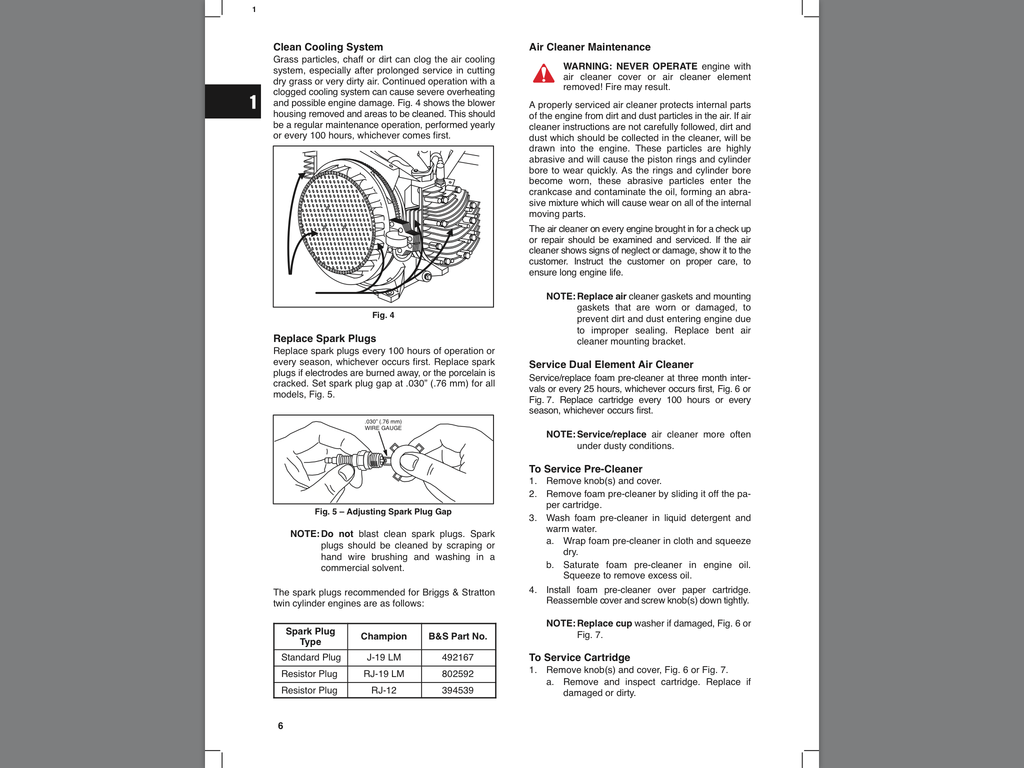

aHorseofCourse 261 #3 Posted October 29, 2017 You would need 864 'B' or 'C' if you are putting on the '300' muffler. The 'C' screws into the pipe threads in the block and 'B' has a flange that bolts into the threaded holes along side the exhaust port. Not sure you will be able to find any of them tho. I looked for some last year and struck out so you might have to get creative. Also, the steel exhaust tends to weld itself into the aluminum block so be careful taking old one out, if you can get them out at all. Spark plugs, I used Briggs part number 796112. Here's the numbers in the manual. 1 Share this post Link to post Share on other sites
