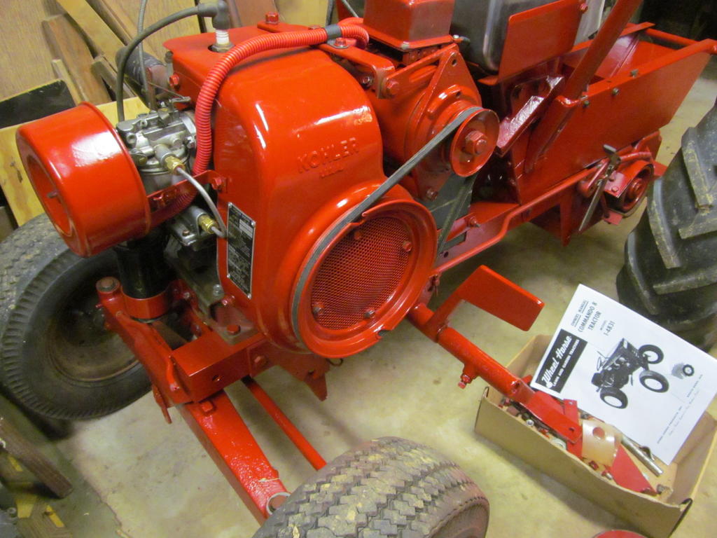

Rustyred 63 #1 Posted October 28, 2017 Hello, I'm repainting both tractor and Kohler engine. 1979 C-81. My question is can you paint a carburetor? Currently it is kind of half painted with a very light coat over some of it. I don't want mine to look half baked. Can I paint or is it okay to leave no paint on? Thank you again for your needed advice. Rustyred Share this post Link to post Share on other sites

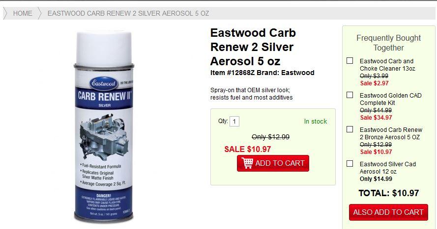

pfrederi 21,145 #3 Posted October 28, 2017 I used some of this Eastwood carb paint. Looked nice and has held up for a year or so. They have a bronze version but his looks more original to me. 3 Share this post Link to post Share on other sites
Rustyred 63 #4 Posted October 28, 2017 Both great input. Good to know I have a couple options. Is the Eastwood paint a certain color made by wheel horse or Kohler or what are you referring to? Share this post Link to post Share on other sites

953 nut 69,103 #7 Posted October 28, 2017 2 hours ago, Rustyred said: Is the Eastwood paint a certain color made by wheel horse or Kohler Eastwood is a retailer of fine quality automotive tools and restoration supplies. I have been doing business with them for 30 years or more. http://www.eastwood.com/ 2 Share this post Link to post Share on other sites

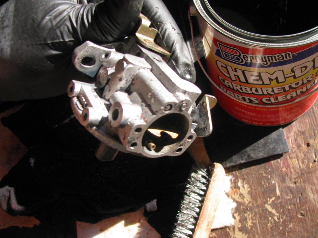

WHX?? 58,048 #15 Posted October 29, 2017 You drop a stripped carb into Berryman's and fer sure you're gonna lose the paint. Just my 02 but I personally do not care if the the carb is original or in red as long as it carburats! Alway thought it would be cool to have a polished & highly detailed one on a trailer queen. BTW those are fine lookin motors Jack & Ed... 3 1 Share this post Link to post Share on other sites

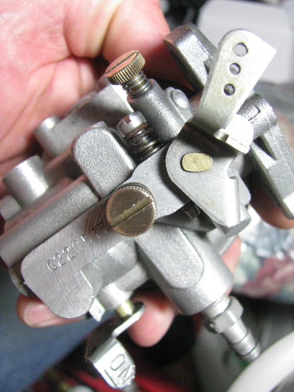

Shuboxlover 490 #18 Posted October 30, 2017 I have used a fine wire wheel on my grinder to clean them up, makes the aluminum shine pretty good and the brass adjustment needles almost look polished. 1 Share this post Link to post Share on other sites

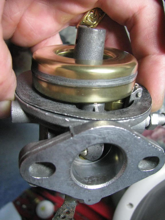

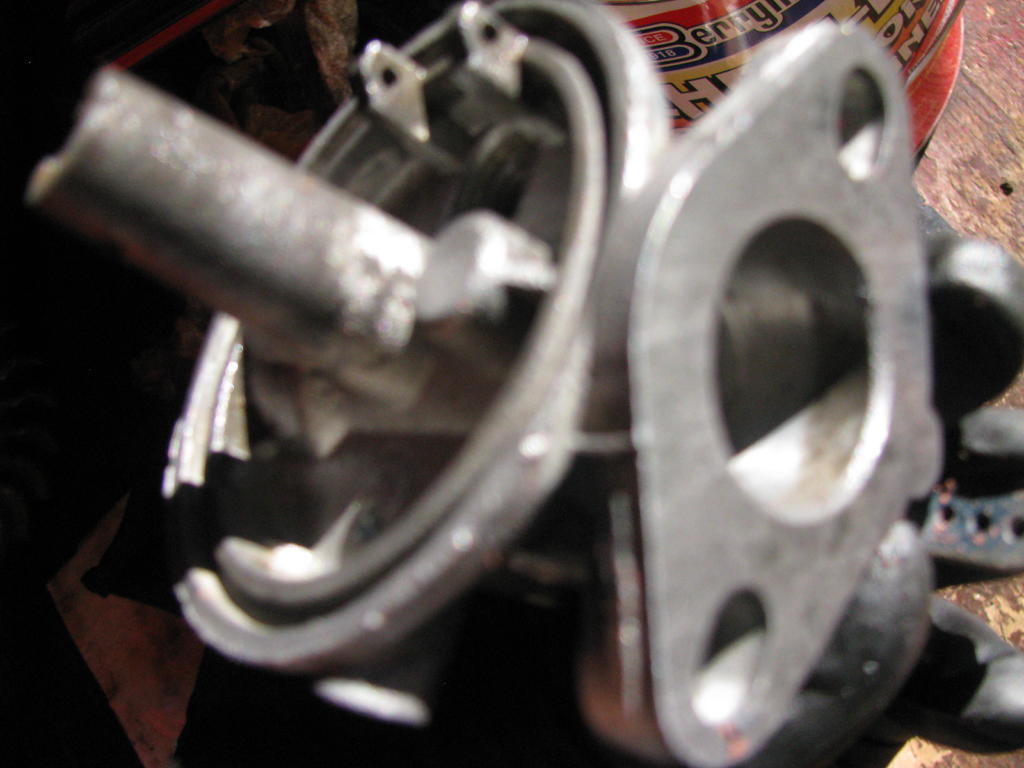

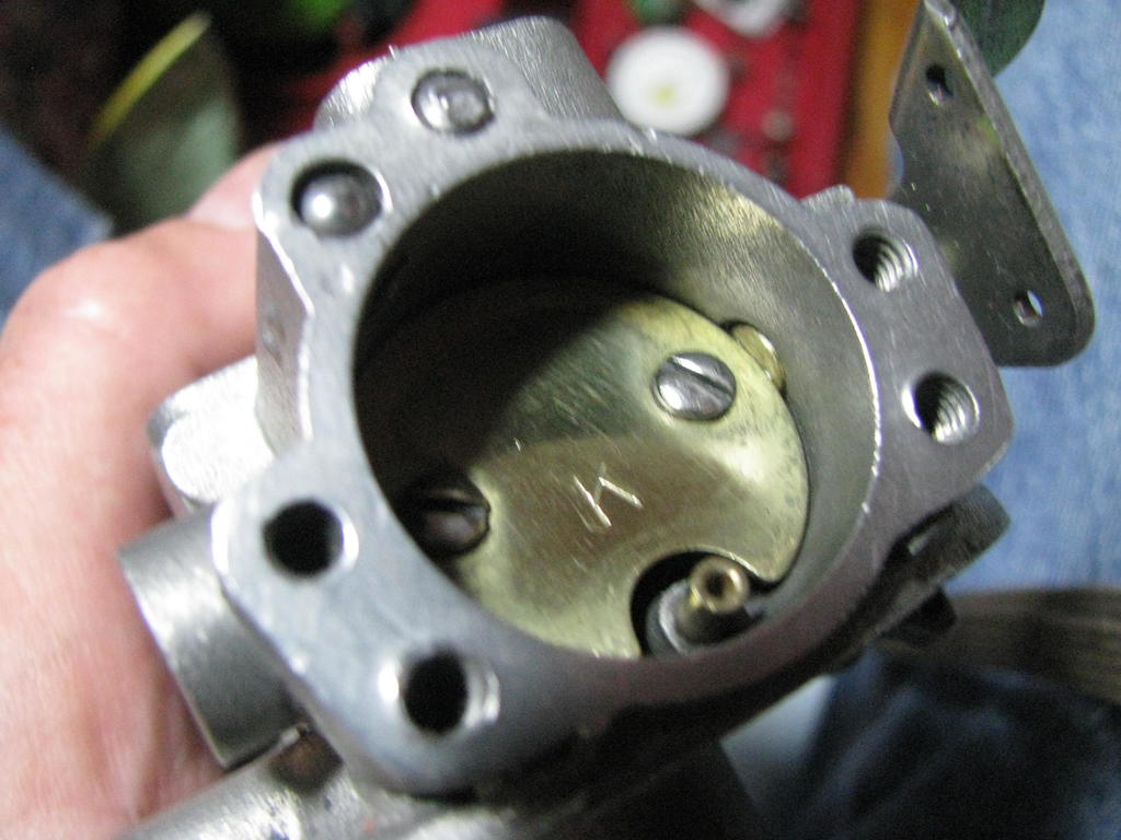

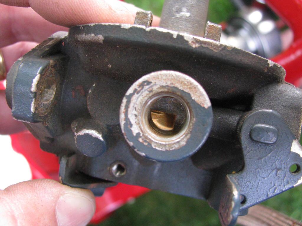

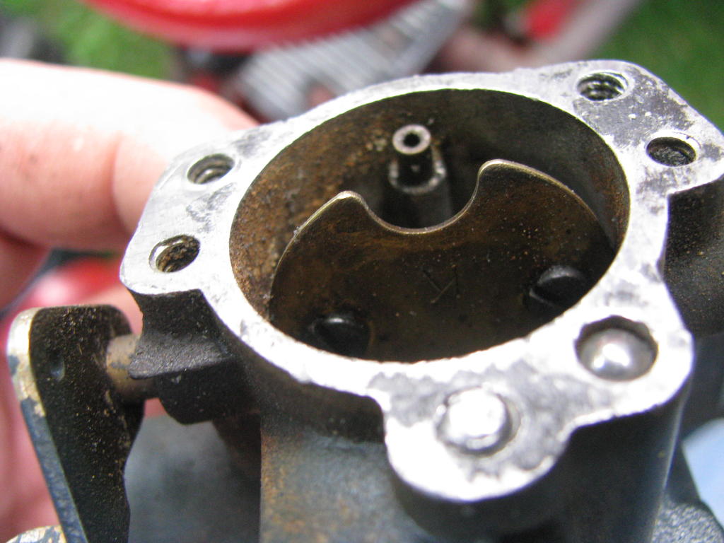

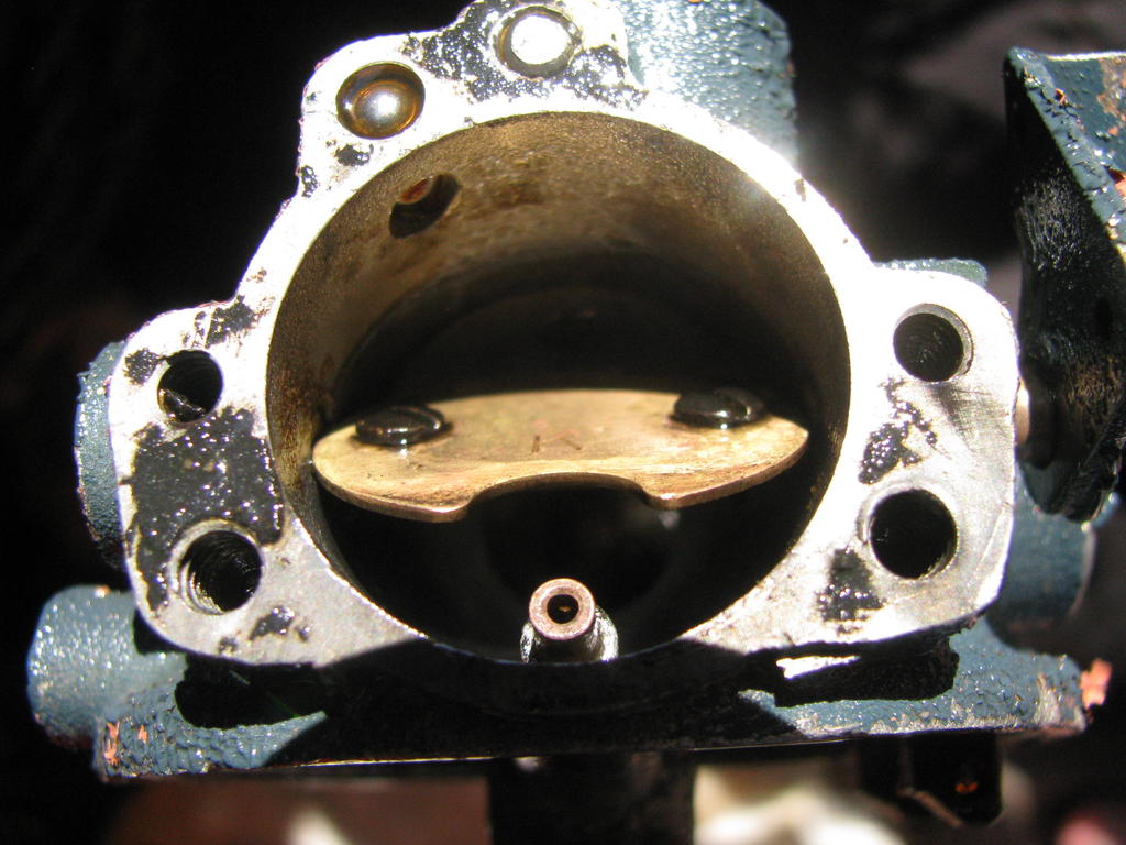

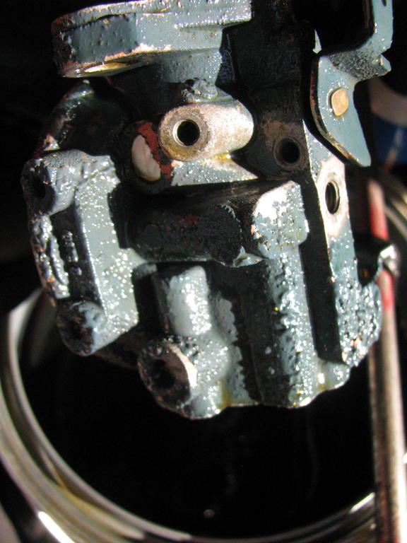

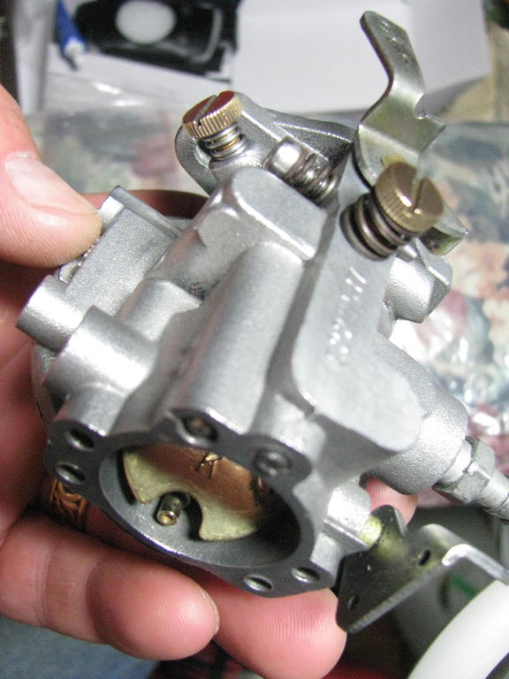

AMC RULES 37,259 #19 Posted October 30, 2017 Then, a quick polish using Mothers mag&aluminum polish... will keep 'em looking that way for the long term. Here's the before, and afters... 3 5 Share this post Link to post Share on other sites
