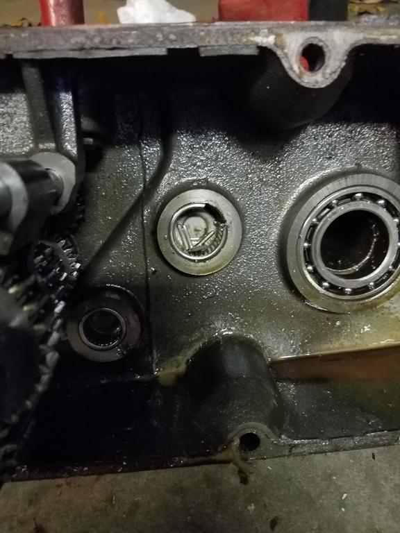

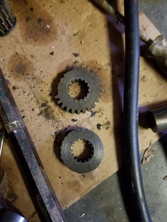

Crawler 6 #1 Posted October 28, 2017 I have a 73 wheel horse 10 that the axle gears sheared and cannot find gears to replace, it has 1" axles so i found some on ebay but gears are too small, any help is appreciated 1 Share this post Link to post Share on other sites

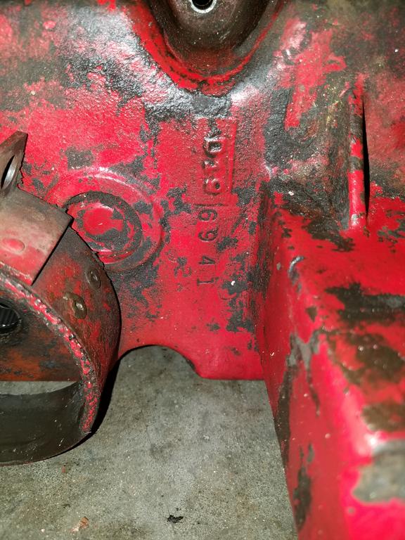

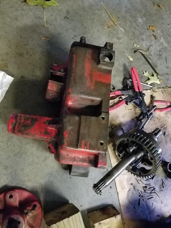

wedge 80 #3 Posted October 28, 2017 Can you post pic's of the trans ? I have some of them apart but need to know what trans you have. If I see it I will know if I have what you need. 1 Share this post Link to post Share on other sites

gwest_ca-(File Mod) 12,519 #5 Posted October 28, 2017 Automatic hydro transmission or 8-speed? Garry Saw your other post. This should be the parts list for your transmission. Looks like the part number is 3908 http://www.partstree.com/parts/toro/parts/3908/ Garry 1 Share this post Link to post Share on other sites
Crawler 6 #6 Posted October 29, 2017 Also need this needle bearing or part number for motion industries is anyone has it 19 hours ago, wedge said: Can you post pic's of the trans ? I have some of them apart but need to know what trans you have. If I see it I will know if I have what you need. Posted pics Share this post Link to post Share on other sites
wedge 80 #7 Posted October 29, 2017 I found a Hole trans on e,bay like yours for $199.or Best offer . The ad #: is 122750004120 Maybe it is the way to go ? I looked and I don't have one . Hope this helps 1 Share this post Link to post Share on other sites
stevasaurus 23,861 #8 Posted October 29, 2017 That particular needle bearing is called a cap bearing. WH #1532 crosses to KOYO # M-16121 Motion Industries catalog # 00090903. Those axle gears should not be hard to find. 1 Share this post Link to post Share on other sites

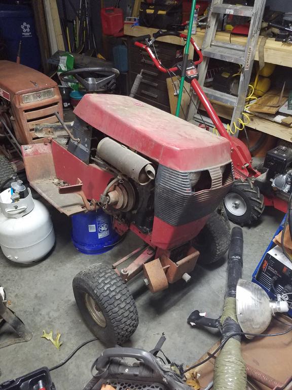

Crawler 6 #9 Posted October 30, 2017 9 hours ago, stevasaurus said: That particular needle bearing is called a cap bearing. WH #1532 crosses to KOYO # M-16121 Motion Industries catalog # 00090903. Those axle gears should not be hard to find. Thank you sir! Update, found a donar tractor had to swap a few minor thing to make it work but it had the exact tranny! Put back together changed fluids and mowed the grass great day!! Have more donar parts if anyone needs them, thanks all for the help! 1 Share this post Link to post Share on other sites
