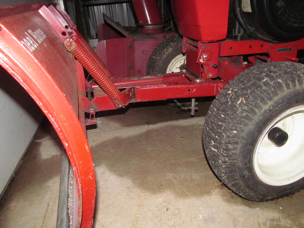

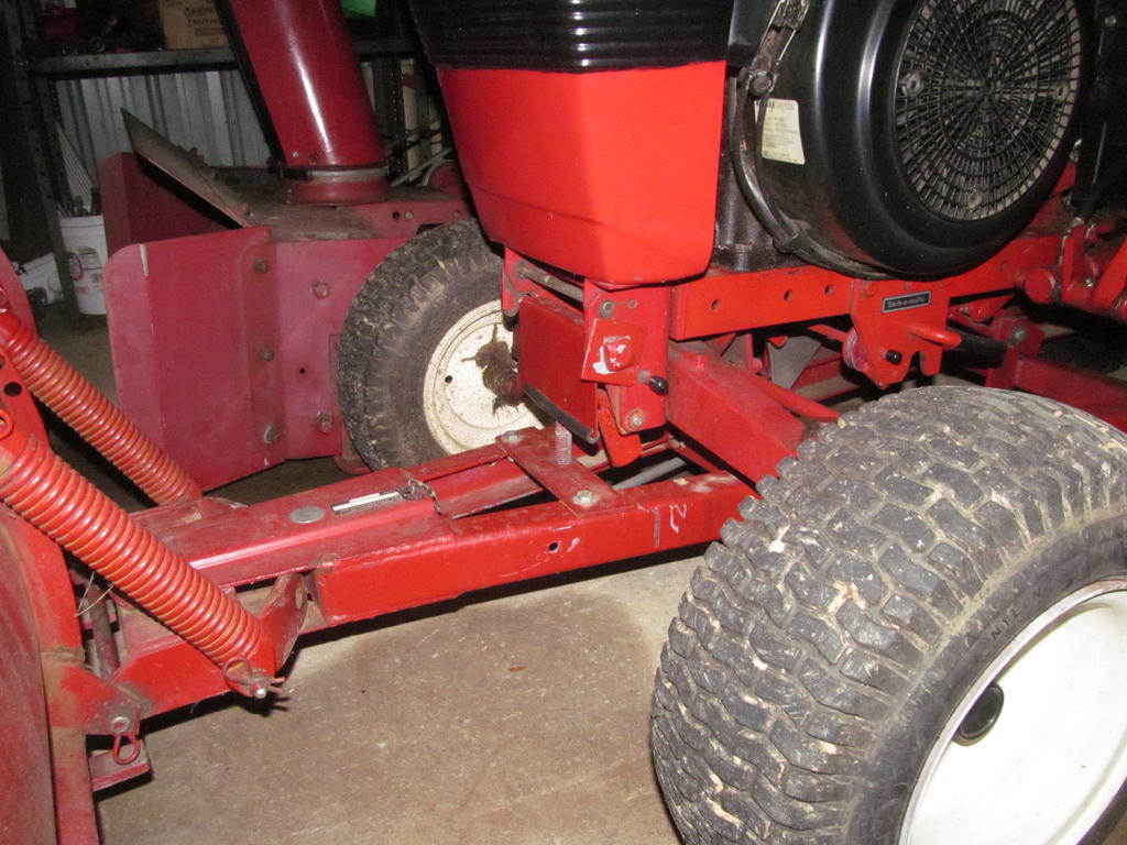

Sarge 3,473 #15 Posted October 28, 2017 4 hours ago, squonk said: I'm worse off. I have no welder. Have no talent. And my eyesight is so bad I can't see well enough behind a shield. But I do have a torch! Get an Optrel Vegaview 2.5 - I'm pretty blind (if I drop my glasses I can't find them , not kidding) but can tig and stick weld with that hood all day long . It uses a true color lens and a light state of 2.5 - lowest in the industry and it does not use a green or blue tint - which is rough on your eyes anyway . It should be quite easy to make a new mount for the Cub - I always hated how their implements hook up and wondered why their customer base tolerated such a rotten design . Friends of mine have them - they see how easy the WH system is they can't believe it ., lol . Sarge 3 Share this post Link to post Share on other sites

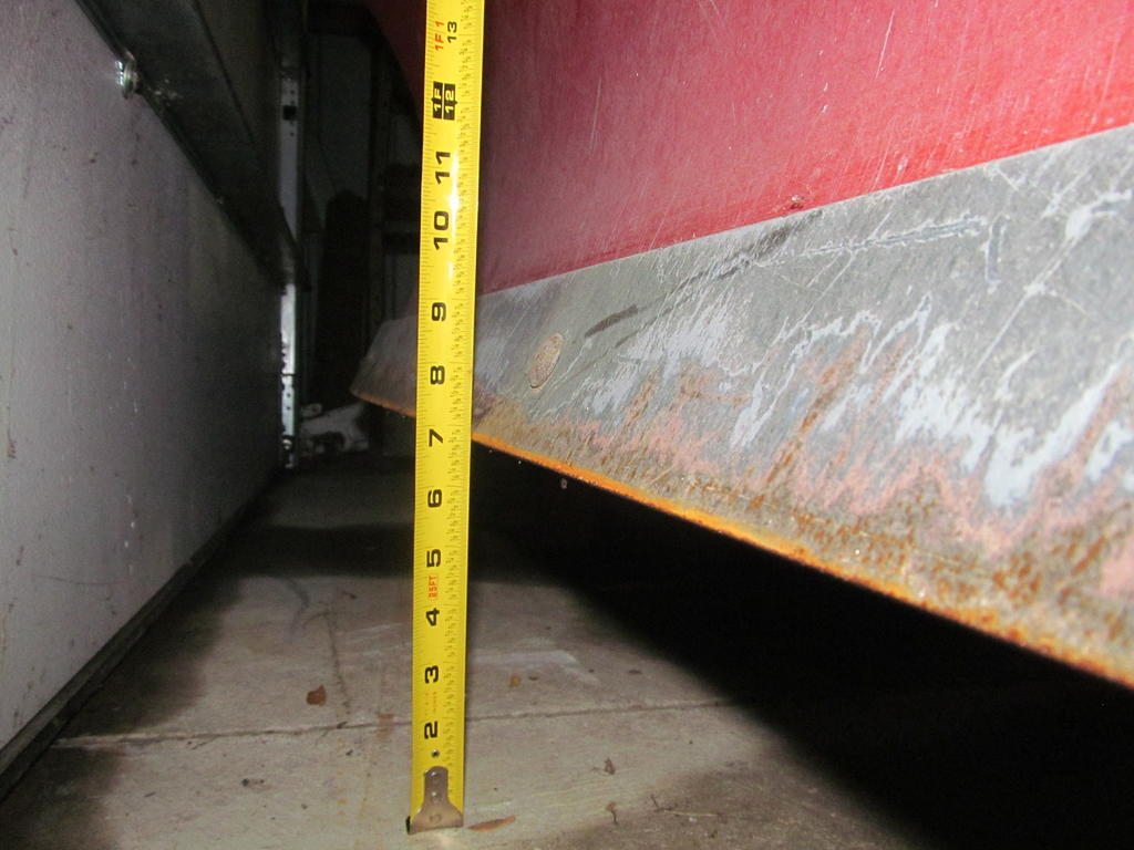

WVHillbilly520H 10,379 #18 Posted October 29, 2017 9 hours ago, Sarge said: It should be quite easy to make a new mount for the Cub - I always hated how their implements hook up and wondered why their customer base tolerated such a rotten design . Friends of mine have them - they see how easy the WH system is they can't believe it ., lol . Sarge I agree the snow blades were a bit of a PITA but the front blade on my dad's 1200 will lift a good 6"+ off the ground at the wear edge vs the 3-4" of our beloved WH, also the rear clevis hitch is/was of a better design with more lift capability and adjustability, just my personal experiences, Jeff. Share this post Link to post Share on other sites
Sarge 3,473 #19 Posted October 29, 2017 22 hours ago, squonk said: But what about my lack of talent? Send me a plane ticket , or head West - I can teach anyone to weld . All of my WH plows will lift at least 8" off the ground easily - make sure your rear axle bracket is spaced low enough below the trans - some of them seem to sit higher and that affects how high the blade lifts . The center rock shaft linkage also comes into play in a big way as well as which front axle you have . The only ones I know of that lift the blade quite low are the manual lift C-series due to how it's rock shaft arm works with the blade . When pushing snow I can use the hydro lift on any of mine to make snow ramps to pile the snow higher and keep it out of the main yard to avoid having to clean up so much rock from the parking lot . I think the Cub and Deere guys were the originators of using "one tractor for each attachment" due to their difficult to swap attachments and how the tractors were designed . Sarge Share this post Link to post Share on other sites

WVHillbilly520H 10,379 #22 Posted October 29, 2017 5 hours ago, Sarge said: All of my WH plows will lift at least 8" off the ground easily - make sure your rear axle bracket is spaced low enough below the trans - some of them seem to sit higher and that affects how high the blade lifts . The center rock shaft linkage also comes into play in a big way as well as which front axle you have . The only ones I know of that lift the blade quite low are the manual lift C-series due to how it's rock shaft arm works with the blade . When pushing snow I can use the hydro lift on any of mine to make snow ramps to pile the snow higher and keep it out of the main yard to avoid having to clean up so much rock from the parking lot . Sarge The blade frame will only come up as far as the front axle on matter how low the rear axle bracket is attached, more than I on RS have complained about the low lift height of the snow plows on the B,C,3,4,500 series(especially the 520 with swept forward axle and lower tie rod mounts when turning they come in contact with the blade frame) where as the CC actually pivots in front of the axle and is lifted from a point beyond on the A frame then to a rod the rockshaft or lift arm thereby allowing a higher lift height, and again my personal experiences, Jeff....https://youtu.be/fDP6YIahI9s Share this post Link to post Share on other sites
Ed Kennell 47,618 #23 Posted October 29, 2017 To get more plow lift on my 312 H, I removed the 6 " wheels and installed 8" leaving the long spindles in place. This raised the front axle almost 2". I also made an anti-sway/lift stop that stops the blade just before it hits the front axle. I also use this to limit the low position for plowing the stone road. With this arrangement, I get 7" lift. Jeff is correct, the front axle limits the max plow height. Sarge is also correct, by lowering the rear of the frame, the plow will lift higher, but only by 1/2 the amount you lower the rear. 4 Share this post Link to post Share on other sites

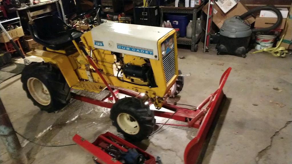

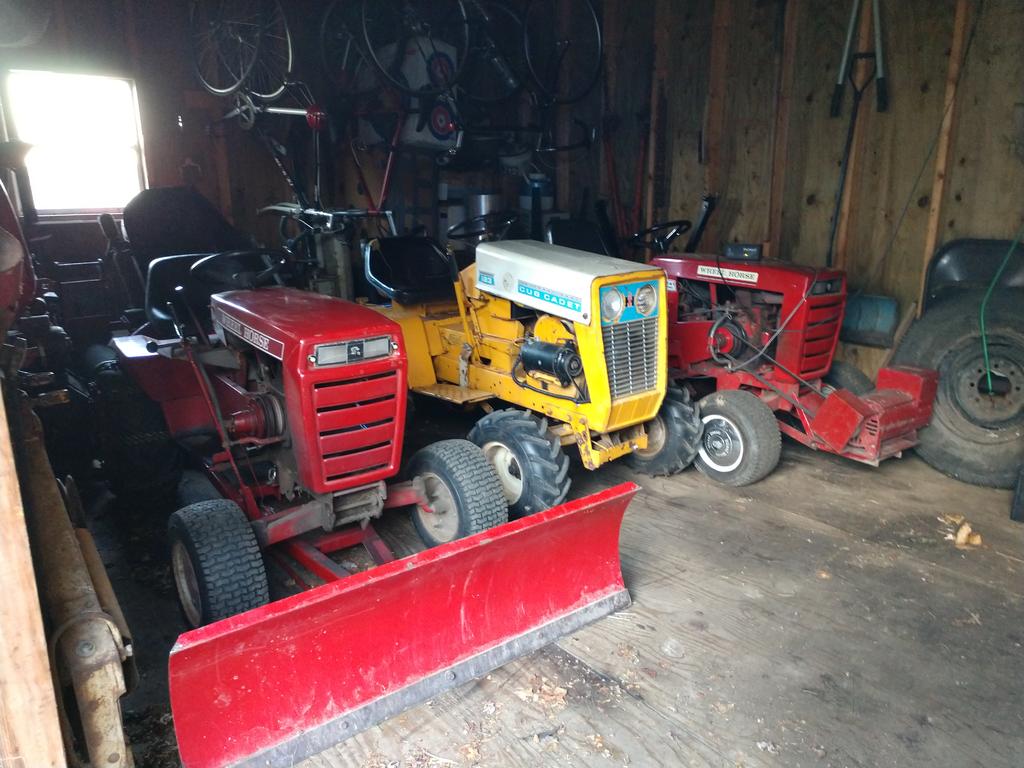

brian_32 9 #24 Posted October 30, 2017 Well, after thinking it over, and a drive around the yard on the Cub, I made the smart decision. The AG tires are off the Cub and on the Wheel Horse, and the plow is where it belongs. All dressed for winter. 4 Share this post Link to post Share on other sites
