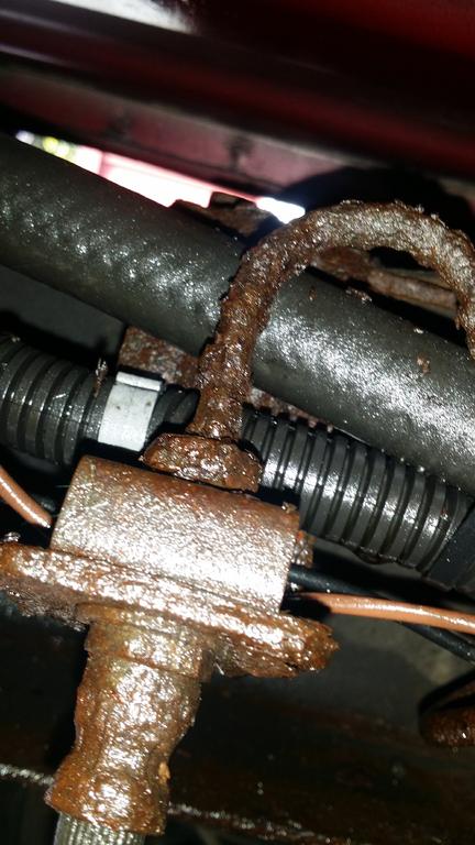

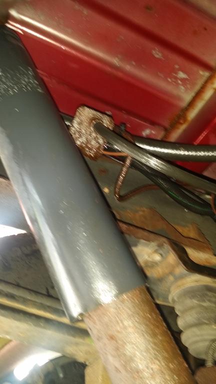

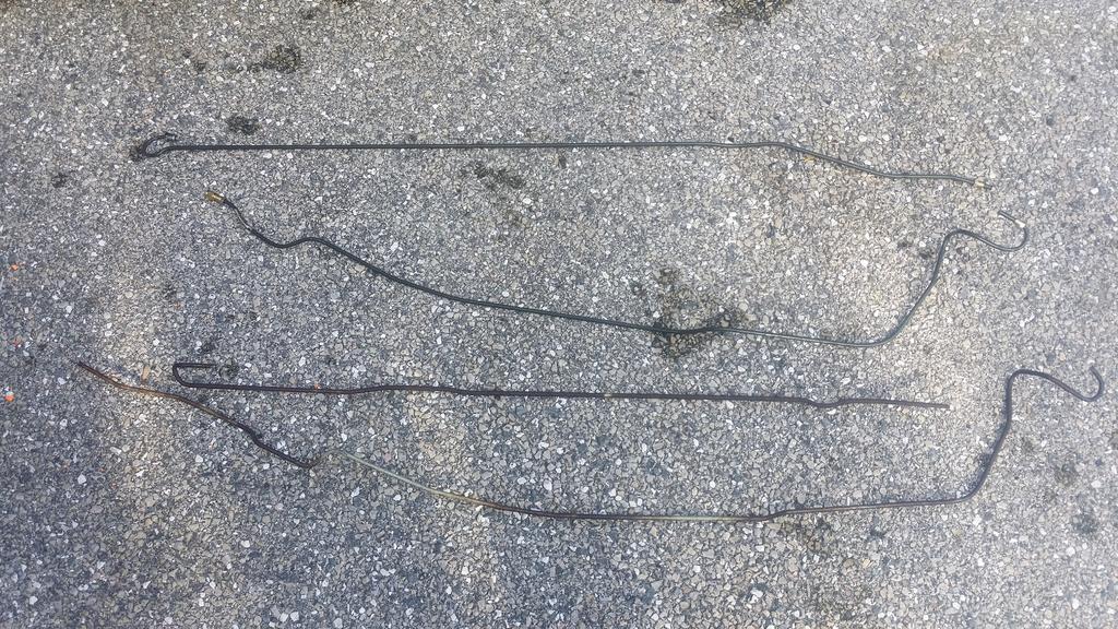

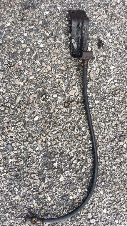

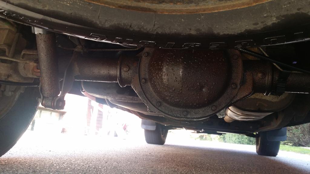

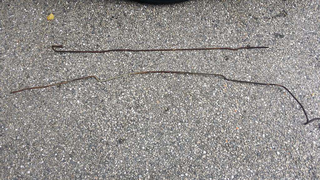

cafoose 3,635 #1 Posted October 27, 2017 After picking up my C-161 on Wednesday I didn't have time to take it off my truck before work. I was driving to work and a car stopped suddenly in front of me. I hit my brakes hard and the pedal went almost to the floor. Then the brake light came on and the "service brake" alert on the dash came on. I got to work and saw brake fluid all over the rear axle. I checked later and found a brake line rusted through and was leaking I drove home carefully at the end of my shift and the next day (Thursday) I removed the brake line. I had to remove the hose from the rear where it connected to the lines going to each rear wheel and the upper bracket where the broken line connected. Then I had to cut the broken line at the fitting and use a six point socket to remove it from the hose fitting. Then I cut the line in the middle and removed it from behind the gas tank. I went to NAPA and they made me a two piece line with the proper bends so I could install it without removing the gas tank. It got late so I will install it when I get up in the morning. Maybe if all goes well I can play with my C-161 soon Share this post Link to post Share on other sites

Ed Kennell 45,028 #7 Posted October 27, 2017 6 hours ago, cafoose said: That definitely looks like all lines should be replaced Chuck. Scary story, glad you avoided the crash. 2 Share this post Link to post Share on other sites
cafoose 3,635 #8 Posted October 27, 2017 9 hours ago, craftsmanmowerfreak said: well atleast you made it home safe. i went through similar thing a few weeks ago on spot (1993 chevy 1500) but with it the metal end of rubber line that connects to calipor rotted out and was leaking. never seen that one before. well has always the metal line from splitter to rubber line broke too when removing rubber line so had to replace that too. was not fun. I had the same problem with the lower end of the hose on the rear where the steel lines connect to the block. One fitting came off good but the other one was rusted to the line and wouldn't turn without twisting the line so I soaked it with kroil and worked it back and forth until it broke free and I saved the line 5 hours ago, KC9KAS said: The local auto repair shop told me that the "beet juice" used on the roads as a "pre-treatment" for snow is really hard on brake lines. The Chevrolet dealer has a complete brake line replacement kit for around $100....BUT the cab is supposed to come off to install the lines, so add $500-$600 to the cost. A fellow at work did tell me that he and a friend did manage to get all the new lines replaced without cab removal but it was tough! 3 hours ago, 953 nut said: One line rusted through is a precursor of others that will fail if not replaced. The snow melting chemicals that are used have been a problem for ever, you would think the auto industry would have gone to Stainless Steel lines years ago. 3 hours ago, Ed Kennell said: That definitely looks like all lines should be replaced Chuck. Scary story, glad you avoided the crash. https://www.consumeraffairs.com/news/feds-end-gm-brake-line-rust-probe-advise-owners-to-wash-underneath-their-cars-and-trucks-040915.html Seems like a common problem with GM trucks I do need to check and replace all the corroded brake lines I would gladly pay a little extra for the truck if they manufactured it with stainless steel brake lines. 4 Share this post Link to post Share on other sites
