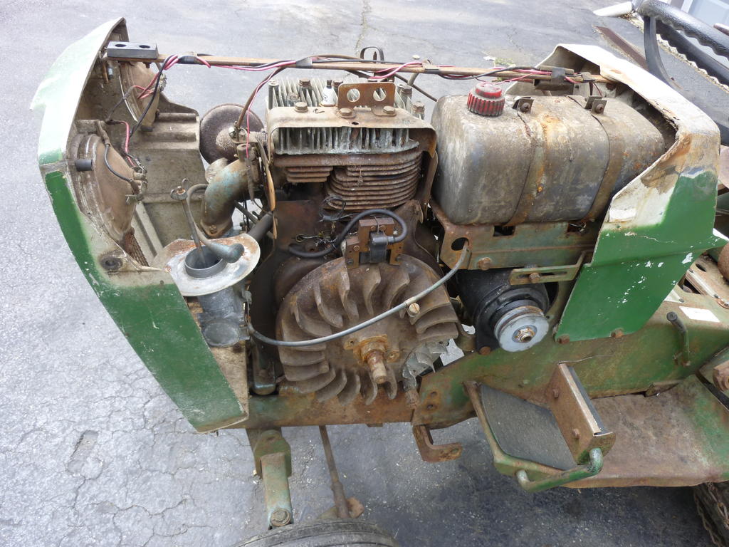

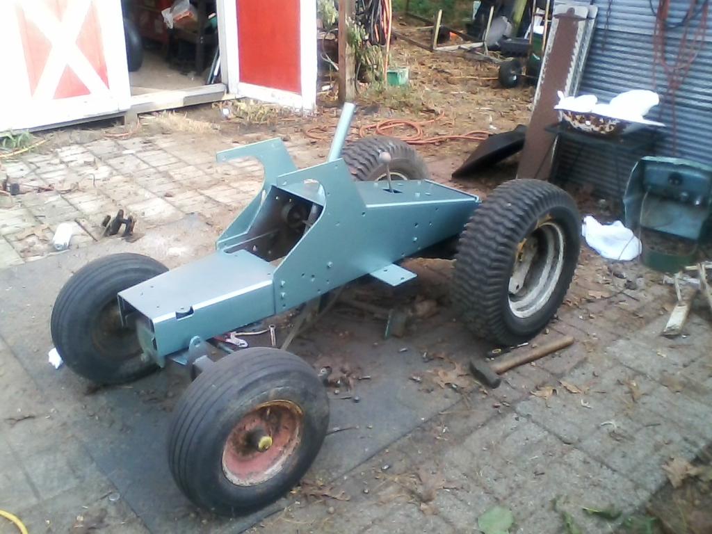

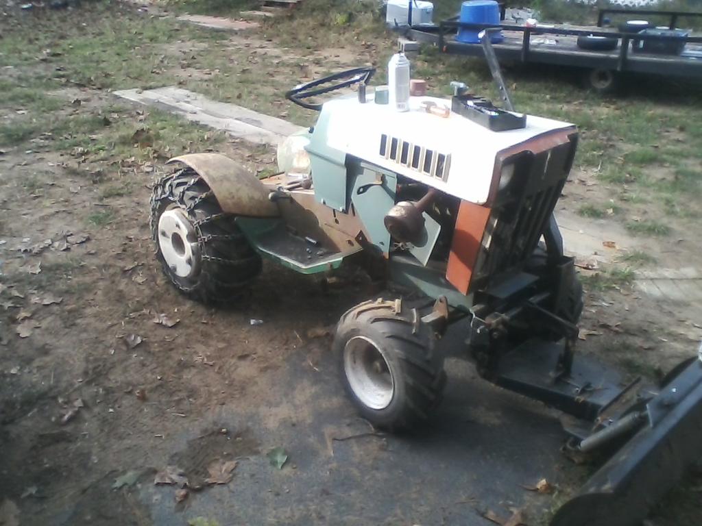

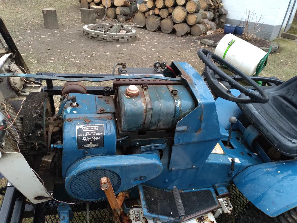

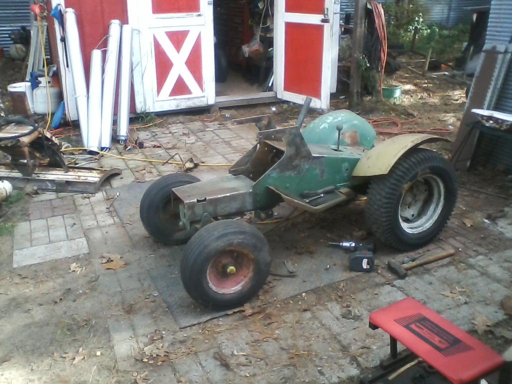

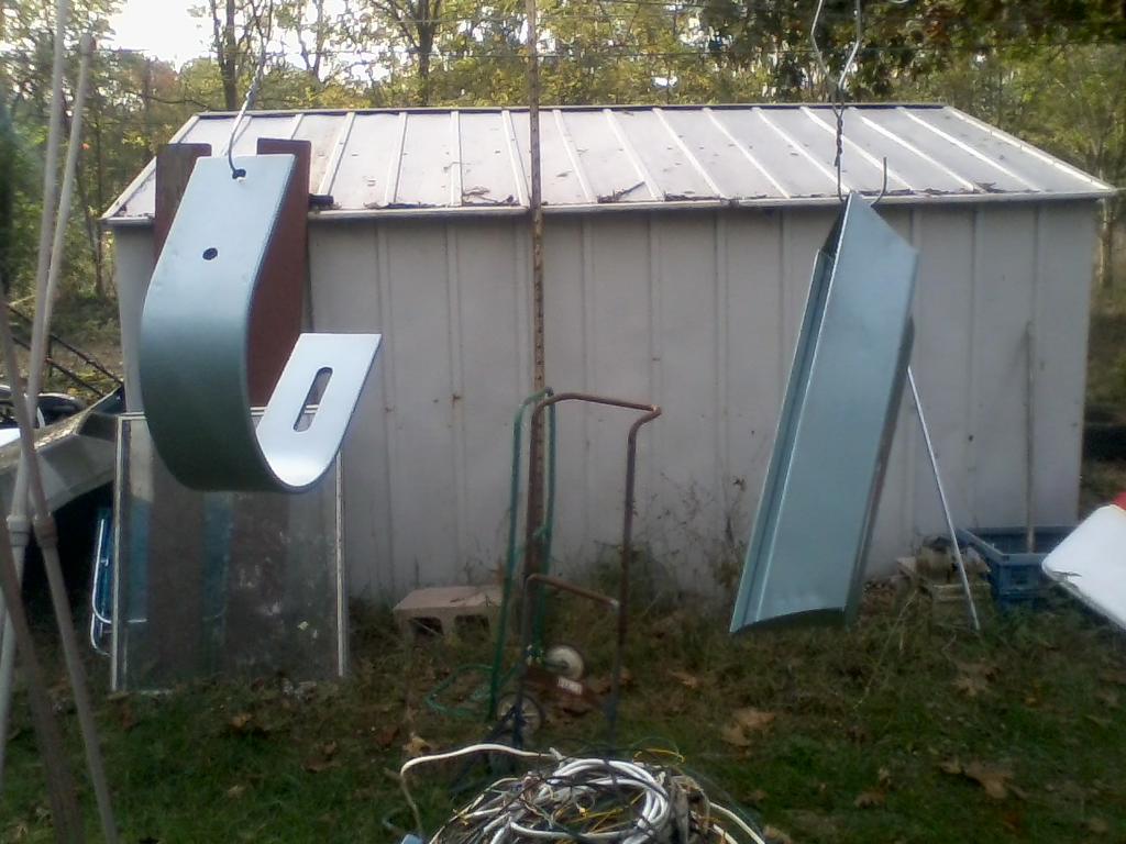

Elkskin's mower junkyard 1,117 #1 Posted October 27, 2017 So i been working my 1971 Sears suburban 14 to death. well i been noticing that the plow has never really lifted high on it. so i got to looking and seen my mule drive slot is ate up. this tractor seen no mowing. just plowing snow moving dirt and use of 3 point ever since new according to previous owners. so i had a spare tractor laying around that i picked up a couple years ago. a early model 1971 sears ss14. so i took it apart and am in process of taking the subuirban 14 apart. and just to get some of the jd green someone put on it off i am repainting the tractor. it wont be a perfect job just something to make it look better and protect it through winter since it will be my main plow machine. the way i have the sears suburban setup its a beast in snow but i will put the turfs back on i think (a set of 23-9.50-12 sears turfs from a retired sears). Now i got 2 style of plows. the black plow in picture is newer style for sears suburbans and it is not has strong has the older plows. the older nontrip plow i do not like running in winter time. but i did crack a weld on that plow for like the 3rd time lol. tomorrow i hope to paint footrests, front axle, mule drive cover, grill. then possibly saterday or sunday start assembly. 3 Share this post Link to post Share on other sites

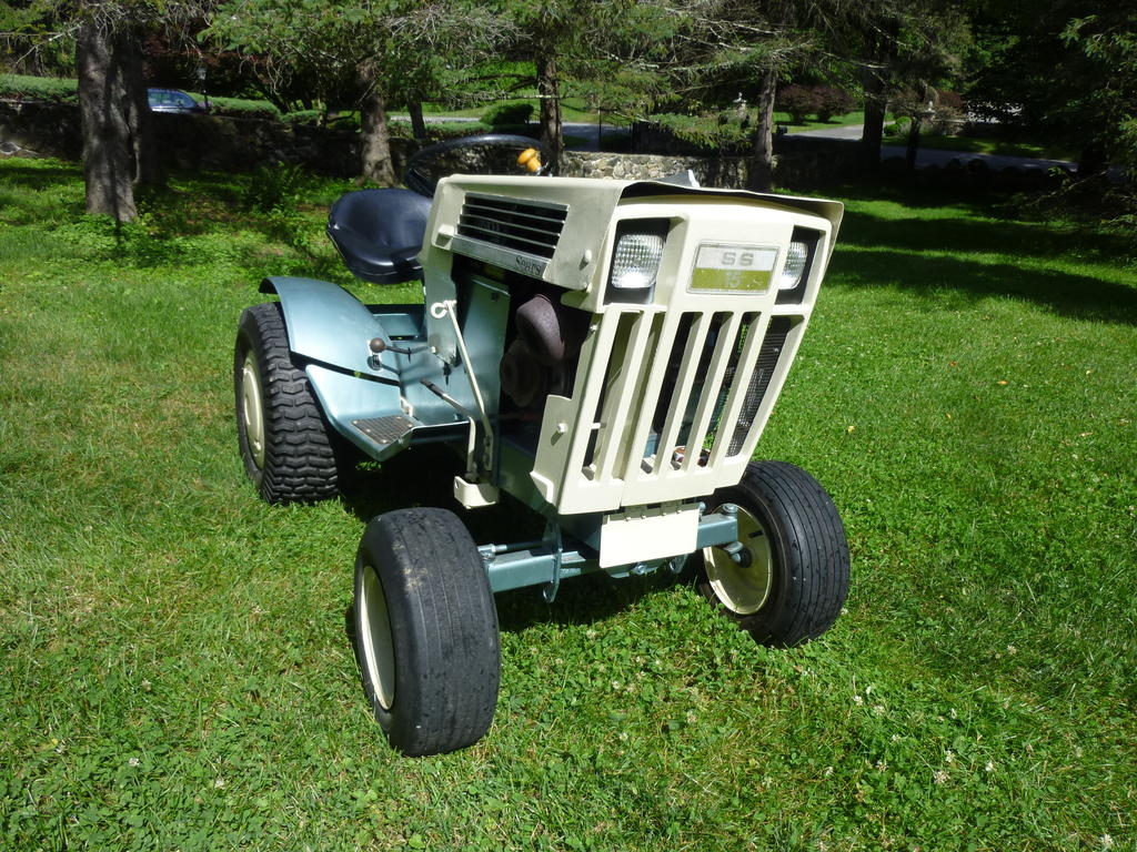

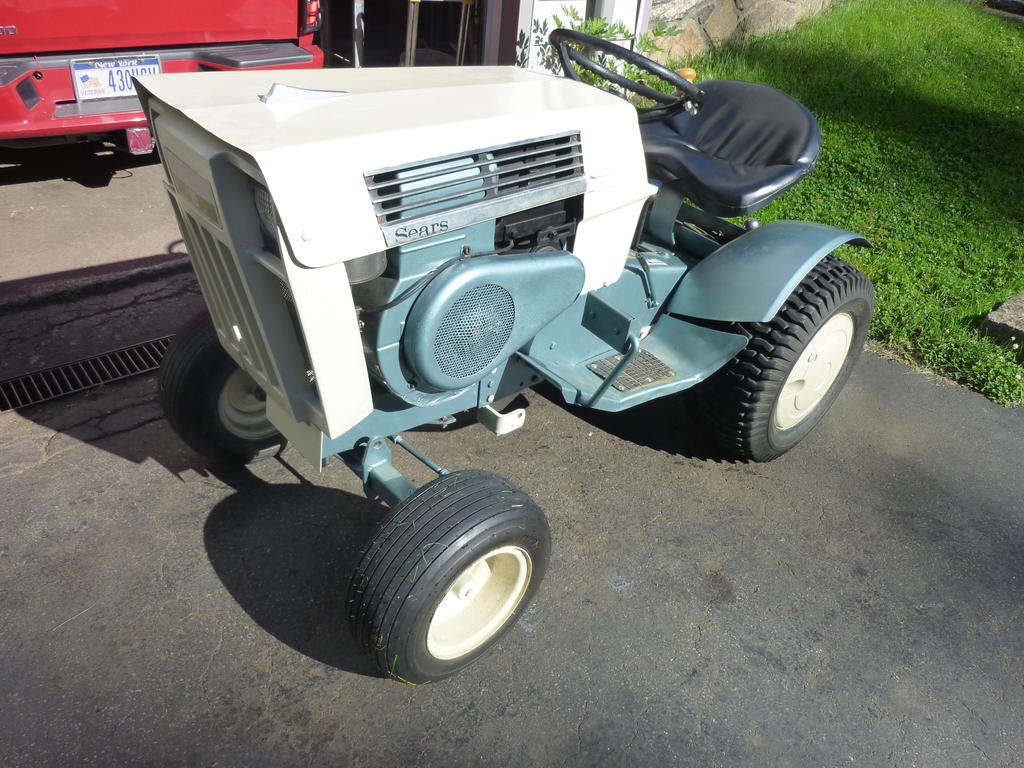

Elkskin's mower junkyard 1,117 #4 Posted October 27, 2017 (edited) 2 hours ago, Rob R said: Nice work let me know if you have questions or perhaps need some parts, I have rebuilt at least four of them. Latest was the SS15. I also rebuild the drag links (steering mechanism) as they are probably the most likely item to fail. dang. eventually i will be looking for another set of fenders. but that will be a while. heres a 1972 suburban 15 i done a few years ago. One thing i didnt like about this paint job is the white on hood runs when it gets wet. sooooo i will stay away from the touch n tone paint lol Edited October 27, 2017 by craftsmanmowerfreak 1 Share this post Link to post Share on other sites
Rob R 989 #5 Posted October 28, 2017 22 hours ago, craftsmanmowerfreak said: dang. eventually i will be looking for another set of fenders. but that will be a while. heres a 1972 suburban 15 i done a few years ago. One thing i didnt like about this paint job is the white on hood runs when it gets wet. sooooo i will stay away from the touch n tone paint lol I have a spare set of fenders would have to dig them out and see what shape they are in.... if I remember correctly not too bad. p.s. I use almond rustoleum for all my white areas.... I brush-on a base coat let it dry a bit and then topcoat with the matching color via rattle can.... works wonderful and lasts a long time Share this post Link to post Share on other sites
Elkskin's mower junkyard 1,117 #6 Posted October 28, 2017 4 hours ago, Rob R said: I have a spare set of fenders would have to dig them out and see what shape they are in.... if I remember correctly not too bad. p.s. I use almond rustoleum for all my white areas.... I brush-on a base coat let it dry a bit and then topcoat with the matching color via rattle can.... works wonderful and lasts a long time all my white is gloss white from rustoleum now 1 Share this post Link to post Share on other sites

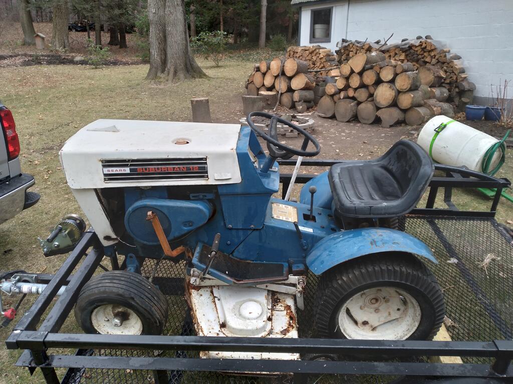

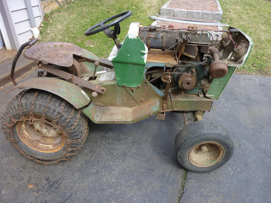

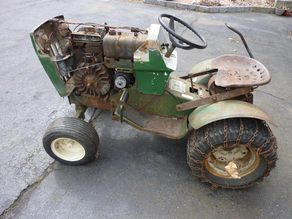

D_Mac 9,334 #9 Posted July 9, 2023 So several months ago I went to go look at this Sears. A good friend of mine went with me. He had been wanting to get an older garden tractor of his own but never had one. Turns out this Sears spoke to him and he really wanted it. So I passed on it so he could get it. We loaded it up and brought it to his house. Unfortunately he hasn't made much progress on it.pulled the carb and tank. Tank has holes he is looking for a new one. Going to rebuild the carb. Does have spark. He isn't going for a full restoration, just wants it running and driving to put it to work. Tractor sat for 20 yrs. Came with deck and blower. Share this post Link to post Share on other sites
