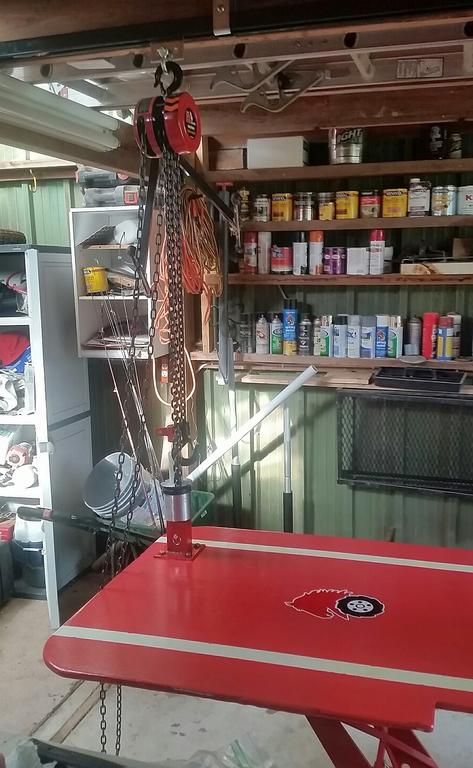

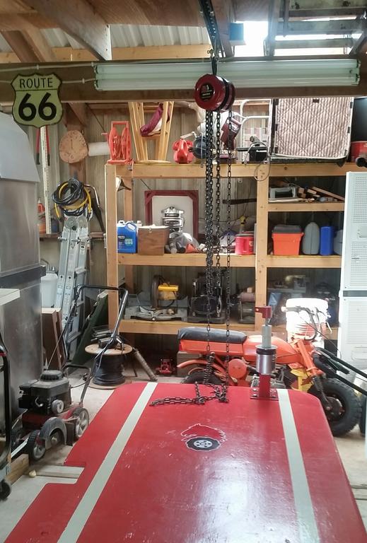

JoeM 10,317 #2 Posted October 27, 2017 After back surgery last November, I installed a 1000 lbs chain hoist to the rafters. I purchased a better brand from Grainger about $200. Now, I disconnect and raise the front of the tractor and roll out the deck. Lower the tractor, roll it back and raise the deck. Pricey, but I wish I have done this years ago. 5 Share this post Link to post Share on other sites

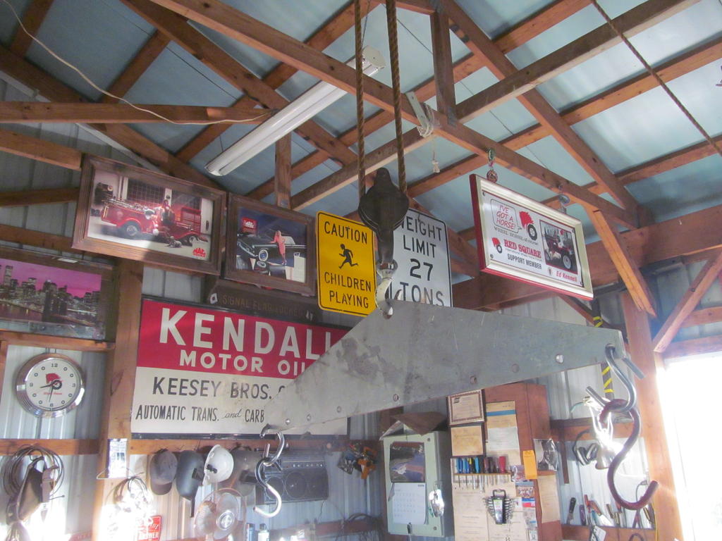

Ed Kennell 47,618 #5 Posted October 27, 2017 I use a 5/8" rope block and tackle to lift horses and deere to 0.27 ton (540lbs). 4 1 1 Share this post Link to post Share on other sites

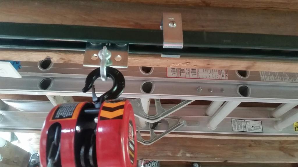

Texas Todd 1,026 #10 Posted October 30, 2017 (edited) Same idea as most, but I put my chain block on a 10 foot trolley. Back saver. When I build my new shop I will probably get an electric hoist. Edited October 30, 2017 by Texas Todd 3 1 Share this post Link to post Share on other sites
