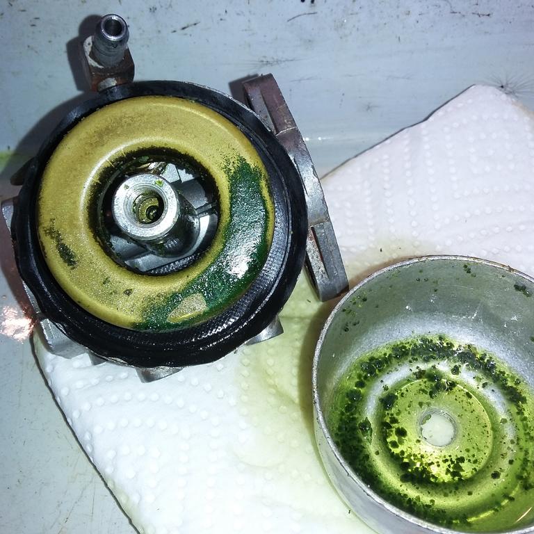

ebinmaine 81,146 #26 Posted October 26, 2017 22 hours ago, BOB ELLISON said: I tried to start my b80 and nothing. So I charged the battery and it turned over and over and over. So I put fresh gas with sea foam and no start. Checked spark and good spark. I decided to check fuel pump and got a good stream of gas. So I know now its In the carburetor. I shot some starting fluid it carb and it started up.I decided to pull carb and this is what I found. This is from only 5 months sitting. Now it has stabil and sea foam in the tank. This unleaded gas is bad news for sitting engines. Substances like that sitting in a bowl are the reason why I am not allowed to try to cook 2 Share this post Link to post Share on other sites

Molon_Labe 731 #30 Posted October 26, 2017 7 minutes ago, ebinmaine said: Me too... similar cold climate. I've been draining all small engines when not in seasonal use and getting them professionally tuned once a year . Ok so far.... But I did switch to pure gas this past summer. You will be amazed at the amount of maintenance the ethanol free gas will save you. 3 Share this post Link to post Share on other sites
