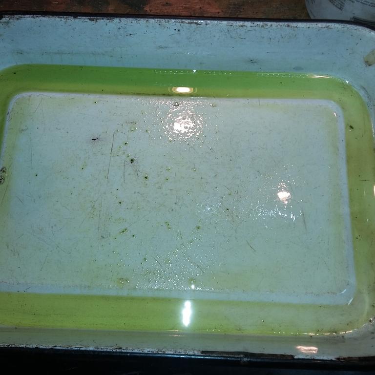

BOB ELLISON 2,983 #1 Posted October 25, 2017 I tried to start my b80 and nothing. So I charged the battery and it turned over and over and over. So I put fresh gas with sea foam and no start. Checked spark and good spark. I decided to check fuel pump and got a good stream of gas. So I know now its In the carburetor. I shot some starting fluid it carb and it started up.I decided to pull carb and this is what I found. This is from only 5 months sitting. Now it has stabil and sea foam in the tank. This unleaded gas is bad news for sitting engines. 2 6 Share this post Link to post Share on other sites

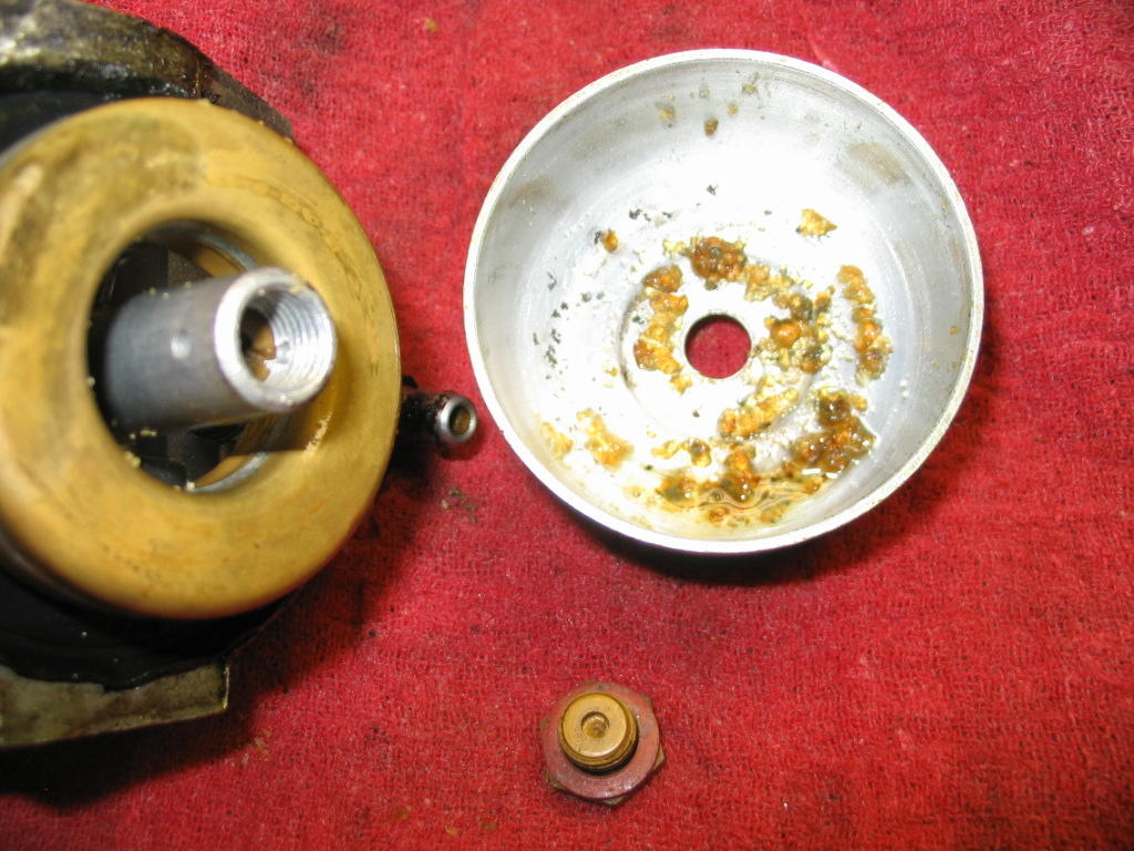

daveoman1966 3,884 #6 Posted October 25, 2017 I had the same problem...you'da thot someone planted corn in the carb bowl. I tried Stabil, but that only turned the green 'seeds' to brown. Ultimately I began using Seafoam and have not since had a problem. A better idea is to buy Ethanol Free gas, which I've also done. Even with that, I still use Seafoam cuz I like to 'over-kill' an issue. 6 2 1 Share this post Link to post Share on other sites

WHX?? 58,052 #9 Posted October 25, 2017 Don't know as I ever seen the green stuff Bob, wonder what caused it? Now Dave' pics yes plenty of times. I do try to empty the bowl if I am going to lay a tractor up for months by shutting off the pet cocktail and runt till is empties out plus choke it as it's starting to sputter. Don't know if that helps but figure it can't hurt. Sometimes I wish they hadn't done away with bowl drains. I'm also with Mike on the seafoam. Which surprises my self not being a believer of tune up in a can. 4 Share this post Link to post Share on other sites

BOB ELLISON 2,983 #15 Posted October 26, 2017 When I placed the carb in my work pan I removed the bolt that holds the bowl and all the gas was green. Mesa thinks it was from water in the bowl and as soon as the gas evaporated the water turned the flot green along with the gas when I opened the valve under the tank. It probably was just as Dave said. 2 Share this post Link to post Share on other sites
