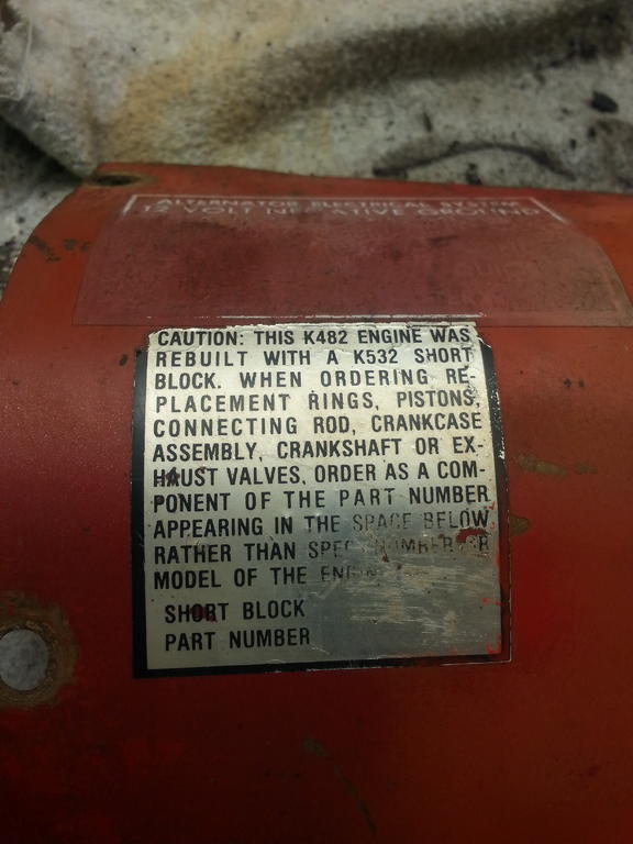

BMW1 44 #1 Posted October 22, 2017 I have a 1973 18 Automatic. While cleaning up the engine shroud, on the right side, sitting on the tractor, I noticed wet oil on the bottom of the cylinder head. Once I wipe the oil off, it stays dry until I run the engine for 5-10 minutes then it will be wet again and the next morning there will be a couple of drips of oil on the floor. I'm still new to this hobby and am thinking I need a new head gasket. I have not removed the head yet. I also noticed a tag on the engine shroud, see picture below. Has anyone else had this oil leak problem? If I order a new head gasket, do I look for a K482 or K532? Would it be a good idea to replace the gasket on the other head, even if it's not leaking? Thank You. Share this post Link to post Share on other sites
Sarge 3,471 #2 Posted October 22, 2017 Check around the valve cover gasket above that head - it may be leaking and getting blown down around the head/fins . Also , get up underneath and look for any signs of oil coming from the hydraulic pump - the engine flywheel fan can suck the oil into the engine's cooling fins when running . You basically have a K532 if the engine was rebuilt with that short block - the other external parts don't matter . Sarge 1 Share this post Link to post Share on other sites
