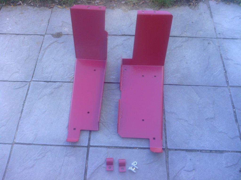

JimmyJam 542 #8 Posted October 22, 2017 Update: I found the second peg-style footrest. Now I have a pair. So, you are thinking of modifying to the later style of flat footrest? I have a restored pair for sale. Let me know. Here's a pic! 1 Share this post Link to post Share on other sites

JimmyJam 542 #11 Posted October 24, 2017 The footrests that I have pictured are from a 1976 B-80 that I am parting out. I probably have the cross support piece that ties the two footrests together under the seat pan, as well as the B-80 seat pan. I will send you all the measurements so you can make sure that style footrests will bolt up to your 657 with minimal fabrication. Share this post Link to post Share on other sites

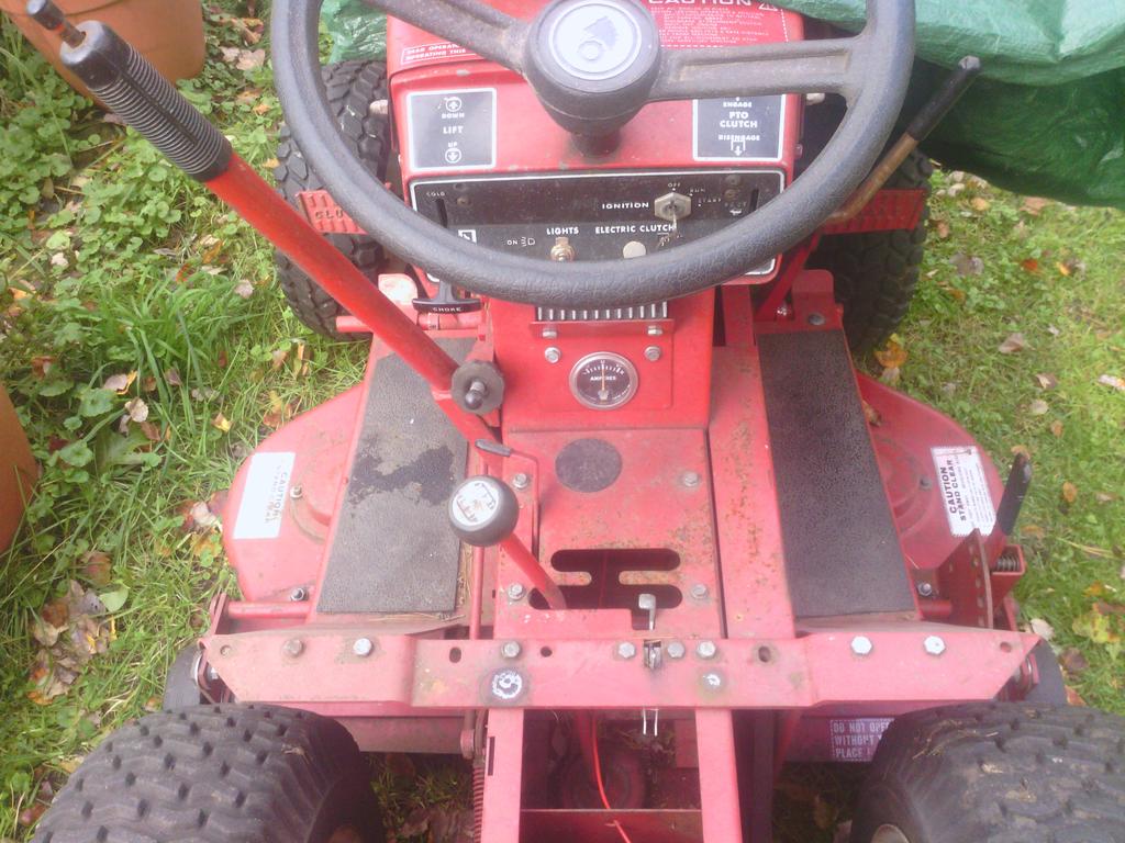

JimmyJam 542 #15 Posted November 2, 2017 PHO GUY Here are the measurements: Left-side (as you would be sitting on tractor) post must extend 7-1/2"; Right-side post must extend 5-1/2", From the dash tower 2 rear support bracket is 7-3/4", from the center off the front posts to rear support is 19-1/2". I have attached a pic of my 1974 B-80 setup if that helps. Let me know if that is something you can modify to work on your tractor. 1 Share this post Link to post Share on other sites
