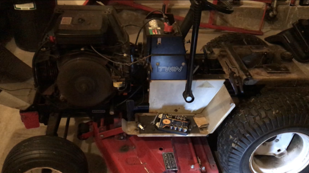

NateYarger 1 #1 Posted October 20, 2017 Hello, My GT1642 recently shut down after about an hour of mowing. I pulled it into my shop and started to diagnose the problem. First, I noticed that I am getting no spark using a spark plug tester. So I then went to check the flywheel and twin magneto. The outer part of the flywheel was a little rusty so I lightly sanded it and tried to clean the outer part of the magneto. I was able to get spark after doing this and it fired up. However, today I’m having the same issue, no spark. Two questions: 1.) Does anyone have a part number for the twin magneto. I am going to try to replace it. My GT1642 has a 16hp Briggs engine. 2.) Doe anyone have any addition troubleshooting ideas that I should look into besides changing the twin magneto. Cheers, Nate Share this post Link to post Share on other sites
chip61 666 #2 Posted October 20, 2017 chafed wire grounding intermittently?? 1 Share this post Link to post Share on other sites

aHorseofCourse 261 #4 Posted October 22, 2017 Sounds like the magnito is bad. The magnetos on these Opposed Briggs don't have a long life span and seem to quit once they get hot when they get old. Check the wires first but after that I'd get a new mag, should be around $30 on the bay. Share this post Link to post Share on other sites
NateYarger 1 #5 Posted October 22, 2017 Thank you all. I purchased a new magneto. Should arrive this week. I’ll keep ya posted. Thanks. nate Share this post Link to post Share on other sites
