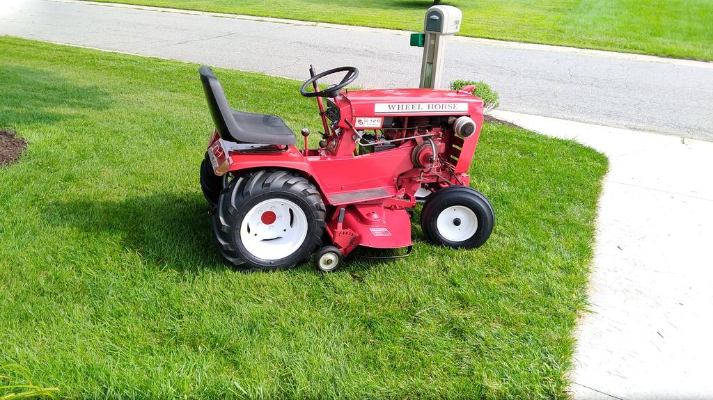

oneroadkingman 53 #76 Posted August 16, 2018 What was the $ damage for the 4 tires? And do the steer any better than the turf style? Share this post Link to post Share on other sites
AlexR 3,065 #77 Posted August 16, 2018 9 minutes ago, oneroadkingman said: What was the $ damage for the 4 tires? And do the steer any better than the turf style? Not bad less then $180 for all four of them, tires-easy.com is where I got mine. Them seem to I haven't had much of a chance to test them out I need to mow to really test them 1 Share this post Link to post Share on other sites

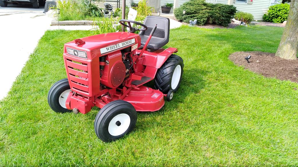

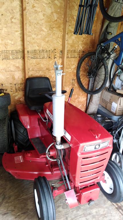

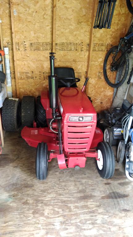

AlexR 3,065 #84 Posted August 18, 2018 It dried up enough today to get to mow and man its nice the front tires do help its not like a huge difference but there is. Besides its awesome to look down at your front tires and just see tri ribs. And then I washed the tractor when I was done mowing as it was a little dirty. I got some more trans oil and I will change it out again because on the dipstick it's still a little foamy and why not? The other thing is I saw some stacks at TSC and there are flappers as well all for a reasonable price I will have to check the sizing exactly but it looks like it will be the right size. 1 4 Share this post Link to post Share on other sites
oneroadkingman 53 #85 Posted August 19, 2018 You're right it is a pretty decent price for all 4 tires. and stacks do look cool if you get the right size.. 1 Share this post Link to post Share on other sites
AlexR 3,065 #86 Posted August 19, 2018 46 minutes ago, oneroadkingman said: You're right it is a pretty decent price for all 4 tires. and stacks do look cool if you get the right size.. Yeah I want a shorter stack kinda want the old tractor look so I don't know that I will even try to get any chrome on it especially since I want a flapper on it and those don't mix Share this post Link to post Share on other sites

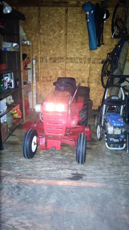

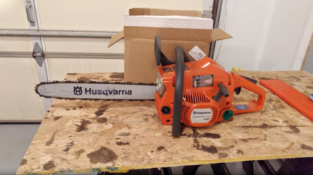

AlexR 3,065 #87 Posted August 20, 2018 Cleaned up the shed so I can actually have a decent space in there for the tractor. And got the diff oil replaced so put the old girl in the stable and out of the garage. On a side note I picked up this Husqvarna 142 for 90 bucks saw on FB marketplace in a nearby town so jumped on it. It was the ladies ex-husbands and she thought he had used it a few times but the tank has never had any gas in it ever.. And the bar has never touched wood. So I was the first one to start it up. 1 1 Share this post Link to post Share on other sites

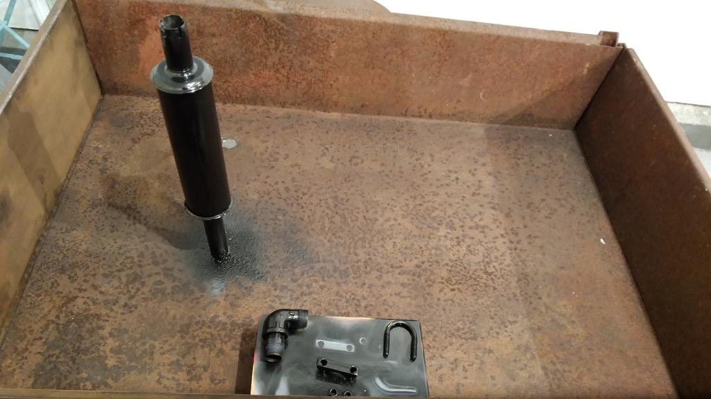

AlexR 3,065 #88 Posted August 26, 2018 New stack! got it painted up in high heat black so gotta wait a little while to cure before I can get it fully on. 2 1 Share this post Link to post Share on other sites
ebinmaine 79,630 #89 Posted August 26, 2018 I do like me a well stacked tractor ! 1 1 1 Share this post Link to post Share on other sites
AlexR 3,065 #90 Posted August 26, 2018 Black stack done!! Not sure what else I can do? 1 Share this post Link to post Share on other sites

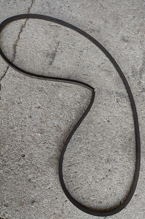

AlexR 3,065 #91 Posted May 4, 2023 Well I haven't really done a lot to the old girl in a while but while using the bottom plow the belt has been slipping, also in 3rd gear I bought non Toro belt and regretted it. Bought a 7473 belt off eBay and fit perfectly and now no slipping and can actually pull a wheelie in 3rd 3 Share this post Link to post Share on other sites

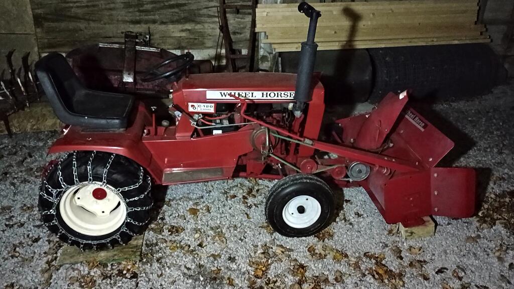

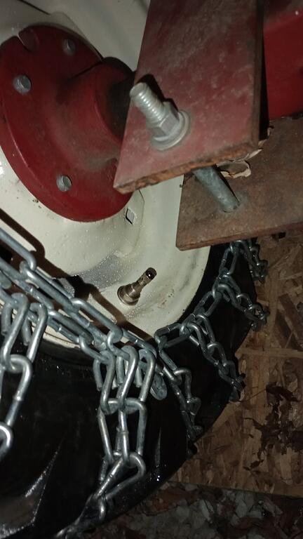

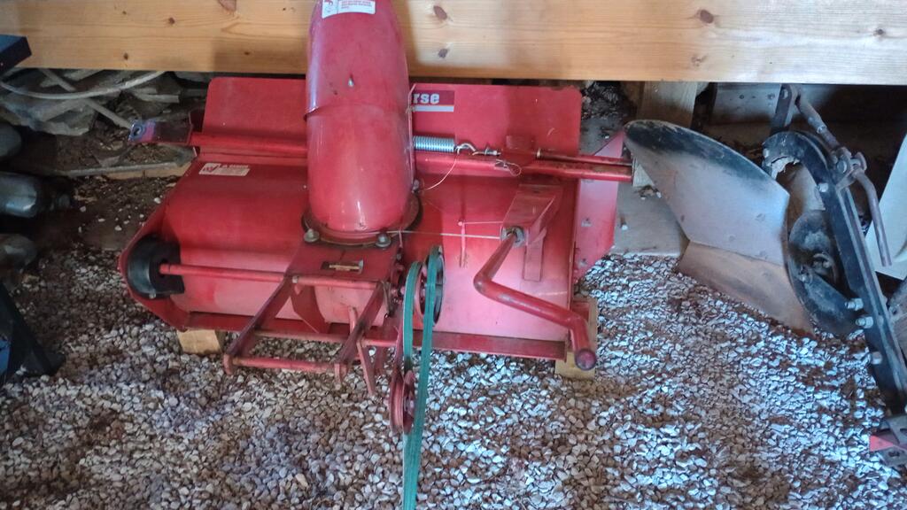

AlexR 3,065 #92 Posted November 19, 2024 (edited) Latest update is getting the rear rims repainted with the cottage white and filled with RV antifreeze and chains for winter and the new to me snowblower. The way I ended up filling them, was by breaking the bead by the valve stem, and dumping the fluid in. Which I think is the way to go if you aren't using inner-tubes. (Very fast and requires no extra stuff to get it done) I did get metal valve stems, to prevent what apparently can be common with the rubber valve stems falling apart. Not sure if I will get to paint the front rims yet this year, I'm thinking that probably will not happen until spring. Edited November 19, 2024 by AlexR 3 Share this post Link to post Share on other sites

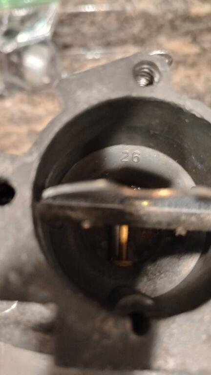

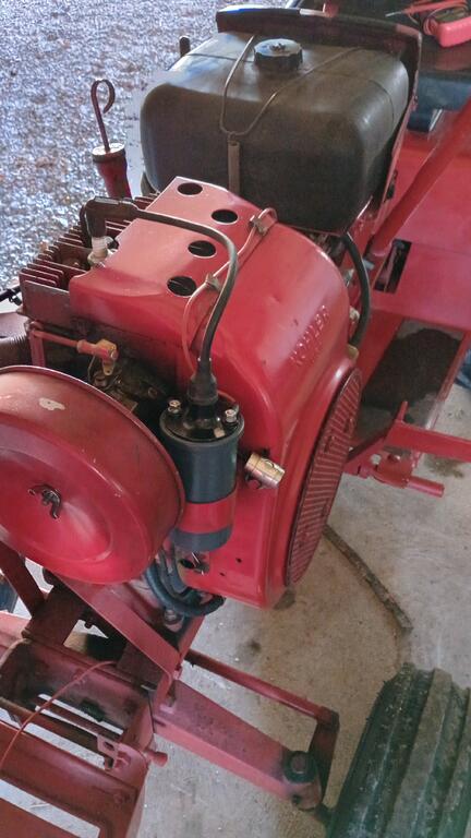

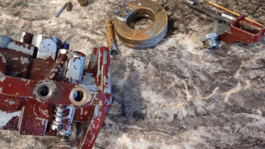

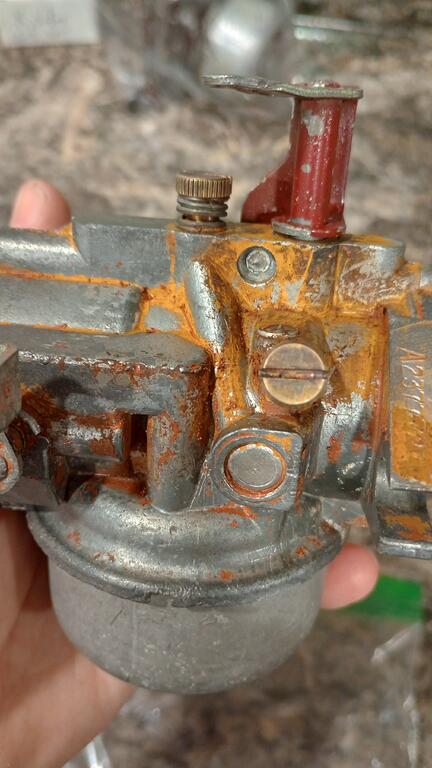

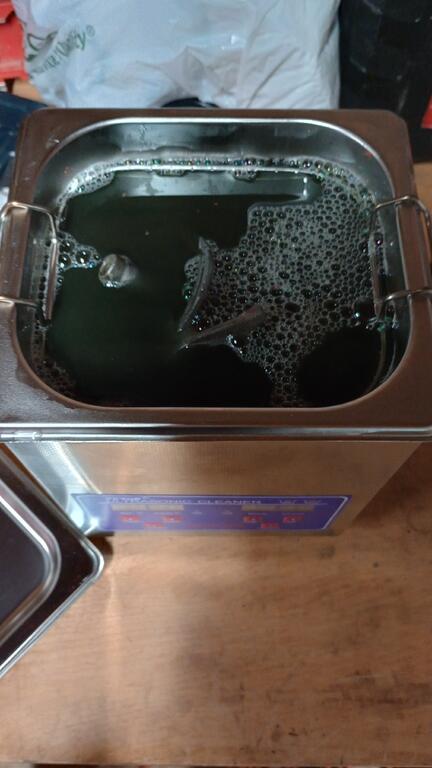

AlexR 3,065 #93 Posted March 10, 2025 Got back to work on this tractor. Getting it ready for a plow day Got the snowblower off. Started working on the original carb the jungle carb does work just not as well as I would like. Soaked the carb in the ultrasonic cleaner I got the brass bushing for the throttle shaft fix The throttle shaft has a broken screw in it. Didn't want to deal with drilling and tapping right now I don't have the bit or tap. So got the carb out of the project tractor the Raider 14 which should have had a #28 carb but surprise it did not it, has a #26 carb which after it went through the ultrasonic cleaner the red paint came off to reveal yellow so probably came from a cub 12hp so pulled the throttle shaft out and I will use that on the other carb. This is the yellow this carb also had the idle screw break and the bowl has a pin hole in it so it's a parts carb for now unless I feel like drilling and tapping a bunch haha 3 Share this post Link to post Share on other sites
ebinmaine 79,630 #94 Posted March 10, 2025 Those #26 carbs are common enough that you're just as well off keeping it as a parts carb. The main needle is worth it. Folks tend to bend those. The Raider 14 would likely benefit from a #30. Later 14 HP Kohlers had them. If you want to send that throttle shaft up I'll get the screw out. 2 Share this post Link to post Share on other sites
AlexR 3,065 #95 Posted March 10, 2025 1 hour ago, ebinmaine said: Those #26 carbs are common enough that you're just as well off keeping it as a parts carb. The main needle is worth it. Folks tend to bend those. The Raider 14 would likely benefit from a #30. Later 14 HP Kohlers had them. If you want to send that throttle shaft up I'll get the screw out. Yeah the 14hp should have had the more rare #28 carb as it's the older one with the smaller exhaust valve. Thanks for the offer, but the screw is out, the threads are a little messed up. It just needs drilled and tapped to 4-40 size. Since I pulled the throttle shaft out of the yellow carb, I just ordered stainless screws and lock washers for that one. Especially since I need to get a different carb for the Raider 14 it will end up a parts carb. 1 Share this post Link to post Share on other sites

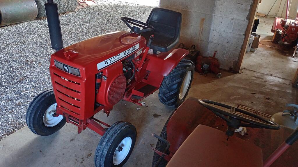

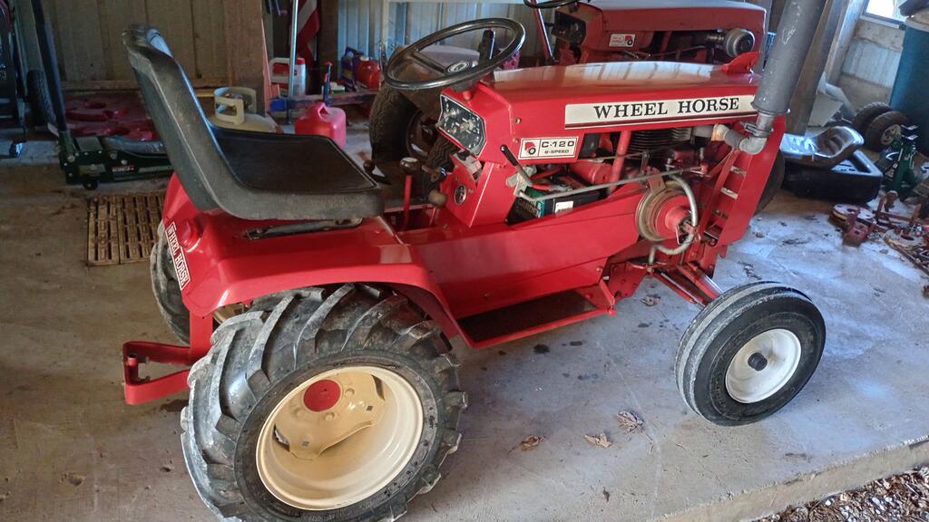

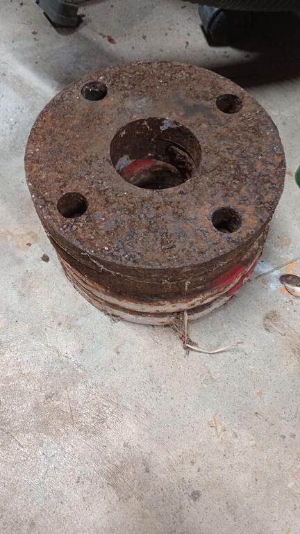

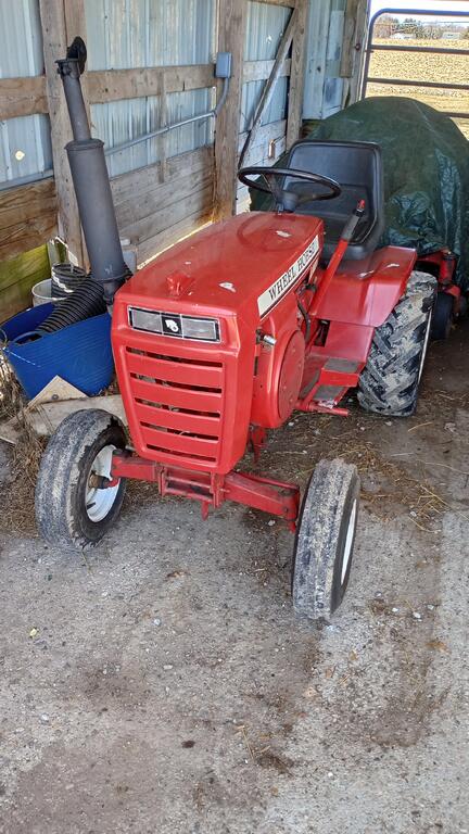

AlexR 3,065 #99 Posted March 10, 2025 After getting the fruit tree's pruned today, it was like 65° today I got the Wheelhorse washed And got the oil changed, changed the coil and swapped out the sparkplug wire to a non-automotive wire (doesn't have resistance) I haven't got them cleaned up yet, but I am going to get these front wheel weights painted and mounted. 3 1 Share this post Link to post Share on other sites
ebinmaine 79,630 #100 Posted March 10, 2025 38 minutes ago, AlexR said: but I am going to get these front wheel weights painted and mounted. Them're neat. 1 Share this post Link to post Share on other sites
