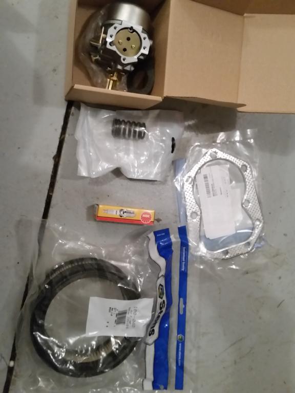

AlexR 3,099 #52 Posted November 4, 2017 (edited) Got parts! I installed the new valve spring and checked the clearance again still good. And then installed the headgasket, went with minimum torque which was 25 ft-lbs I was going to switch the whole throttle shaft over, so I would have a ball for the throttle. But I broke a screw when putting the plate back on the shaft. So I pounded out the ball from the old shaft drilled out the new shaft hole a little bit and hammered it back in. (Not quite that simple but I was able to do it) I drained the oil, and sprayed a can of carb cleaner through the bottom of the engine. Tomorrow I am going to pour some oil through the bottom of the engine to clean it up a little bit. And add oil, and then see if she fires up. Edited November 4, 2017 by AlexC120 Share this post Link to post Share on other sites

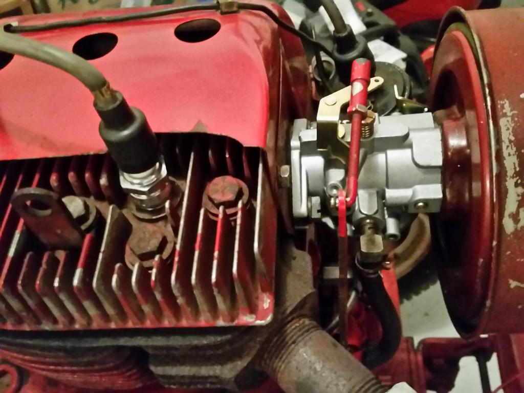

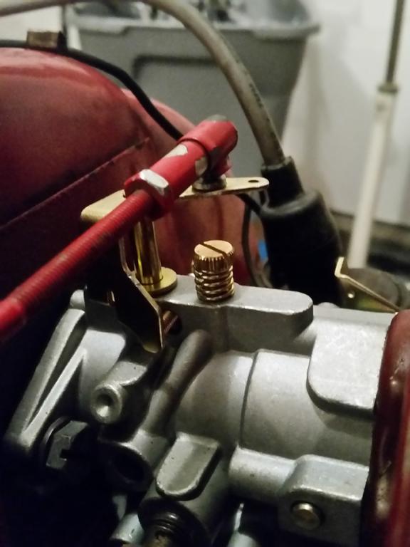

gwest_ca-(File Mod) 12,483 #54 Posted November 4, 2017 Your spark plug wire may not be connected to the plug. Looks like the boot is pushed down the wire. Garry Share this post Link to post Share on other sites
AlexR 3,099 #55 Posted November 5, 2017 58 minutes ago, gwest_ca said: Your spark plug wire may not be connected to the plug. Looks like the boot is pushed down the wire. Garry It is connected, I don't like the wire though, pretty crappy haha. I am going to try to find one with a 90 degree elbow for the spark plug sometime but for now it works Share this post Link to post Share on other sites

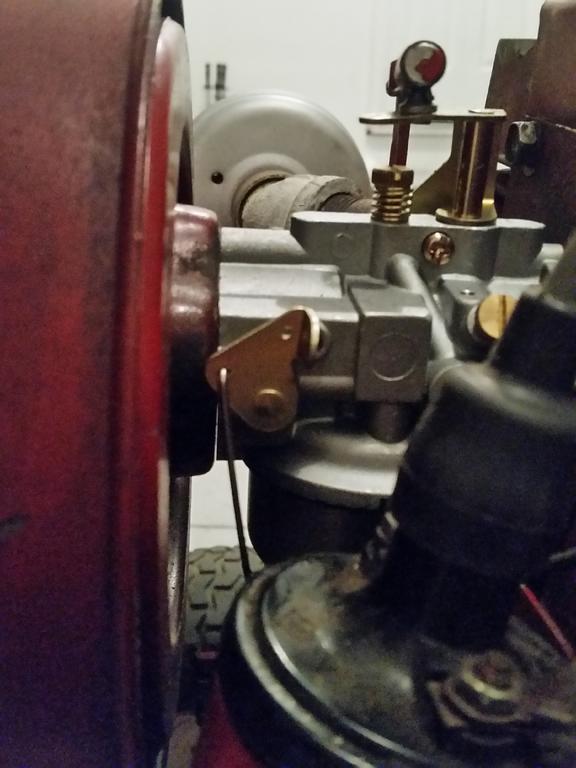

c-series don 12,420 #56 Posted November 5, 2017 Were you able to connect the choke cable and have it work correctly? I just bought one of those aftermarket carbs and the little plate that you hook the cable to was 180 degrees out of position. I had to cut the tab off and now it's up for choke off, down for on. This would normally drive me crazy but I only use this particular tractor a couple days a year and I'm the only one who does. I only paid 23 bucks on amazon for a brand new carb so I guess I'll live with it. Were you able to connect the choke cable and have it work correctly? I just bought one of those aftermarket carbs and the little plate that you hook the cable to was 180 degrees out of position. I had to cut the tab off and now it's up for choke off, down for on. This would normally drive me crazy but I only use this particular tractor a couple days a year and I'm the only one who does. I only paid 23 bucks on amazon for a brand new carb so I guess I'll live with it. Were you able to connect the choke cable and have it work correctly? I just bought one of those aftermarket carbs and the little plate that you hook the cable to was 180 degrees out of position. I had to cut the tab off and now it's up for choke off, down for on. This would normally drive me crazy but I only use this particular tractor a couple days a year and I'm the only one who does. I only paid 23 bucks on amazon for a brand new carb so I guess I'll live with it. Hmm, I guess I was a little impatient with the submit reply button!! Oops 😬 Share this post Link to post Share on other sites
AlexR 3,099 #57 Posted November 5, 2017 (edited) 4 hours ago, c-series don said: Were you able to connect the choke cable and have it work correctly? I just bought one of those aftermarket carbs and the little plate that you hook the cable to was 180 degrees out of position. I had to cut the tab off and now it's up for choke off, down for on. This would normally drive me crazy but I only use this particular tractor a couple days a year and I'm the only one who does. I only paid 23 bucks on amazon for a brand new carb so I guess I'll live with it. Yes it was correct and worked fine. This is the carb I bought Amazon carb On the photo it shows it flipped the wrong way but mine was correct. Edited November 5, 2017 by AlexC120 1 Share this post Link to post Share on other sites

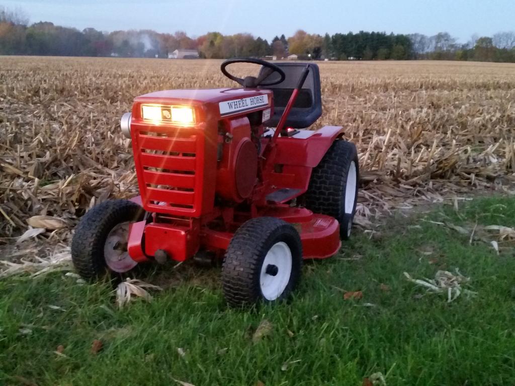

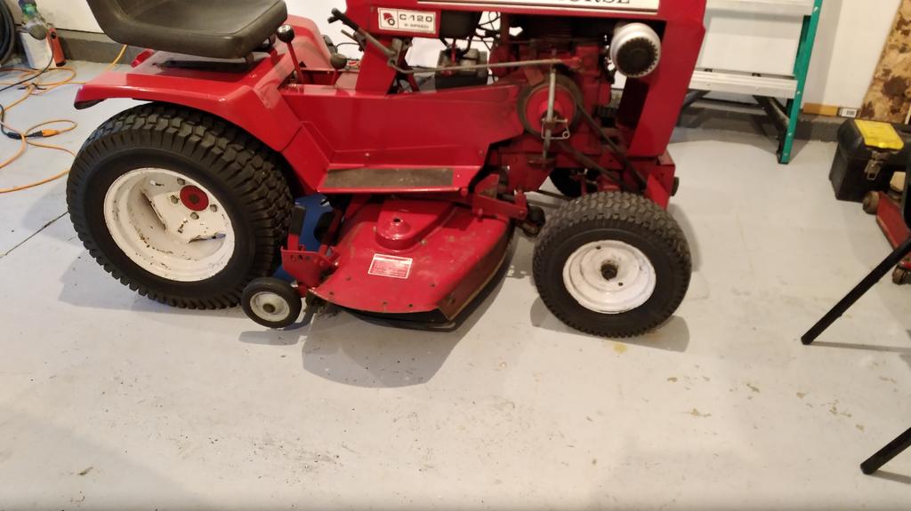

AlexR 3,099 #59 Posted November 6, 2017 Did some mowing today it runs really good other then that sputtering. 2 1 Share this post Link to post Share on other sites

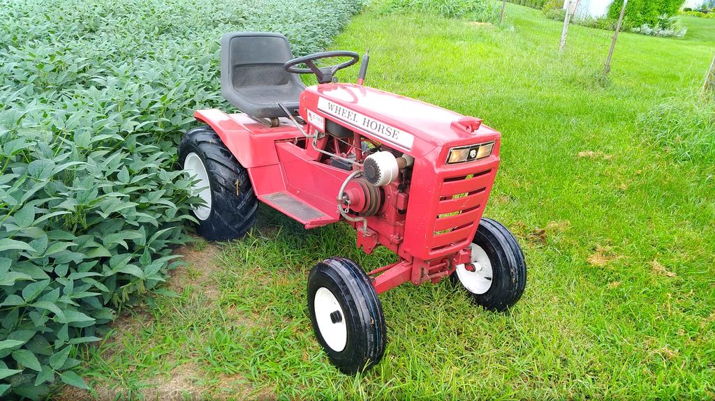

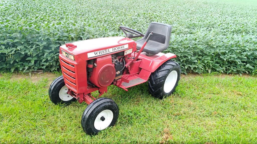

AlexR 3,099 #61 Posted August 5, 2018 Tractor runs pretty smooth now been mowing with it and it does great. Got some time yesterday and today to paint the rims. And a while back I also replaced the trans oil which it needed shifts smoother now. 2 3 Share this post Link to post Share on other sites

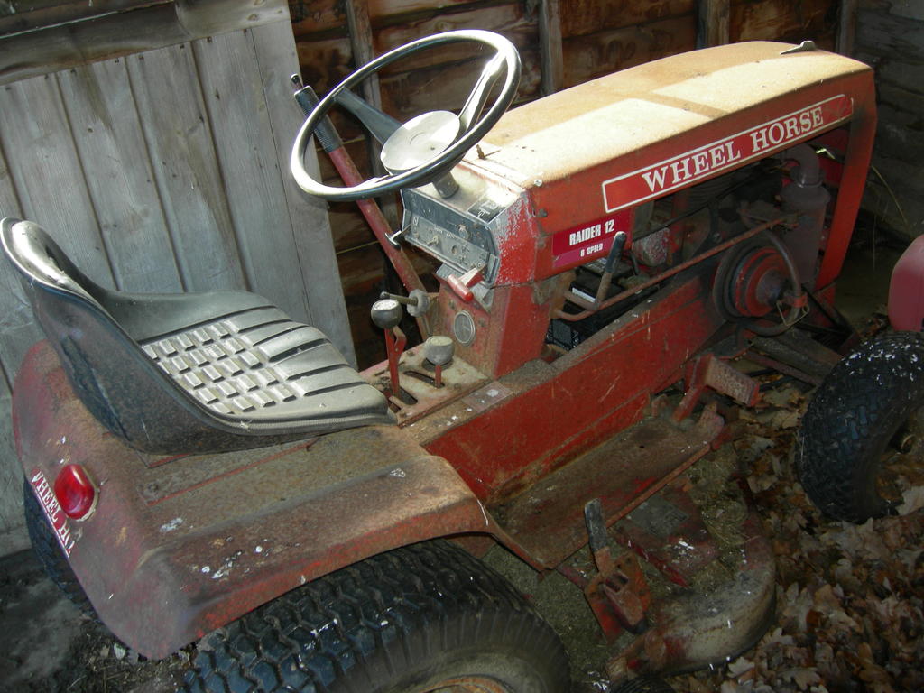

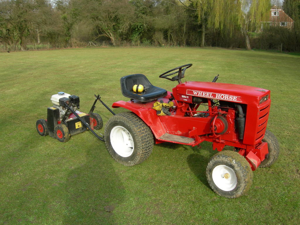

Keith of kent 47 #62 Posted August 7, 2018 You say i the gearshift is smoother now. I'm sure you wouldn't do this, but you're not shifting gears with it moving, are you? Re the sputtering, have you replaced the condenser? Nice looking WH, mines a 73 C120 Raider 12. it's a worker so not as pretty as yours, here's a couple of pics, the first as it was when I bought it in 2008 for £100 (about $130). The other one is as it looks now and towing a scarifier (backwards) around my yard. It worked but because it was only 12" wide it took forever. I have since got a Westwood scarifier for my Westwood tractor 1 1 Share this post Link to post Share on other sites
AlexR 3,099 #63 Posted August 8, 2018 On 8/7/2018 at 3:53 AM, Keith of kent said: You say i the gearshift is smoother now. I'm sure you wouldn't do this, but you're not shifting gears with it moving, are you? Re the sputtering, have you replaced the condenser? Nice looking WH, mines a 73 C120 Raider 12. it's a worker so not as pretty as yours, here's a couple of pics, the first as it was when I bought it in 2008 for £100 (about $130). The other one is as it looks now and towing a scarifier (backwards) around my yard. It worked but because it was only 12" wide it took forever. I have since got a Westwood scarifier for my Westwood tractor No I don't shift on the fly but it just goes into the gears smoother. It doesn't stick I guess is the word for it. No I actually didn't I got the tunes all right and put the old spark plug back on.. That new NGK didn't work I was having trouble starting it all that put the old spark plug back in and started right up. Share this post Link to post Share on other sites

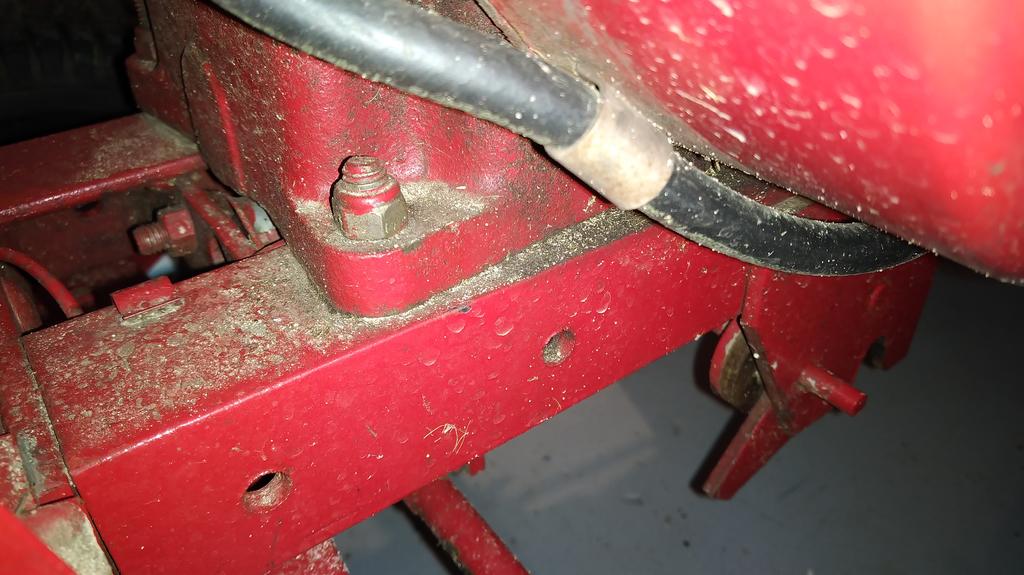

MarkS 122 #65 Posted August 11, 2018 Can someone verify for me how the engine mounts on a c-120. Im used to my C-125 where it has the plate and blocks it mounts on. On my C-120, when I sit the engine in the frame, it only lines up with holes on one side. Share this post Link to post Share on other sites
Ed Kennell 47,235 #66 Posted August 11, 2018 The two bolts on the right side are inside the frame rail. The engine base is tapped for these two bolts. Share this post Link to post Share on other sites

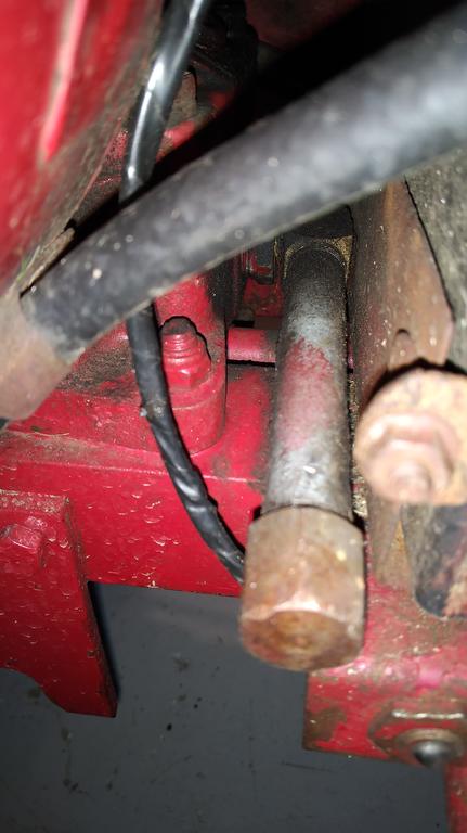

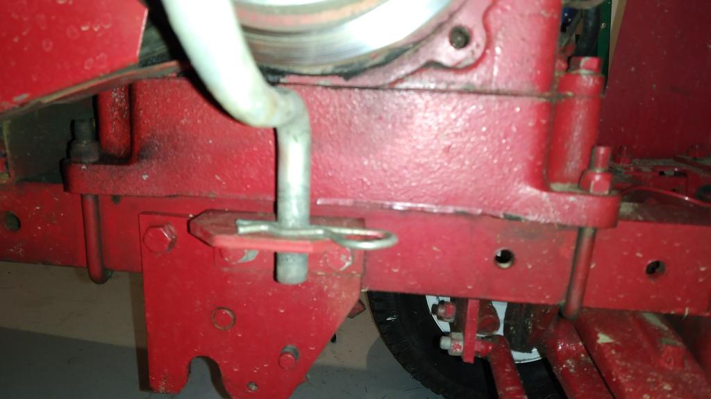

AlexR 3,099 #67 Posted August 11, 2018 I can't say for sure how yours should bolt up as mine technically isn't a C120 it's a 73 no name but this is how mine mounts Share this post Link to post Share on other sites

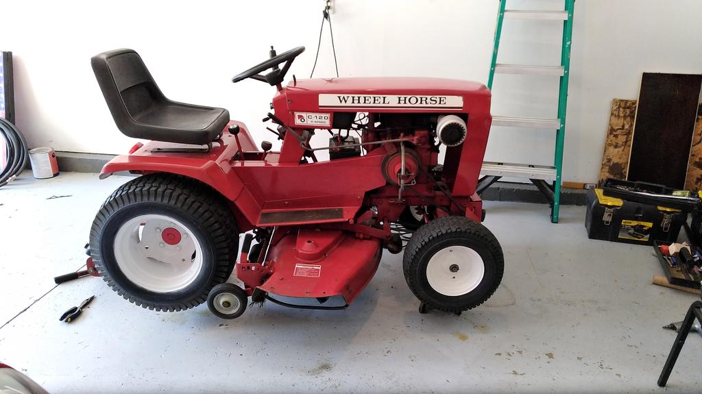

AlexR 3,099 #75 Posted August 16, 2018 (edited) New Tires are on!!! Love the new look. I will need to take one of the front tires off sometime during removal or installation I must have punctured the intertube so I will need to patch that. Edited August 16, 2018 by AlexC120 1 3 Share this post Link to post Share on other sites
