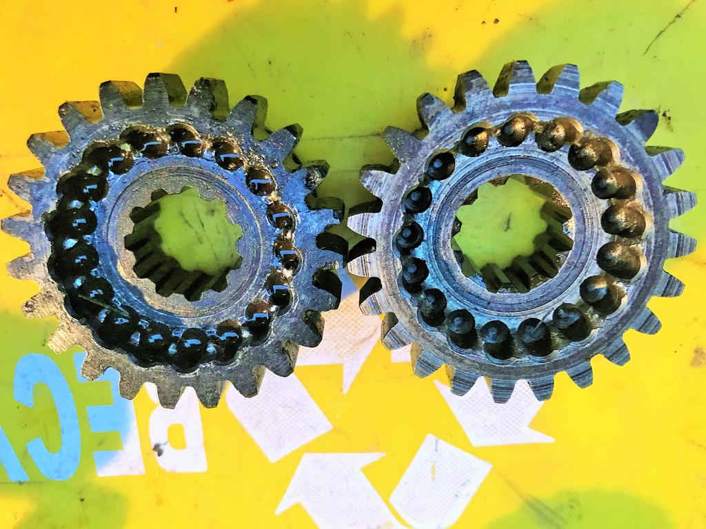

Lane Ranger 11,389 #1 Posted October 17, 2017 Here is a photo I took this afternoon of a Bad Third Gear and an Old but better/good one! 4 2 Share this post Link to post Share on other sites

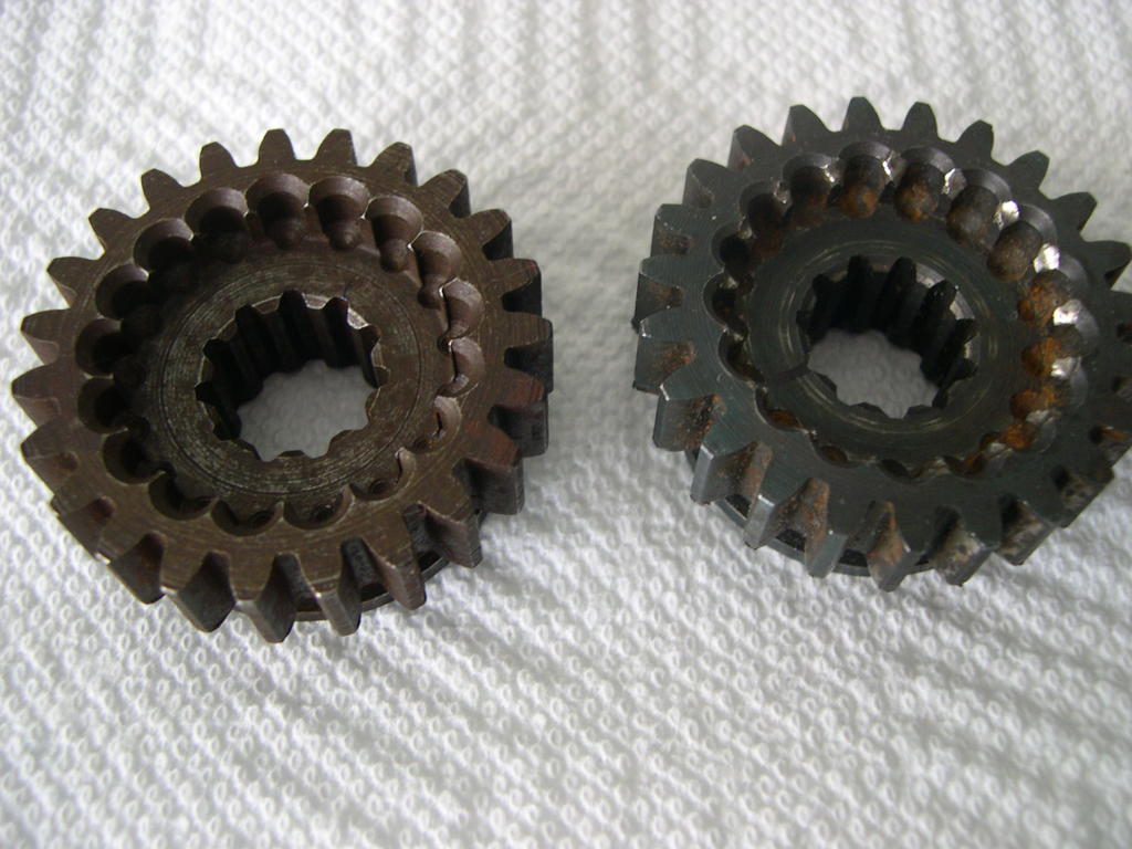

Racinbob 11,916 #5 Posted October 17, 2017 Here's another shot of them. The left one is a NOS gear I got on Ebay well before Lowell was offering them. It's now in my Suburban. It's pretty clear why this is a weak spot in these transmissions. 1 Share this post Link to post Share on other sites
Lane Ranger 11,389 #6 Posted October 17, 2017 Even makes my teeth hurt Bob! The older worn but good ones are steps away from slipping ! The years take their toll on my teeth as well! I guess there is good reason for machinists and dentists! 3 Share this post Link to post Share on other sites

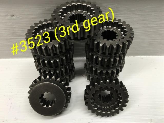

stevasaurus 23,274 #12 Posted October 17, 2017 As long as we got back into this 3rd/2nd gear thingy again. I think we should mention "5003 and 5010 Service Notes" paragraph #3 for everybody that would order or buy the 3523 gear. Transmissions before Serial # 11628...the spline shaft and the 2 fork gears have 10 involute splines. On transmissions after Serial # 11628 the spline shaft and 2 fork gears have 11 involute splines. It should be noted that these parts have the same part number...ie...3rd/2nd gear in both styles is part # 3523 and so on. If you count the teeth on Lane's, RacinBob's and Lowells gears...they are all the 11 tooth style. Make sure you count the teeth in your gears. Lane does have some of the 10 tooth style, if he would like to add some pictures. 2 4 Share this post Link to post Share on other sites

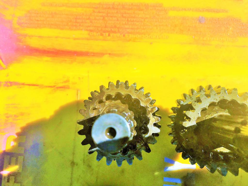

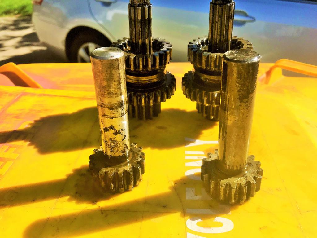

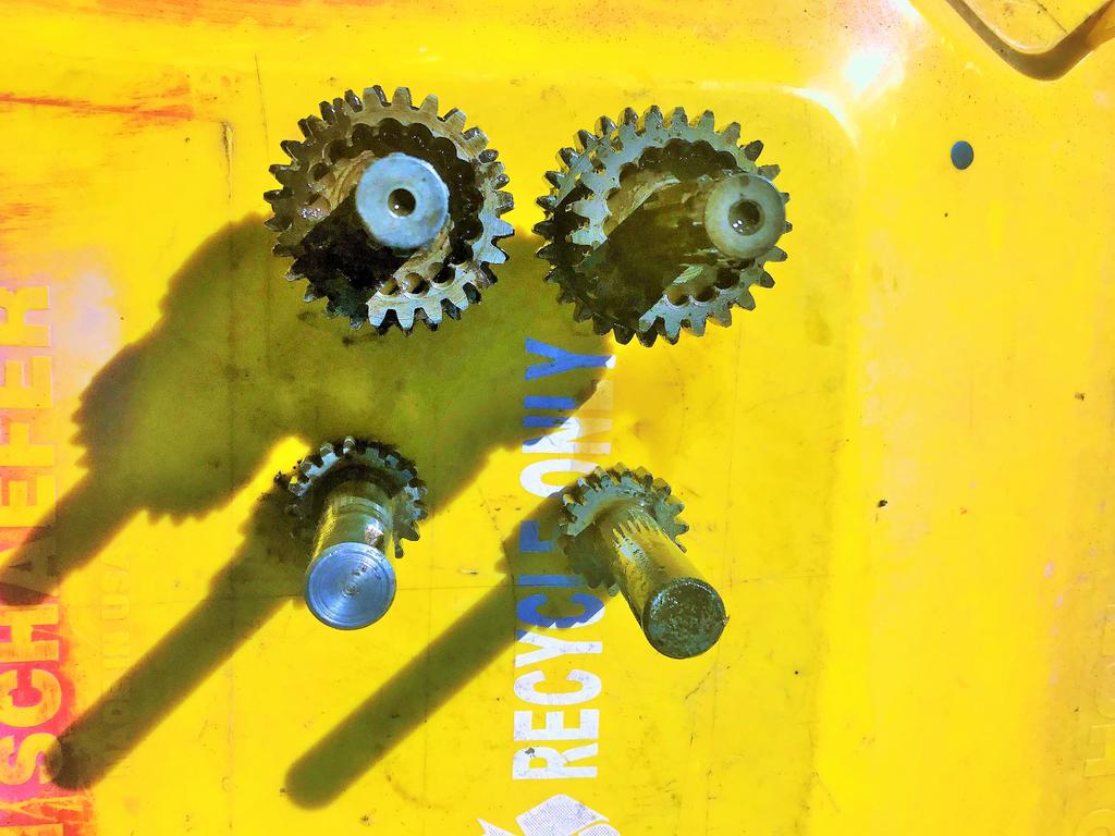

Lane Ranger 11,389 #13 Posted October 17, 2017 **** Steve mentioned some mof the splined gears for the shifters are 11 teeth and some are 10. I have three sets. two are 11 tooth and one is 10. The Input /drive shaft gear will ride smoothly in the third/second gear for either the 11 or the 10 tooth spline gear set. Not the greatest pics here but just did fast a few minutes ago. In first photo the one on right has 11 teeth and the and one on the left has ten. Both of the lower imput/drive shaft gears will interchange! 4 Share this post Link to post Share on other sites
