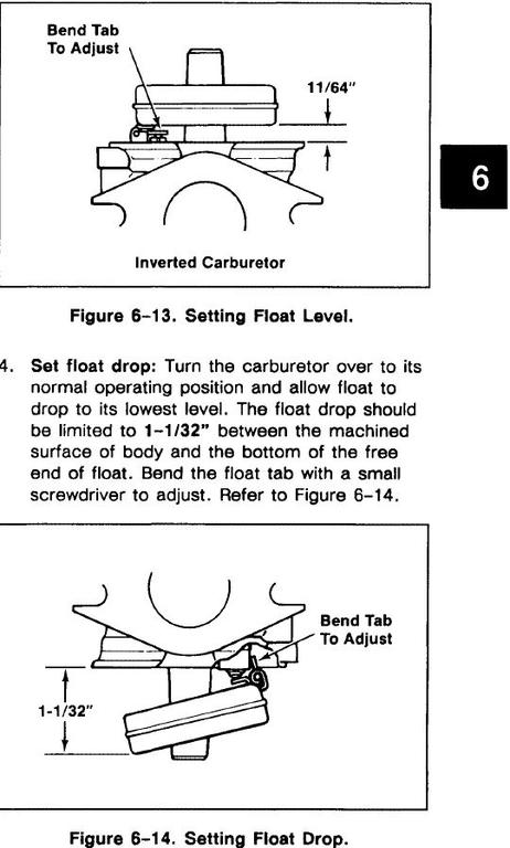

TravelinJavelin 621 #5 Posted October 17, 2017 well 4 of those suggestions i can rule out fuel filter bowl has been cleaned, fuel pump works very good, brand new fuel line, fresh 93 octane fuel.....now i had my friend go through it and has done a pile of them but his eyes are messing with him as of recent and i noticed when the float was hanging down well at the way i thought ought not to hang but i could be wrong but i didn't say anything.....does anyone have a pic how that is to hang so maybe i can adjust it ? 1 Share this post Link to post Share on other sites
pfrederi 21,299 #6 Posted October 17, 2017 Download the Kohler Service manual here. There are two measurements for the float. 3 Share this post Link to post Share on other sites
