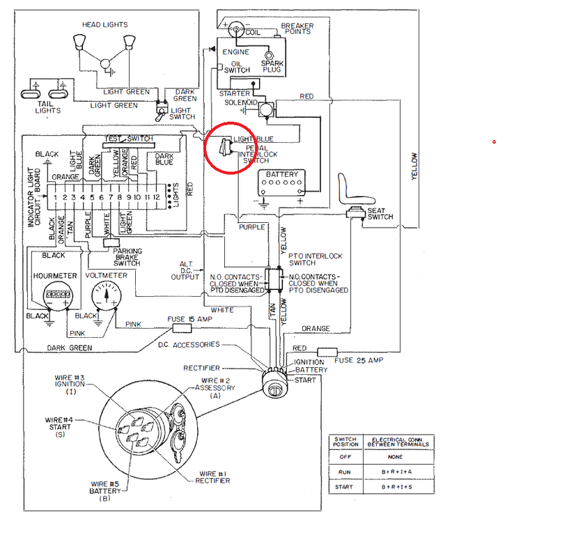

rmaynard 17,409 #2 Posted October 15, 2017 Sounds like a safety switch. I'm not familiar with the 417-A, but if there is a safety interlock switch on the pedal, it may be slow to close, causing the start circuit to be OPEN, and the Clutch Pedal light to flash. 2 Share this post Link to post Share on other sites

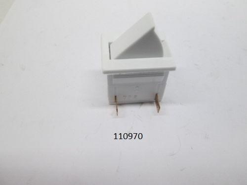

gwest_ca-(File Mod) 12,323 #3 Posted October 15, 2017 Should be 2 of these switches on the tractor. One to detect when the tractor/transmission is in neutral position and the other will guess for the parking brake. Perhaps you can switch them to isolate the problem. Garry Share this post Link to post Share on other sites
