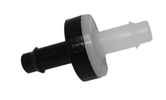

rmaynard 16,372 #9 Posted October 15, 2017 Invest in a couple 1/4" check valves. They go inline between the tank and the pump. 1 Share this post Link to post Share on other sites

nylyon-(Admin) 8,002 #17 Posted October 20, 2017 So after posting the topic, I hadn't used the 414-8. Since I am getting ready for snow (while it's warm out for a change) today's task is the plow on the 414-8. When I parked it on Sunday, I shut off the fuel petcock. This morning I went out, opened the petcock and it fired up like it sat for only a minute. I like the idea of the electric fuel pump, but think that I will buy a bunch of one-way valves and put them on all the machines. So the next question is where is the best place to install? Closer to the tank (lowest spot), just before the fuel pump or between pump and carb? 2 1 Share this post Link to post Share on other sites

JimmyJam 542 #19 Posted October 20, 2017 21 minutes ago, nylyon said: I like the idea of the electric fuel pump, but think that I will buy a bunch of one-way valves and put them on all the machines. So the next question is where is the best place to install? Closer to the tank (lowest spot), just before the fuel pump or between pump and carb? I recommend just before fuel pump. I think if you place it closest to the tank, that would be the lowest spot, and gravity will make the gas naturally flow to to that point, you may be defeating the use of the check valve. Just my 20 minutes ago, Ed Kennell said: I just placed an order. Two pumps for $16.25 +$1.00 shipping and a lifetime warranty from Richard. Ed let us know how they work out for you. Curious on where you run the wires to, obvious the ignition, I think ??? Share this post Link to post Share on other sites

Racinbob 11,989 #23 Posted October 27, 2017 On 10/20/2017 at 11:55 AM, Racinbob said: Yes, it made a difference but I think a couple things kept it from working better. I have a Command engine and the fuel pump is on the back of the engine. On level ground the pump is at a height basically like it's sitting on top of the tank. When I backed it up the ramps it barely put the tank higher than the pump. Add to the fact that the tank wasn't full and I believe that gravity helped but didn't totally solve the issue. I have a couple of the electric pumps and have been pondering them. Just yesterday I installed a check valve (the metal style) in the line so we'll see what that does. The verdict is in. It's been 8 days since I installed the check valve. Plenty of time to force me to crank it several seconds to get the fuel back to the pump. This time I don't think the engine made a complete revolution before it was running. Most of the fuel line is hidden so I picked a spot that was easy to get to. I don't really think it's critical where it goes, just between the tank and pump. Mine happens to be just in front of the steering tower where the line comes out from underneath. 4 1 Share this post Link to post Share on other sites
